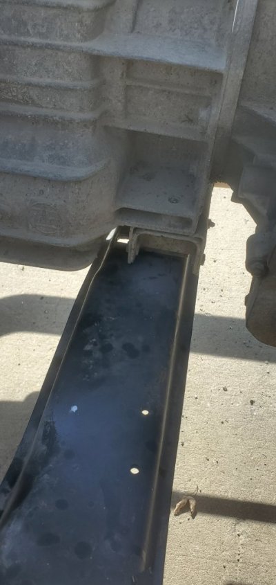

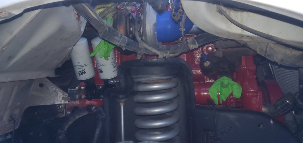

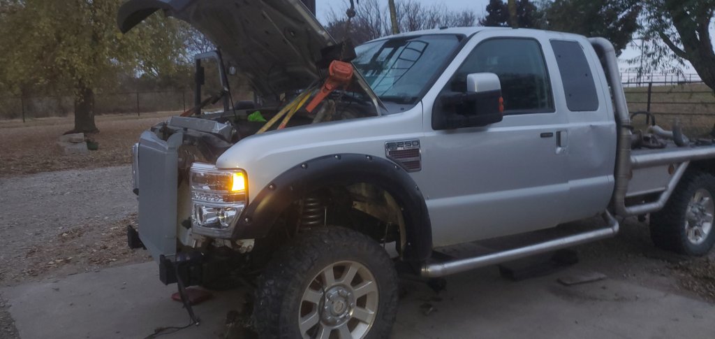

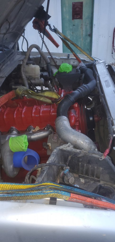

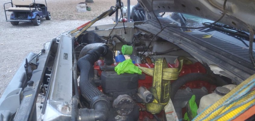

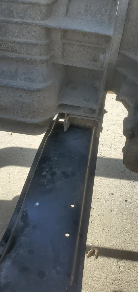

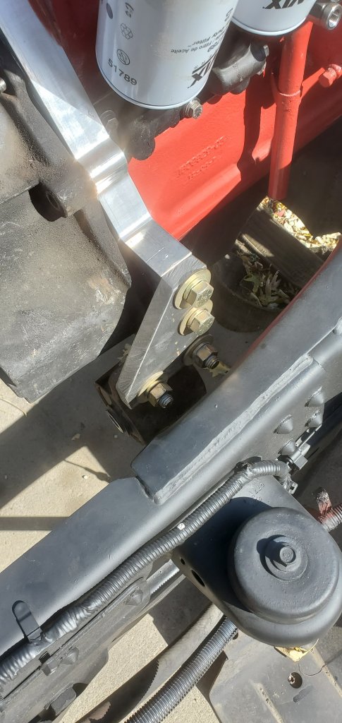

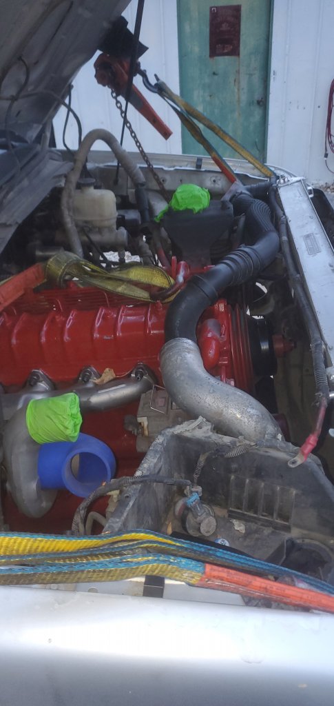

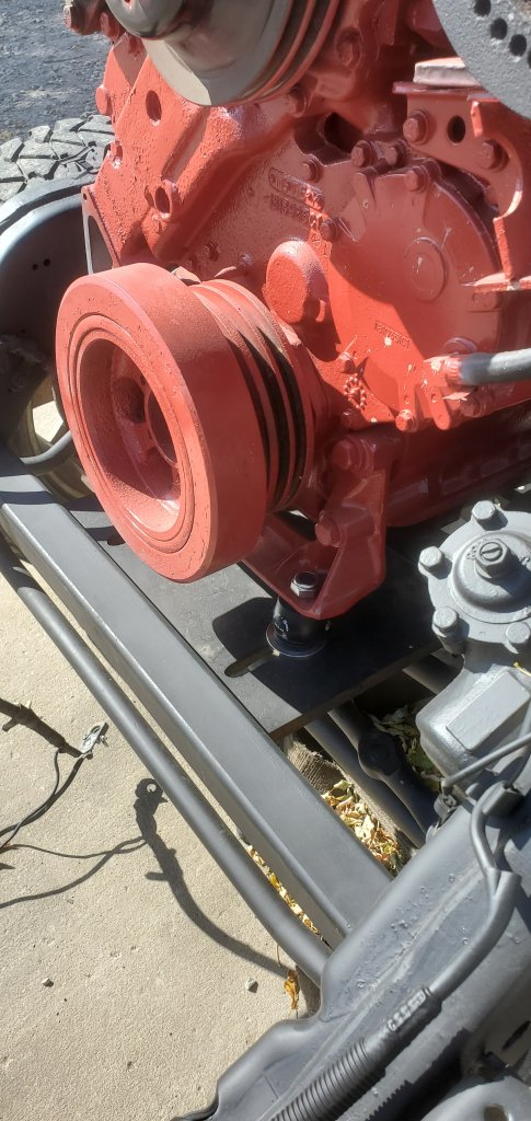

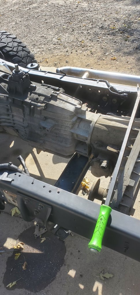

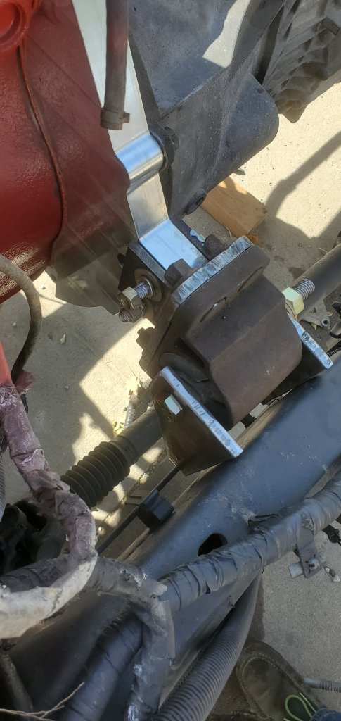

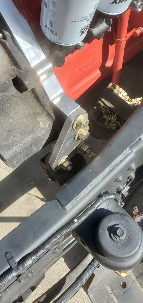

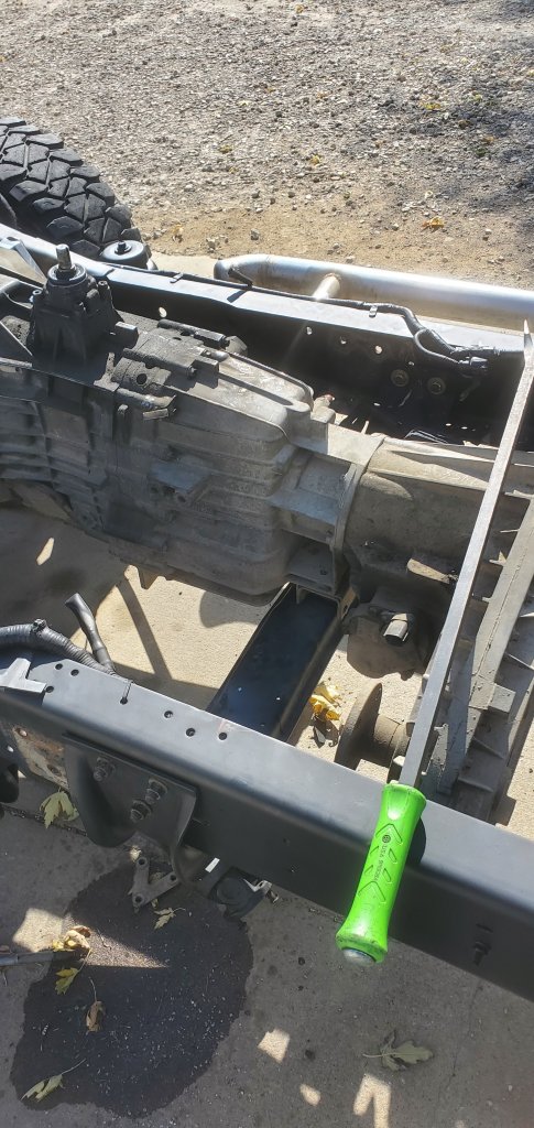

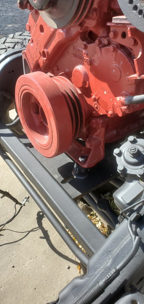

Rear mounts done and Trans support. Recycled the 6.4 engine mounts for the rear, think it turned out nice. I slotted the trans support toward the front 2.5 inches. I am on borderline of too far back. This allows me to slide forward until all is well and then weld rear mounts to frame.
I guess I'm ready to put cab on and see how fitment is. I am really glad I took the time to lower the engine core support and thankful that I had a 3" suspension lift already.

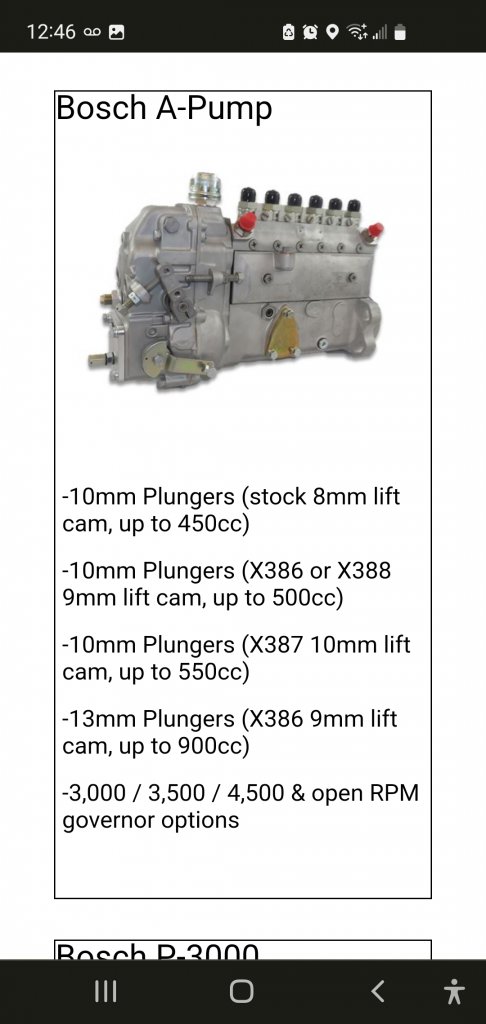

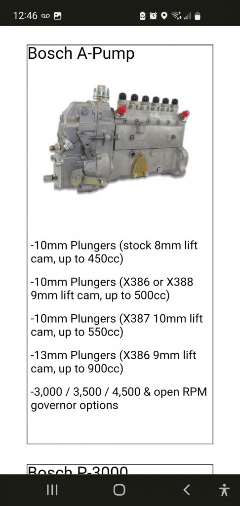

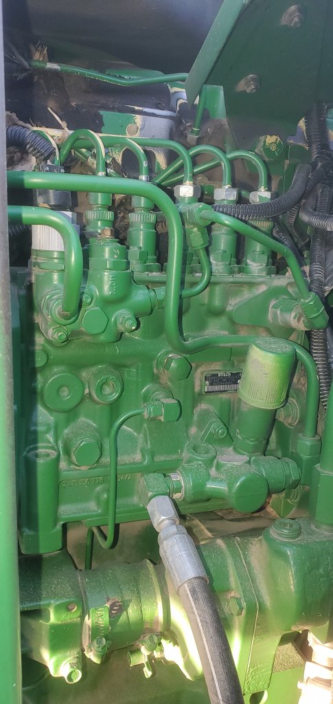

I found a place from a suggestion above that can give me a modded A-Pump with up to 450ccs. I like the a pump for a couple reasons. It will be better for low end fueling and not be a smoking pig. The gentler ramp rate of cam should be better for low rpm driving and towing. I would potentially have fueling for up to 700hp granted timing and air are in line. I have settled on the S360 .88 and S472 1.10 with the smaller turbine. This should give me good response, low rpm boost and good cool egts.
Later in life I could always swap to a big p-pump, S366/S475 and play. I don't anticipate a second mid-life crisis at this point. I want a nice running low if any smoke work truck without codes and drama.

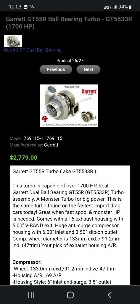

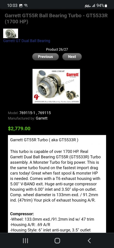

So worst case is I switch out the 360 and run the 472. Then what atmosphere? GT55R
Just gotta be compounds. Just cause.
lincolnlocker
27,928
180
Central Michigan
I completely understand. Need it for spooling and top end. Smallest you can go for spooling but gate the *** out of it.
Probably go gt42 for a single. Little bigger than a 38r.

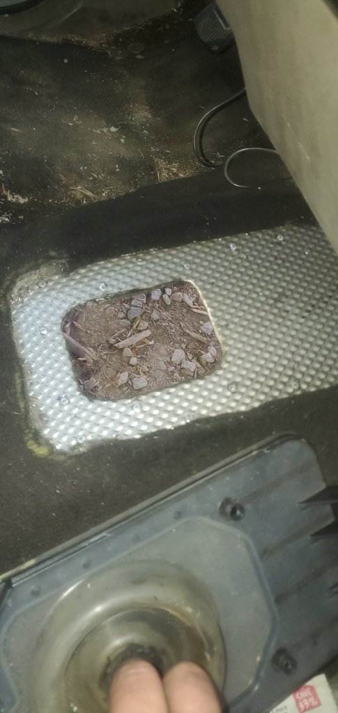

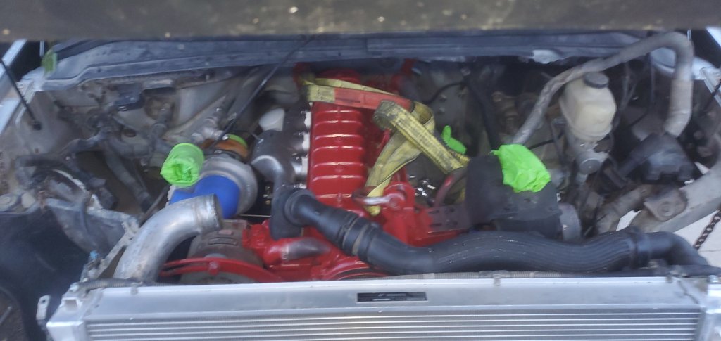

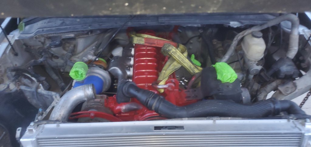

Making progress. Going to add 1.5" cab lift. Sucks it has to come off again, I am not going to install flywheel under there.

Nice progress!! How are you feeling about the build so far?
It was mentioned earlier in the thread that the DT360 head flows better than the 6BT head. How much difference is there?
a_moore
355
35
Blowing in the wind
Overwhelmed. Ready to hear it run. I have wanted to do this for years. Actually bought this truck just for this project. Guy thought motor was blown, got 100k miles out of it and two free years as a bonus.
I have no numbers. Only from researching. I understand that the valves and ports are much bigger and that there is an advantage in the intake plenum.
I have also read that the 24v has more similar flow to the 360. 360 has substantially more flow than the 12v 5.9.

Today's list of remaining items.
Cut shifter hole back, install boot.
Cut battery box ac support for hot side.
Tighten compressor housing, final.
Change adapter plate bolts.
Jack up and weld rear mounts to frame.
Cut and mitre hot side pipe, easy.
Fab cold side pipe.
Brake lines master to ABS mod.
Weld res for power steering.
Have line made for power steering.
Shorten rear drive shaft.
Lengthen front drive shaft.
Heater core lines.
Lower radiator line finish adapter.
Upper radiator line support used factory.
New belts.
Pulley bolts for water pump.
Patch hole In firewall.
Make 1.5" cab mount lift blocks.
Install air filter.
Turbo drain hose and clamps too short.
Wiring harness bullshit for sensors.
Check timing, set to 20°
Increase fuel at rack.
Turn star wheel.
Order 4 electric fans.
Fab radiator shroud for fans.
Wire in fans and controllers.
As you can see, it's a lot of stuff.

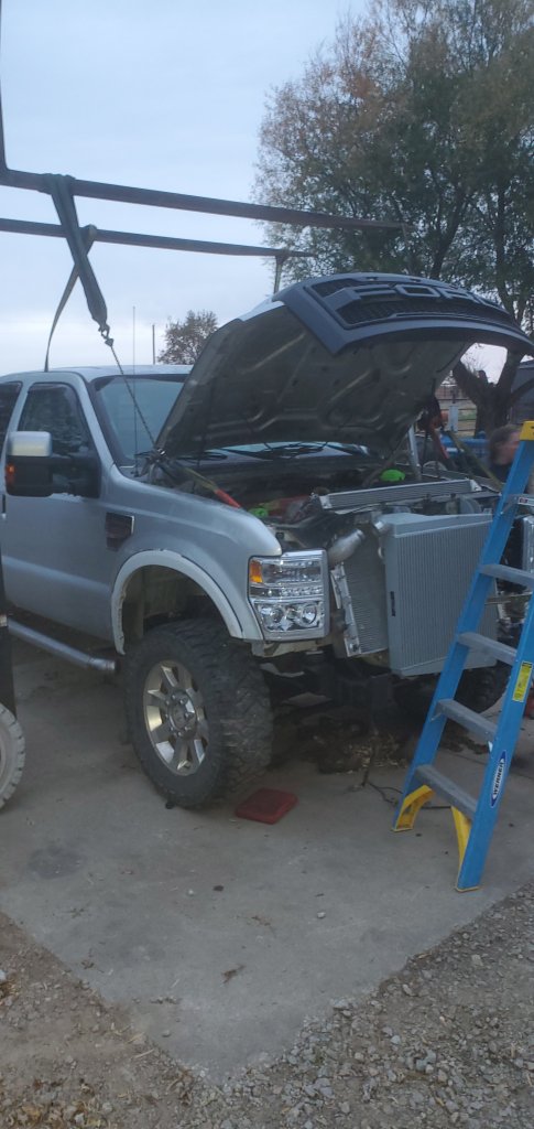

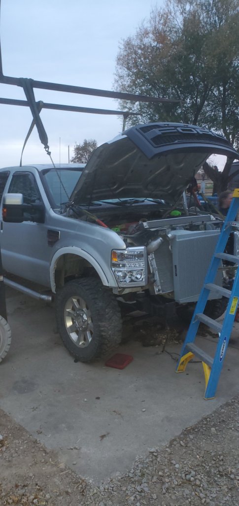

Got correct flywheel 1700. All installed by 1900. Ready to drop engine/Trans in morning and hook all this stuff up. With some luck will run tomorrow evening.
Drive shafts will be done Friday. Should be driving it this weekend.

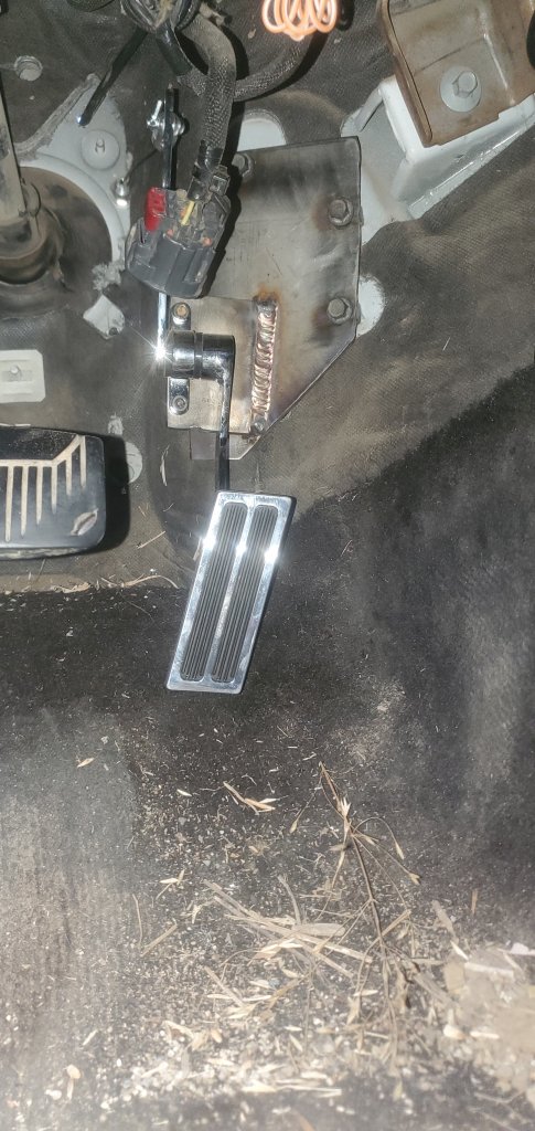

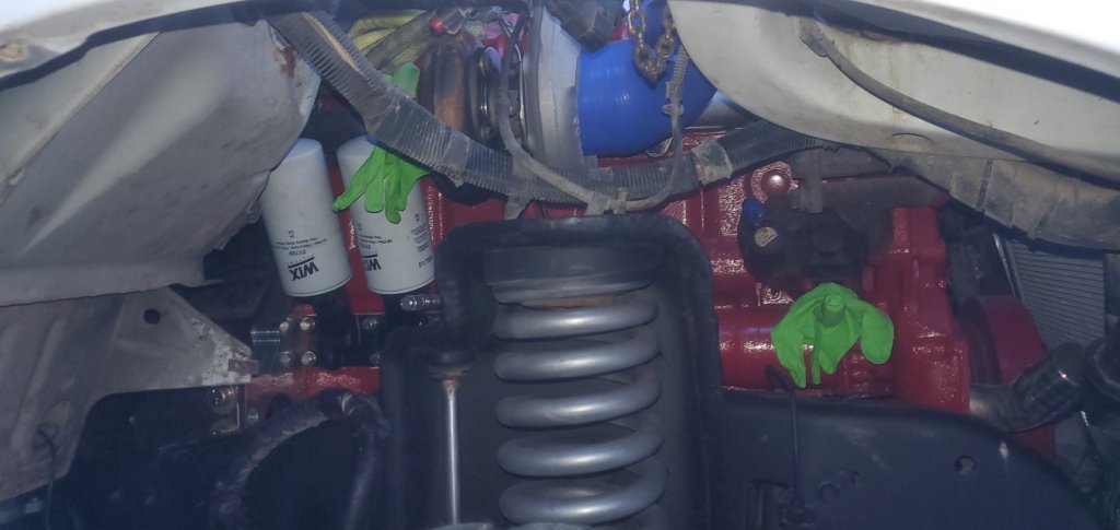

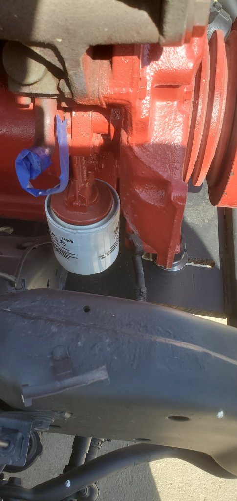

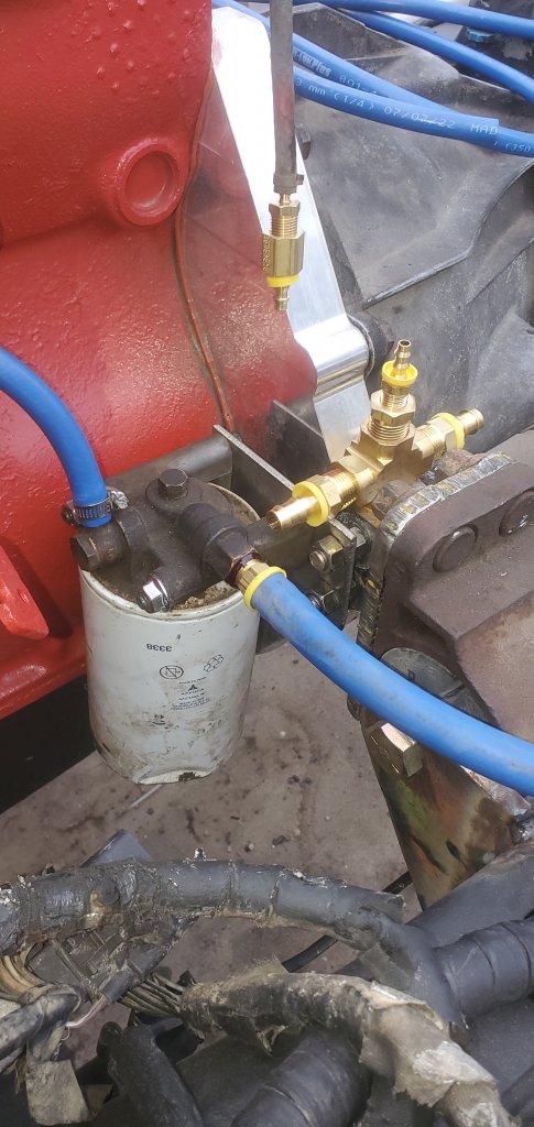

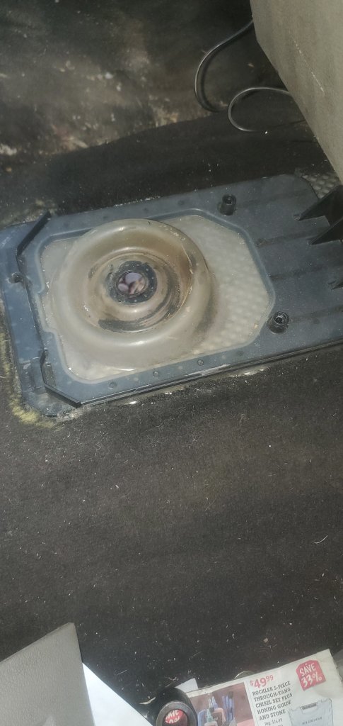

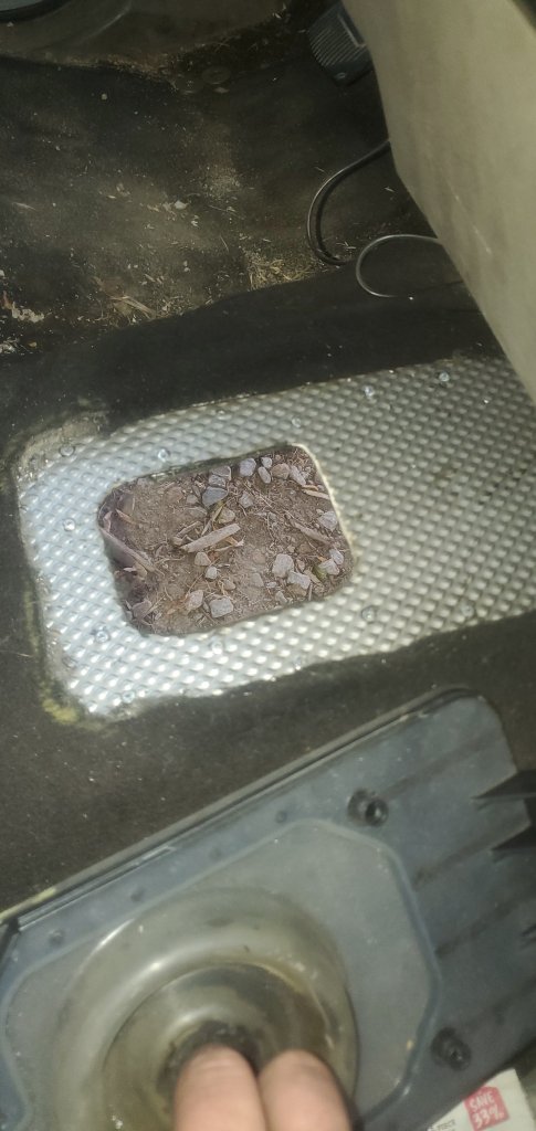

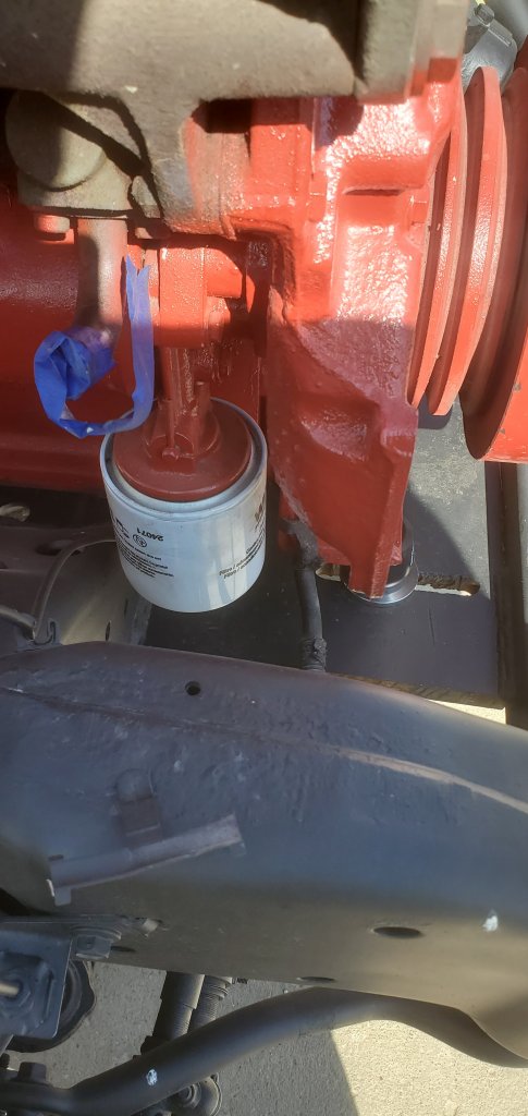

Fuel lines all hooked up. Starter connected. Engine grounded. New belts and fuel filter. Fabled a bracket to hold the fuel filter assy.
Fabled bracket for gas pedal using factory bolts.
Relocated shifter hole. Moved center console back 4".
Have a pressure guage on oil system. Ready to fire up.
