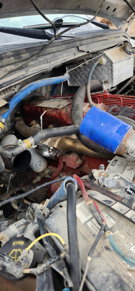

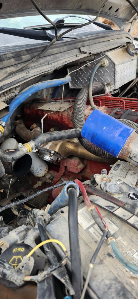

Installing a 6.0 vgt charger. Not happy with the S360 response. Mocking up with a stock turbo, then install the KC stage 1.
Only programming away for the vgt.
