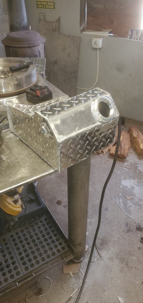

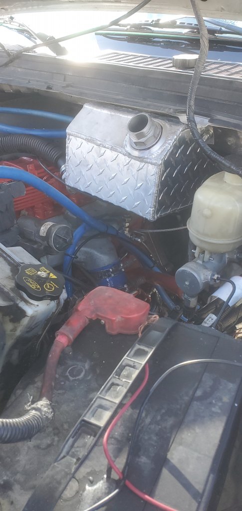

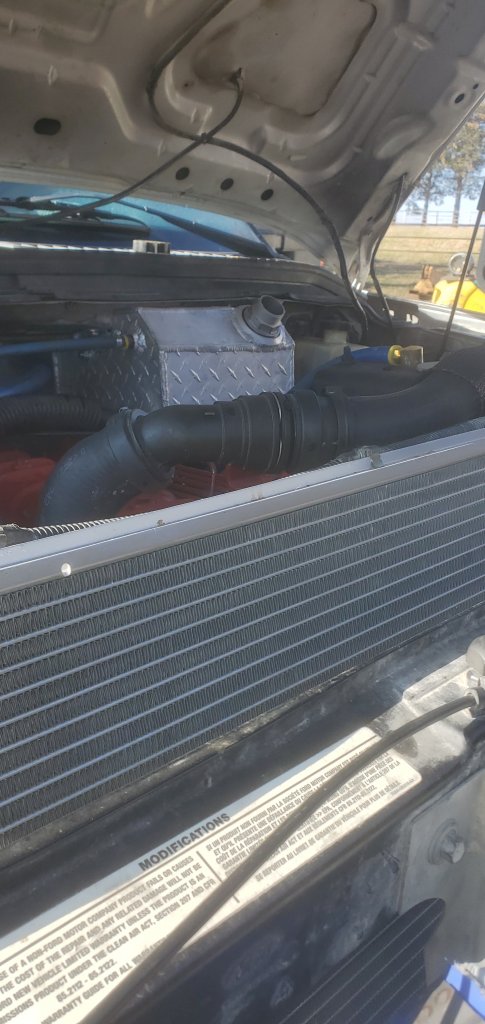

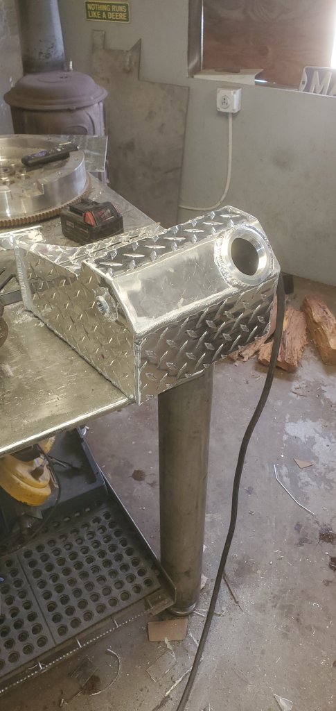

Almost done with degas bottle. It tucks up under the cowl. A 6.0 bottle may have worked...

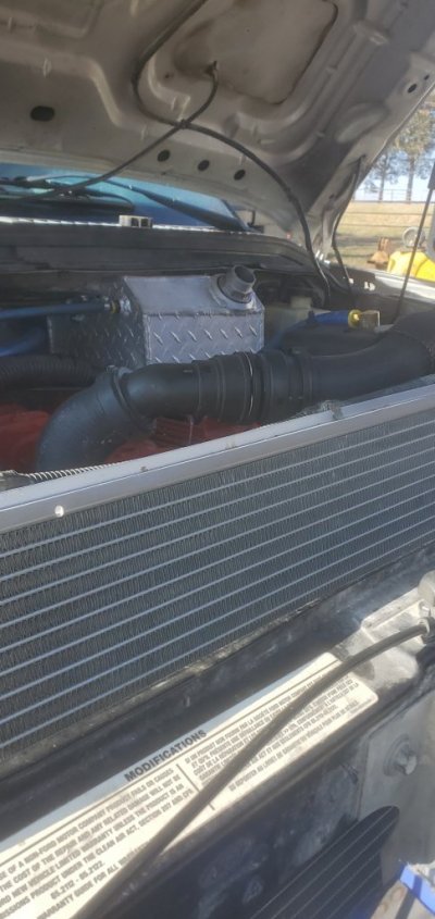

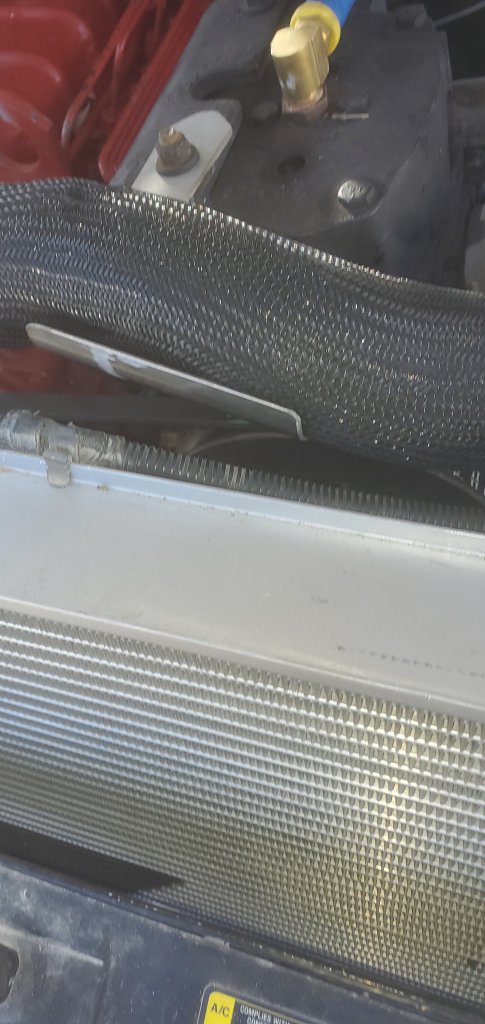

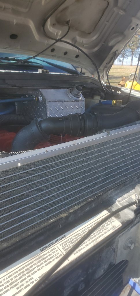

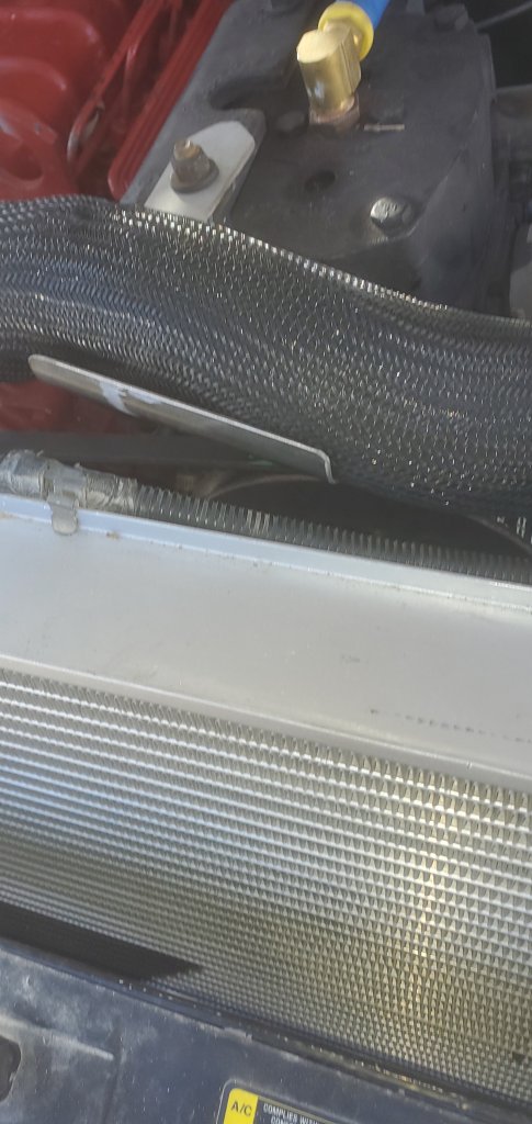

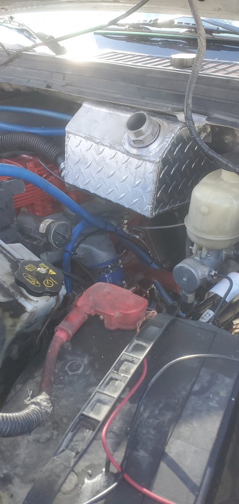

Just about done except wiring and cosmetics. Degas bottle fit.
Made a support for the radiator hose like the downpipe holder.

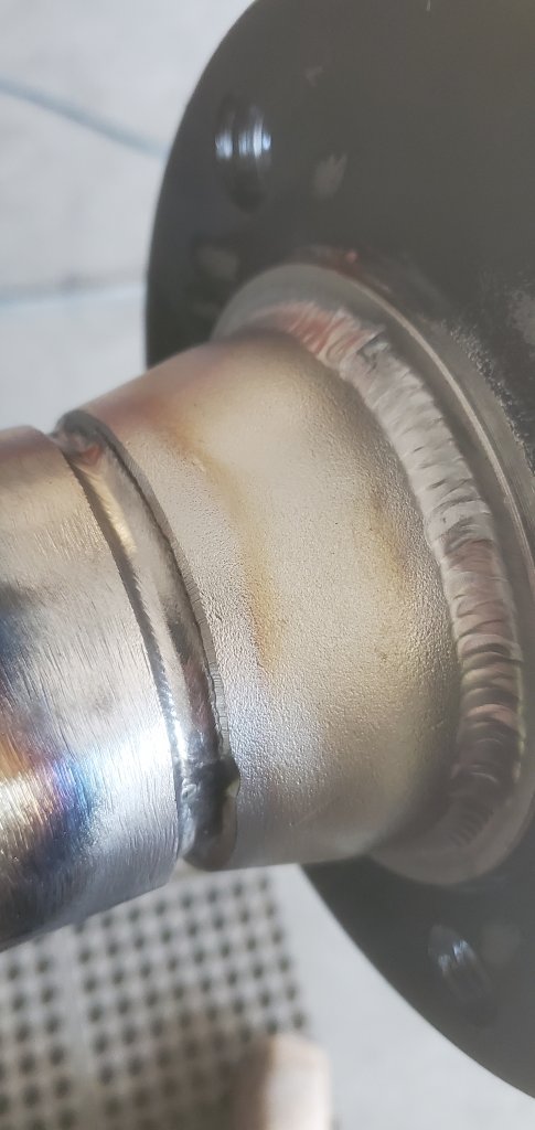

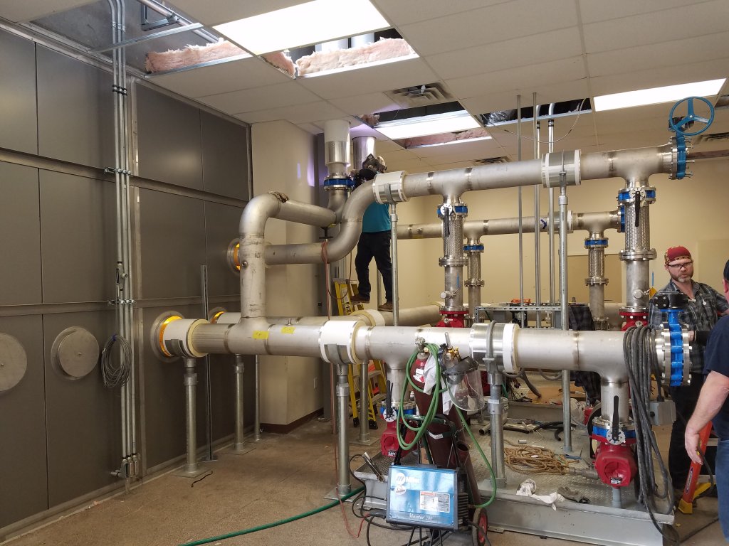

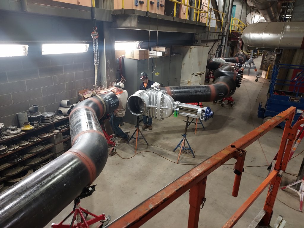

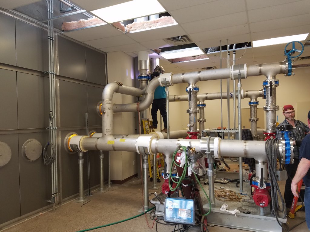

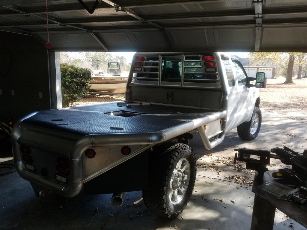

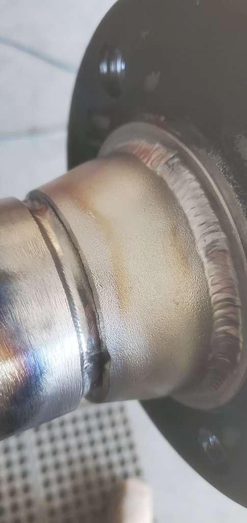

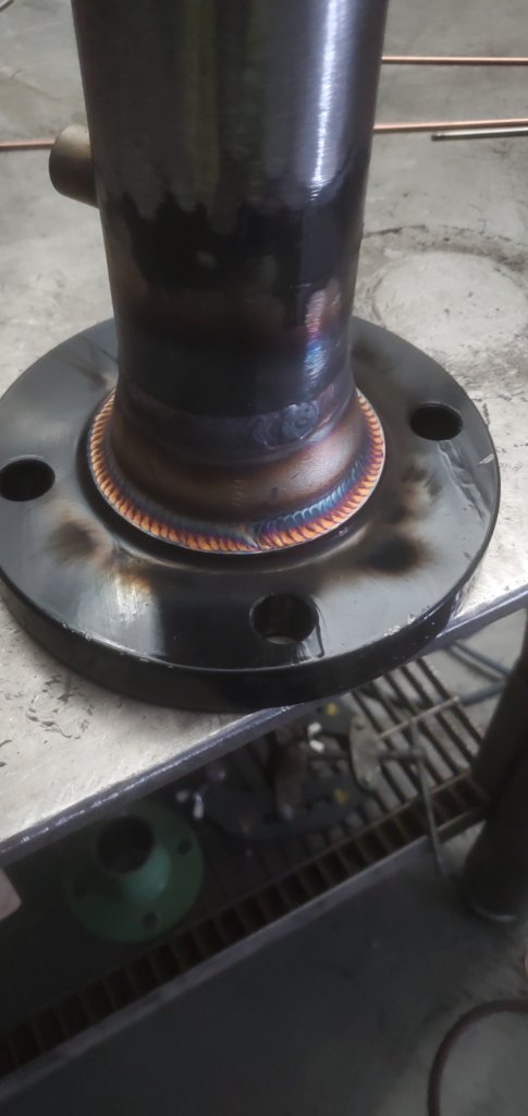

Actually project manager/superintendent. I still get to weld and fit when I get caught up on meetings and BS.
Nice.
I'm a pipefitter, always nice to see some slick welds. Could have gotten into management several years ago, but thought I wanted to do some farming instead, lol.
So, I still make welds parttime, and blow the income on the farm!

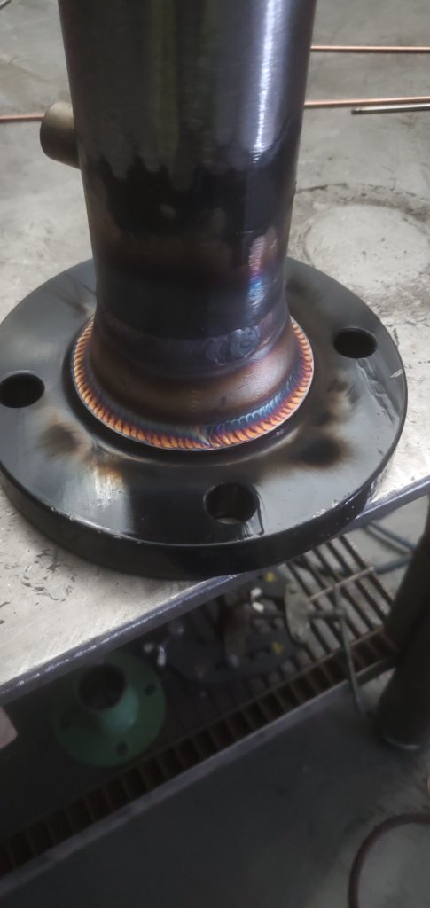

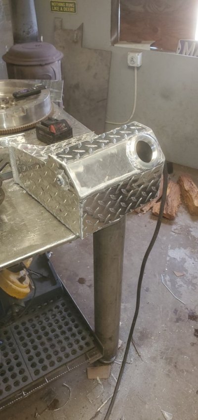

Did you see this one I did a couple years ago? It's my holding tank now for compressor on engine. Nice for hay season blowing out radiators etc.
