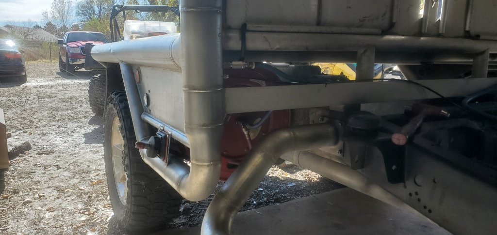

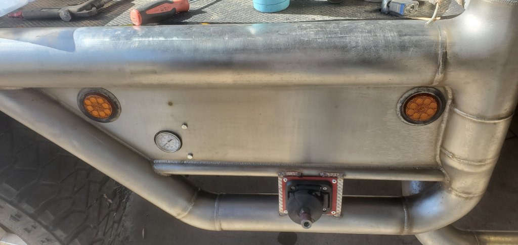

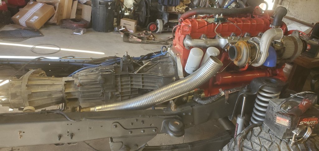

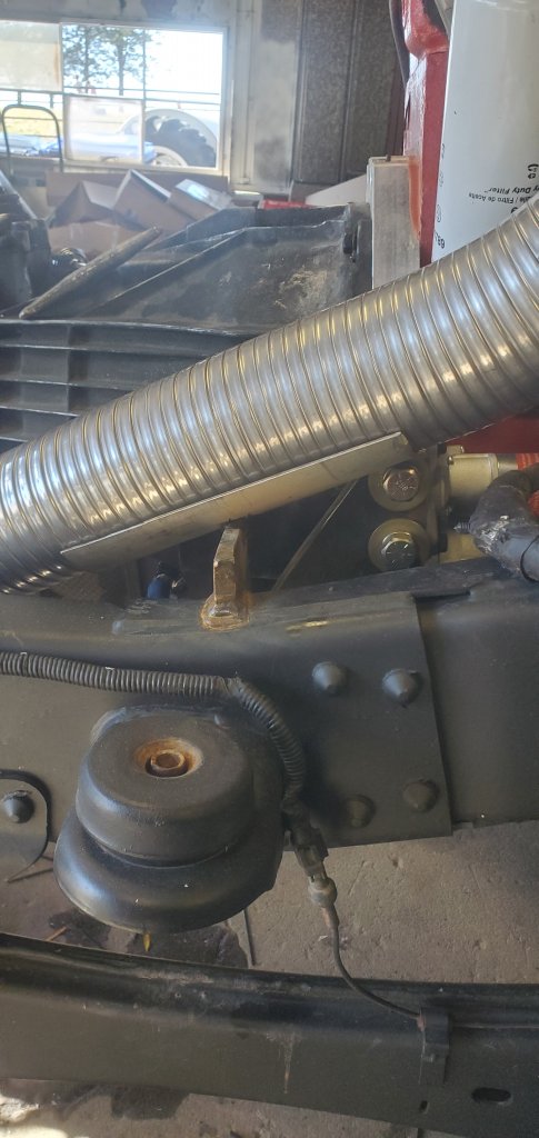

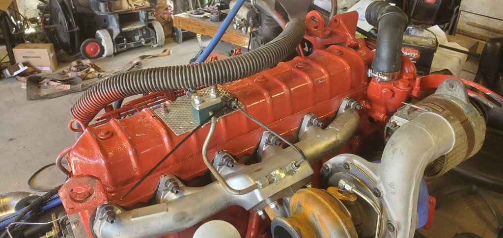

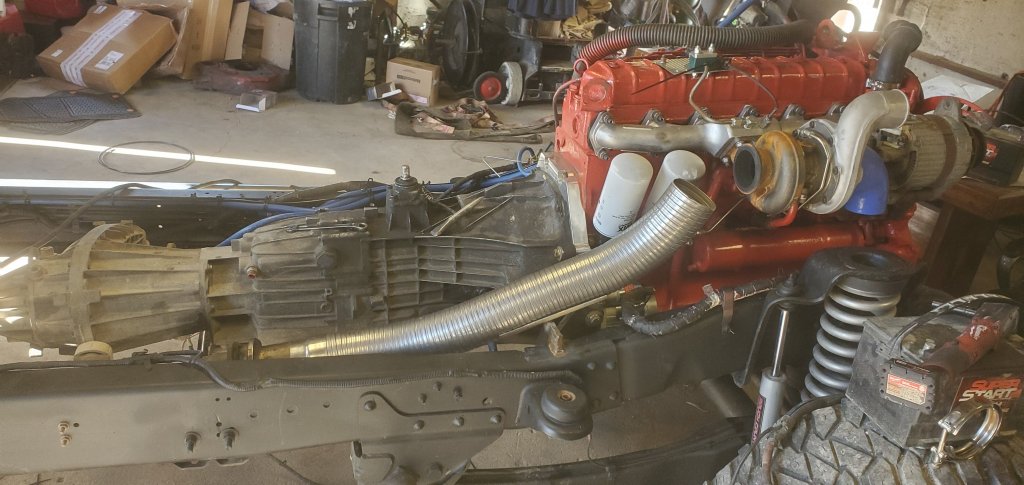

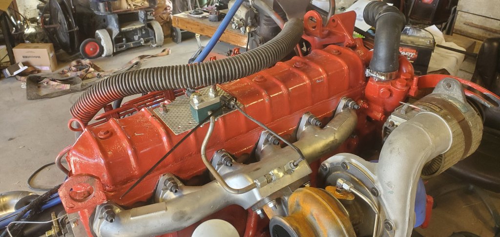

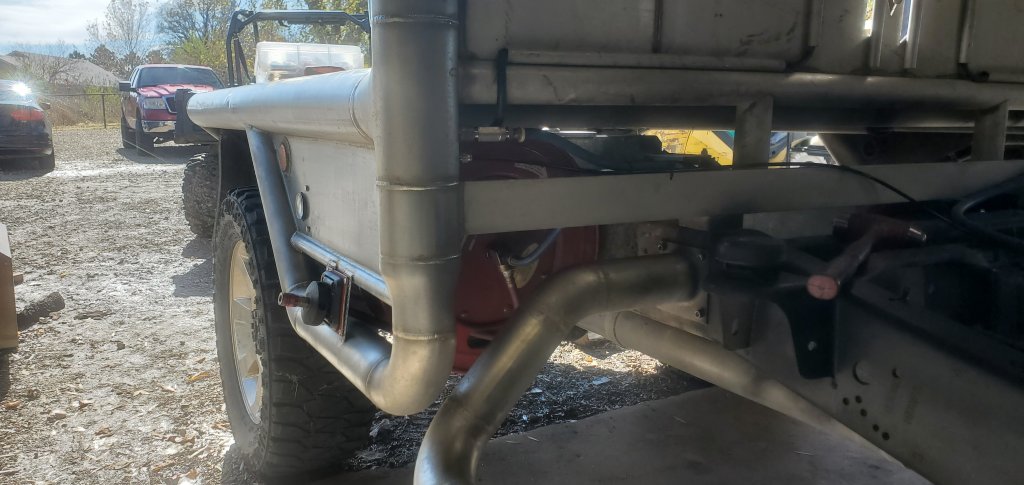

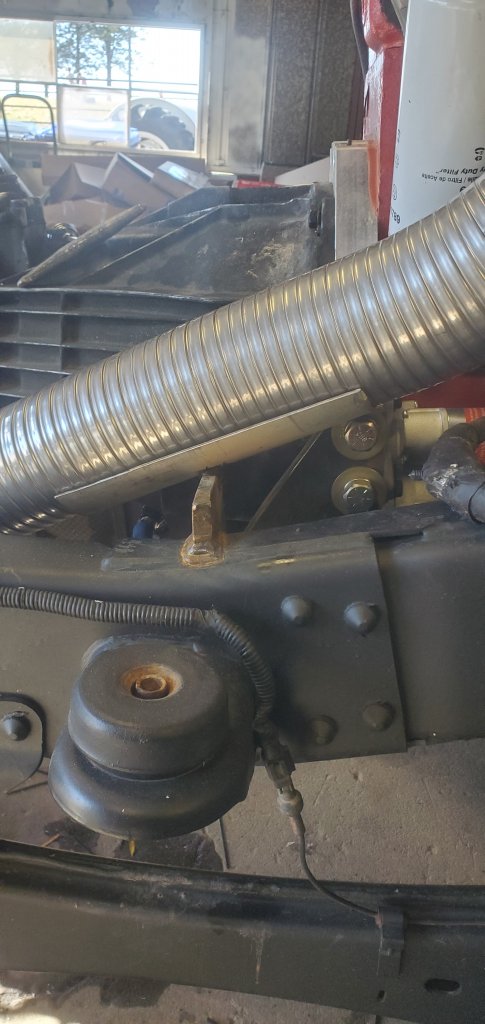

Air system done. Hose reel mounted under bed. Exhaust connected. Power steering line complete. Cab on today and possible drive.

Clutch is super easy, I love it.
Still have to fab a de-gas tank and ton of little stuff for a real drive.
