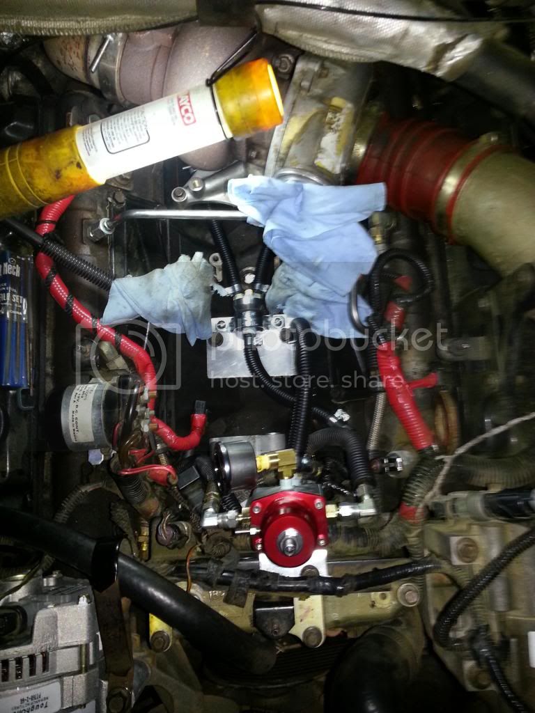

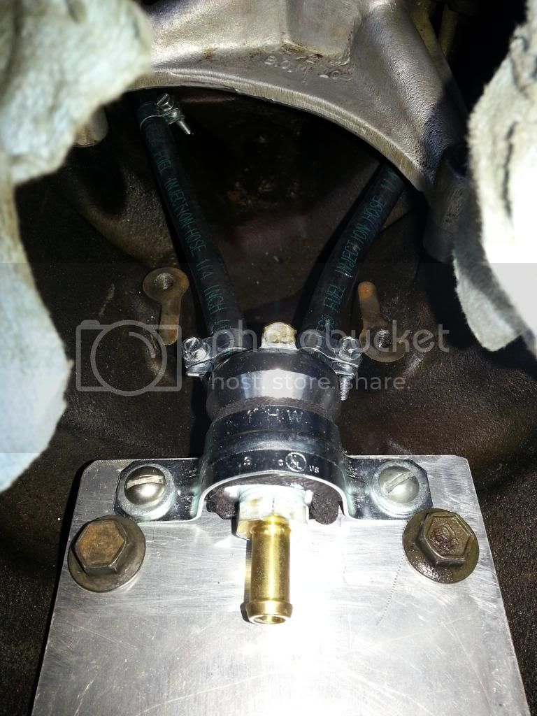

The y-block I ordered did not work. It was too wide with too much of an angle on the outlets. I decided to go with a air hose 3 way manifold like Tom S used in his setup. Here are a few photos of the top of the motor.
I don't have any pictures of the pump/filters mounted up but will get some later on. I still have to do all the wiring. Hopefully I'll be able to knock it out after work today.
