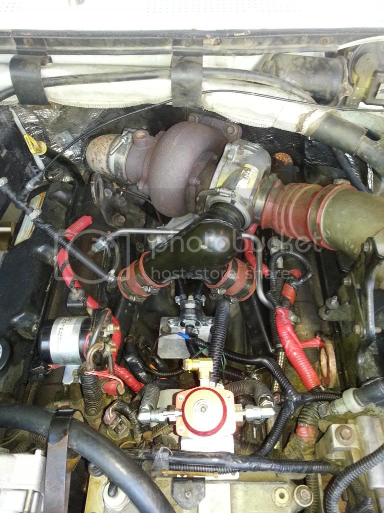

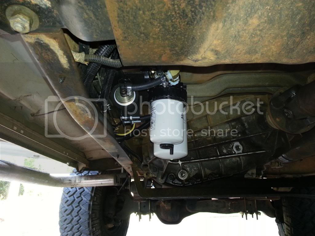

I have 2 leaks at the moment. Both are small leaks and I'm not too worried about it for the moment. One leak is at the post-pump filter assembly. I can't tell for sure if it's leaking from one of the plugs or if I put the filter on too tight. Either way, should be an easy fix. The other leak is top of the motor under the turbo where I clamped my fuel hose onto the stock line. It was a real PITA to get my hand under there and torque down the hose clamp, so the fix for this issue will be to either pull the turbo and make sure it's torqued down good, or to go ahead and upgrade those lines. The passenger side line isn't leaking at all, but I was able to position the clamps where I could torque them down better than the driver side line. I am leaning towards changing out the lines and putting in steel lines that reach out from beneath the turbo, where it will have hose barbs and connect to my existing setup but allow me to torque the clamps down without having to get my hand under the turbo. I'm thinking a setup like Tom S has, but haven't investigated much about those lines to see what I'll need yet. The top of the motor leak hasn't leaked out enough to drip down the back of the motor yet, just a small puddle in the valley. The fuel filter leak is leaving a spot about as big as a quarter in the driveway.

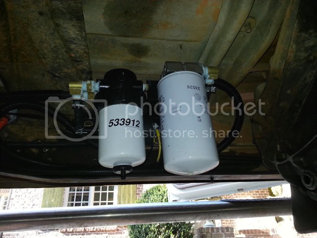

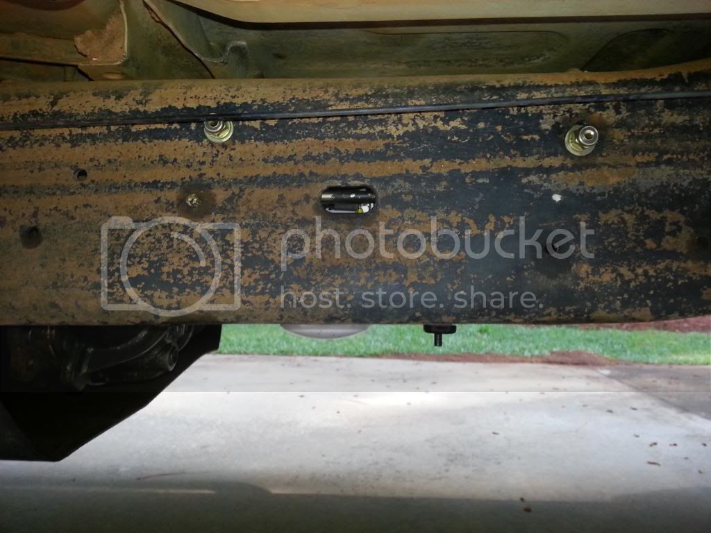

Finally got some photos...

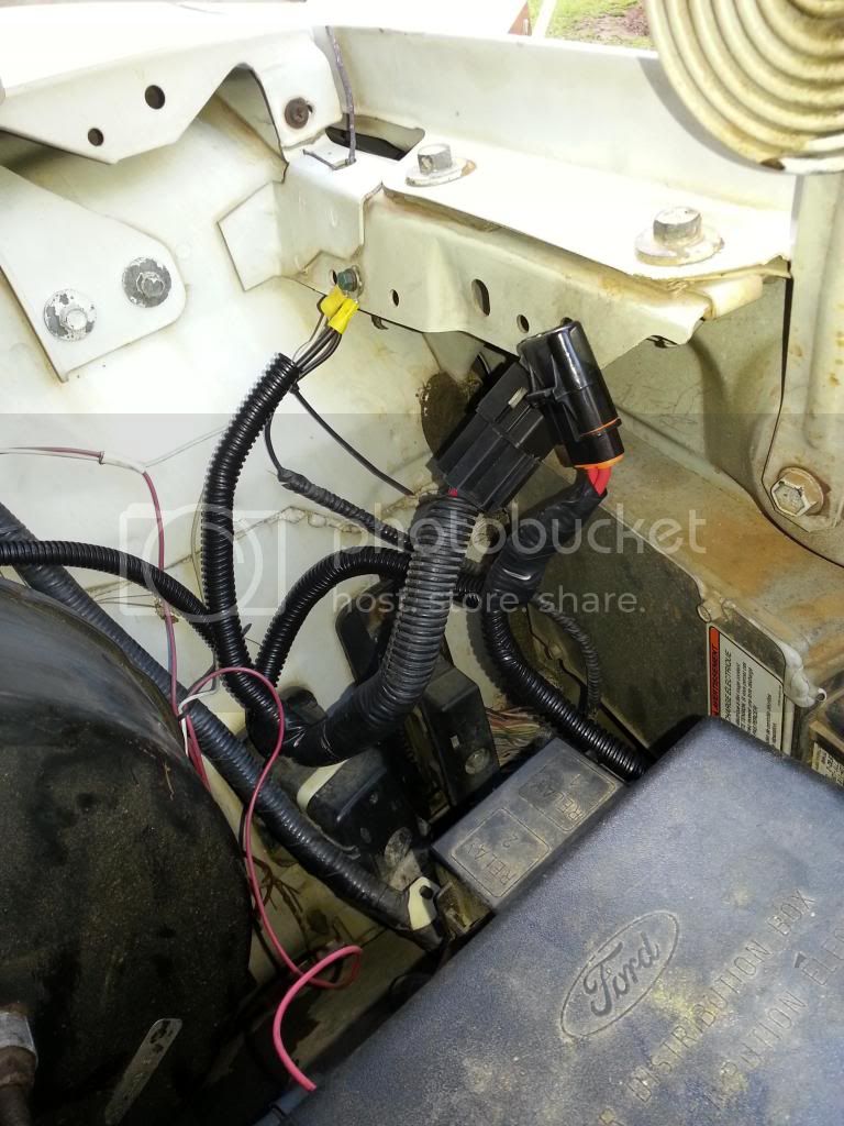

I'll have to get somemore photos of the wiring if anybody wants to see that. Planning to upgrade the lines on top of the motor in a few weeks. For now, the leak isn't enough to put aside all the other stuff I've got goin on.
