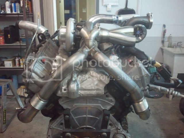

Yes, all piping, v-bands and bellows are from Vibrant.
The piping is mostly vibrant. The bellows are not though. They are incolnel bellows and came from another manafacturer. I can't remember the name off the top of my head. Very expensive, but supposed to handle the pressure. The vibrant ones kept coming apart on robs truck, so we ordered a set for ryan and one for rob. The collectors came from columbia mandrel tubing or something along those lines. IMO the collectors are a lot nicer than the vibrant ones.

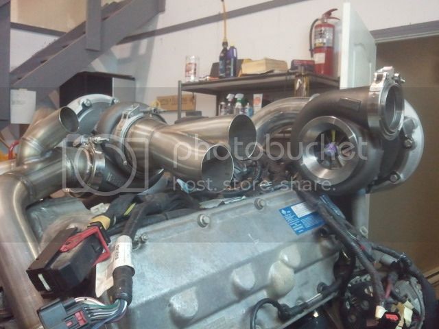

It's comin along slowly. They have all winter to finish. We'll post updates as we go. Last I heard they had the up-pipes welded and are working on waste gates.

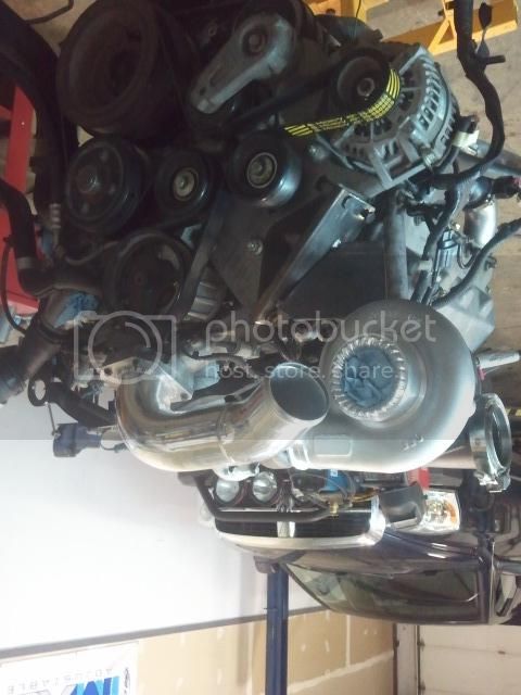

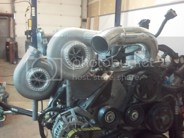

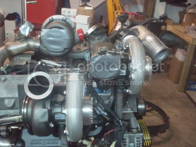

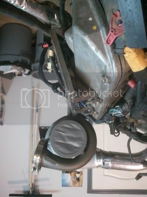

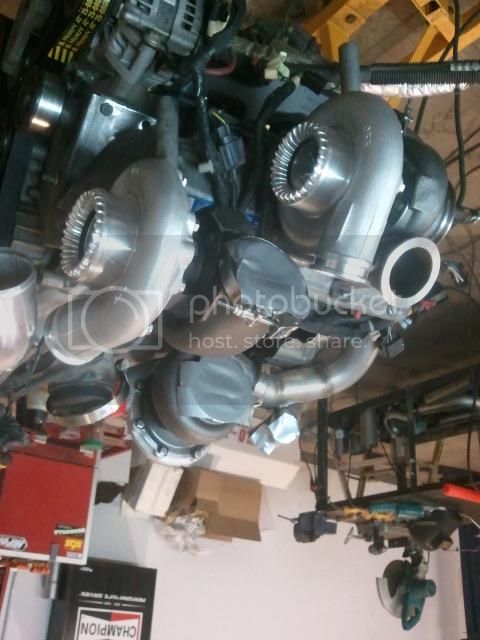

Who's ready for things to get complicated?... lol
I'm so happy with their work!!
Erikclaw
4,877
Central CA
Now that does look complicated. I thought you were running three 62's? Or am I off? The two hanging off the pass valve cover look like different sizes.
Kind
1,498
Two 62's and a 66. They are both 62's on the side.
