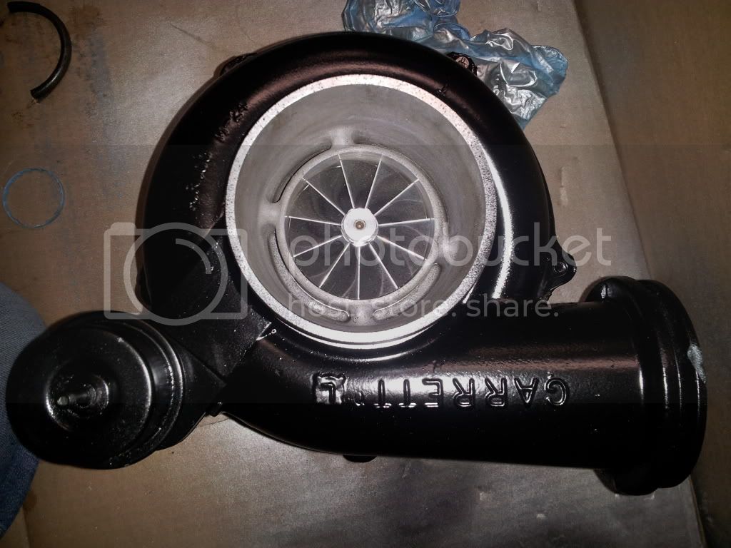

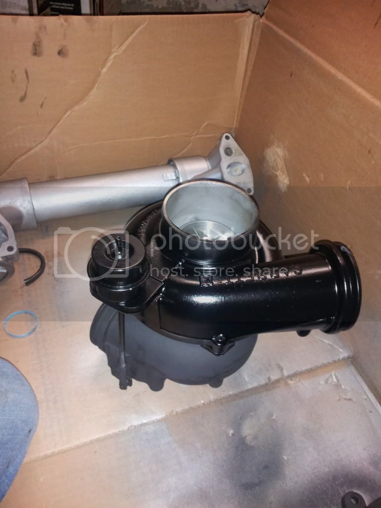

The dull stuff on the 38r turbine is what Ill use. The vht stuff wont stay on.
