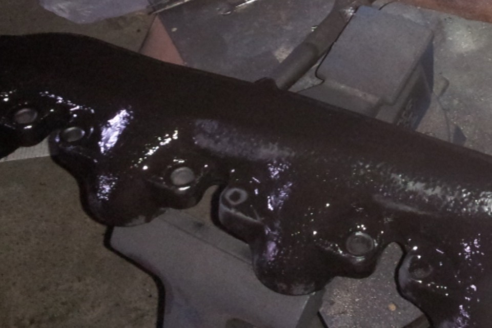

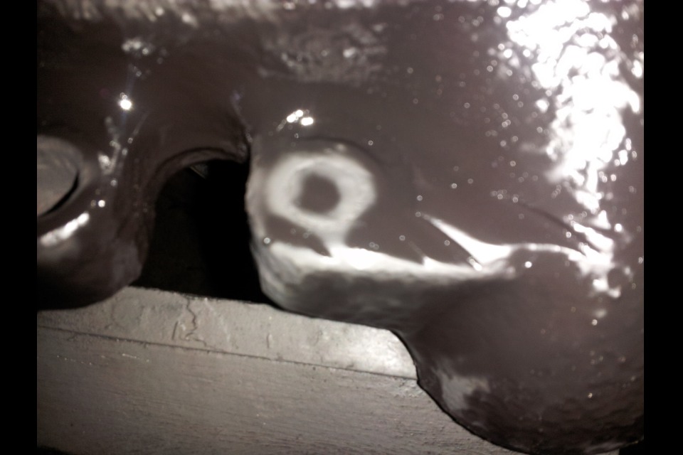

We drilled it out tonight. Then ran a reamer through all the holes to.clean them out. Im not sure who mentioned it in here.but the hole where the bolt.got stuck/rusted in IS smaller. The bolts are all the same but the one hole is tight to allow you to line the manifold up.
Locally Ive found no stainless bolts that are rated for the torque it takes to hold.these manifolds on. I know guys are using SS but it seems like a.gamble. One im not willing to take.

Fyi-rustoleum 2k degree.paint is friggin.great. The vht stuff is trash.compared to.rustoleum. There may be a shot in hell this.stuff will STAY on the manifolds. Vht is rumored to.peel right off when heat comes up the first time.

well, if you shot-peened the manifolds first, and then painted them with an oil-based paint, it might stay a while....we never had much luck with the Cummins engines in the Big Trucks exhaust manifolds staying painted......we'd shot peen 'em and paint them , and they'd cook in the first week, and look pretty cool, then slowly , over a period of the next month or so burn most of it off again..... look good for a while tho....always wanted to try a good Rust-Blue, like a gun is blued, but never got 'round to it....

Blued would be cool...ill let ya know if the paint cooks.right.off....
