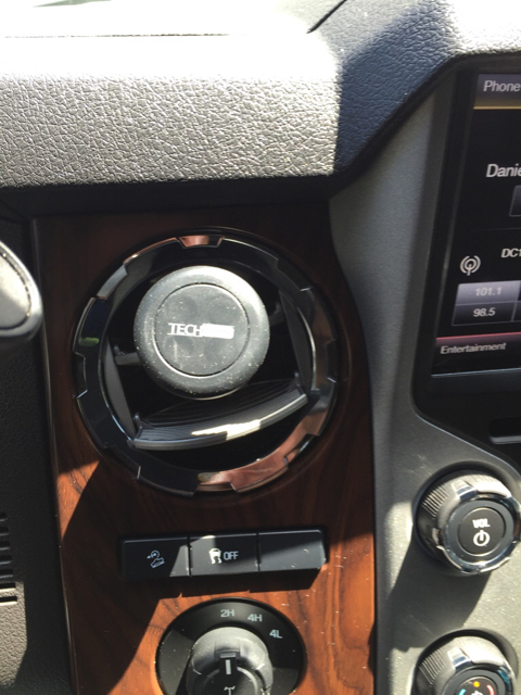

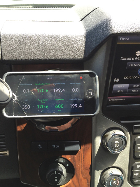

Here is how Jody mounts his...
Using this mount...

Lost of options with this mount and it's about $6.

2nd that haven't looked yet but are the wires long enough to plug it back in once you move the probe from the exhaust into the ****** plate? Any other option to use something to monitor other then your iPhone or iPad?
yeah the wires are long enough and once on a diet , yes you'll need at minimum a blockoff kit or full removal . then just use a sensor from the exhaust .

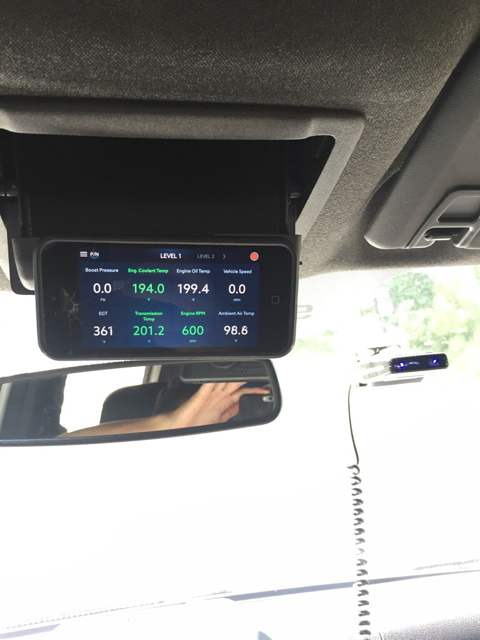

I just zipped tied mine to the wire cluster under the dash closest to driver door. It's hidden very well.
