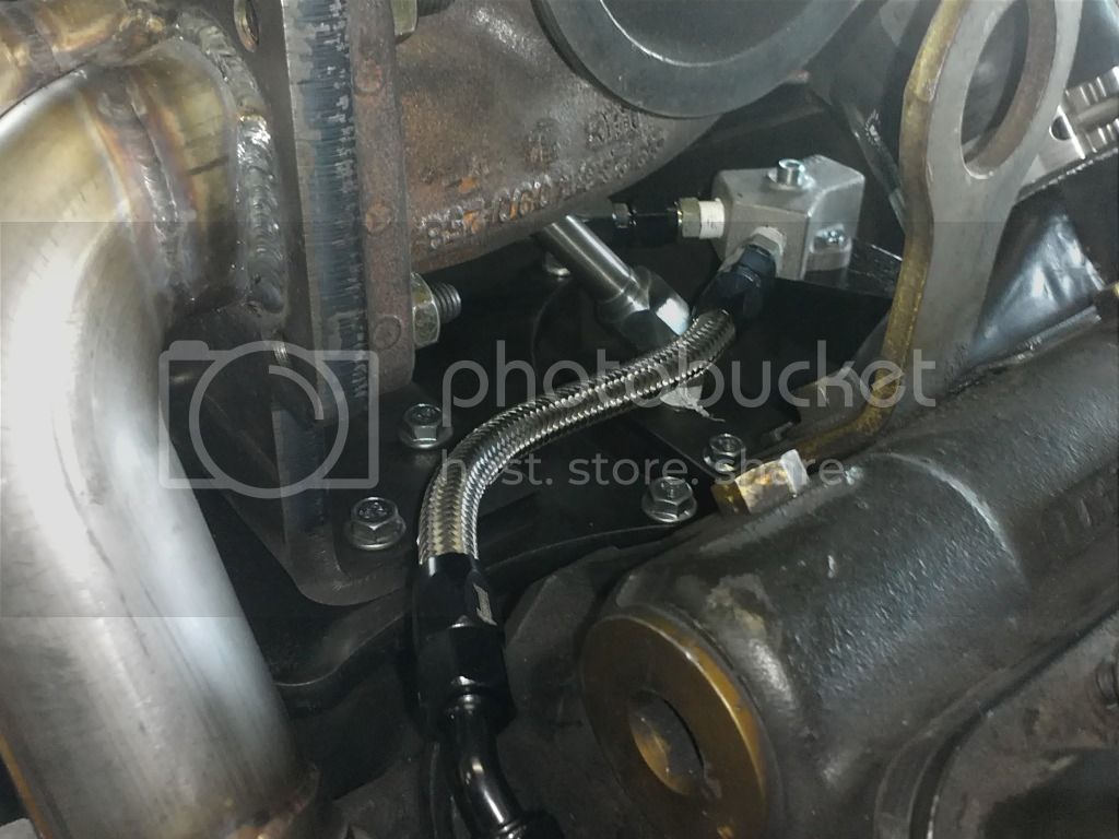

I used 1/8 npt to -6an adapter and a -6 45° swivel on the heads with a y in the valley. So I have 1/2 pushlock from my filters up to the y in the valley, then 3/8 braided out of the y to back of heads, and 3/8 braided from front of heads to regulator.

You can keep the motor lift eyelift on and still use the down pipe?

Are you using a turbo kit from a vendor or fabbing your own? I used irates kit and the down pipe that came with it was perfect after massaging the firewall some.
