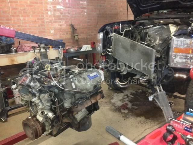

Cab off? What's that? They aren't that hard to work on with the cab on. If you are used to pulling cabs then it seems difficult. I would pull the engine out and do it on a stand before I did it in the truck though. Doesn't take that long to get one out.
