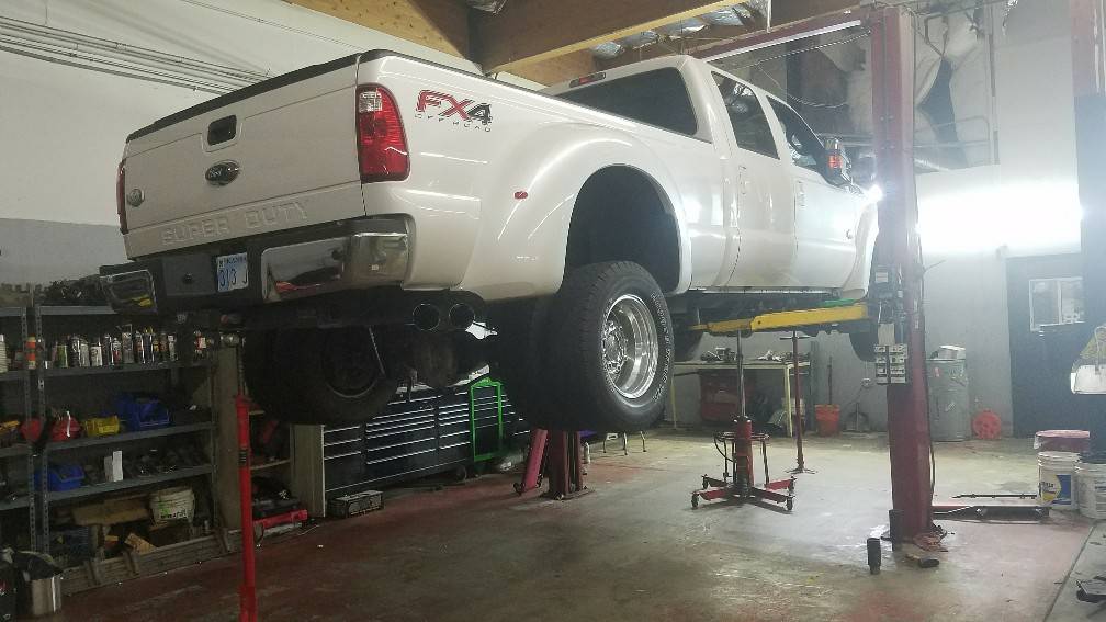

So about last august Morgan Primm and myself started jaw jackin about the next progressive step for this here tow pig. After a lot of, you're stupid no you are, we finally came to the conclusion to go compounds with a billet 475 over my streetmaxR. Then we laughed about how quick I'd trash the stock motor, so we decided on a mild build with rods and 30% injectors.
We had a tentative date in mind to get the truck in around December 1st and be done before Christmas.

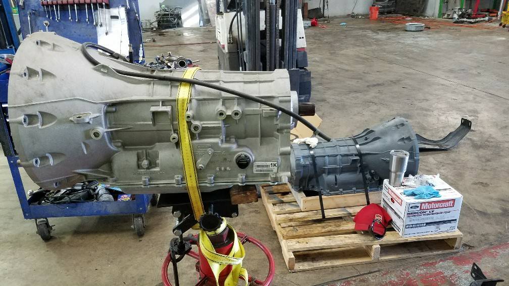

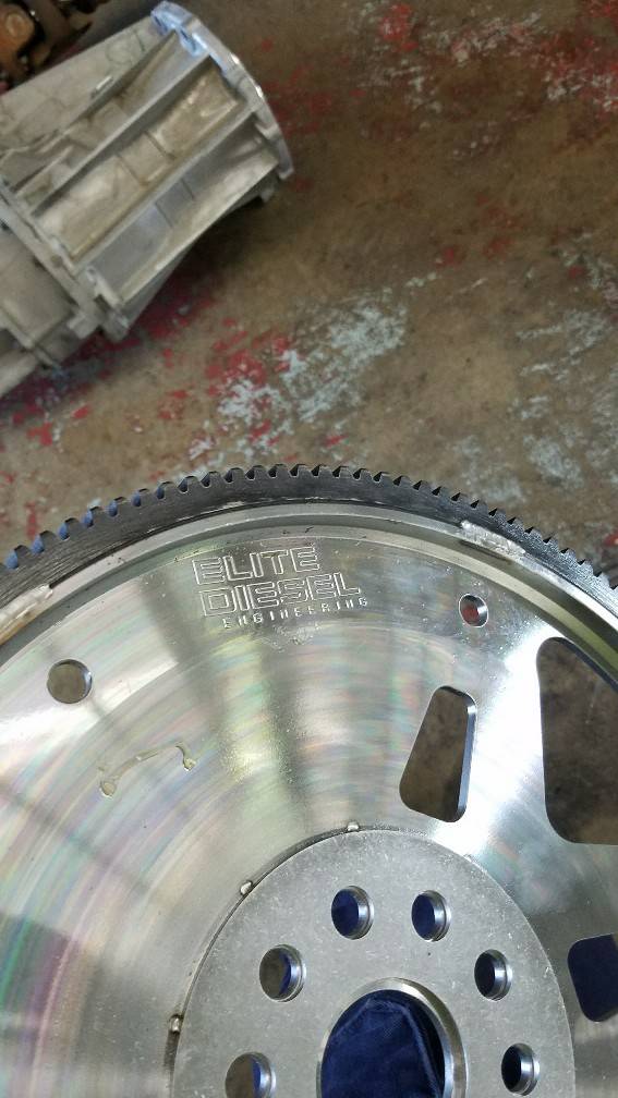

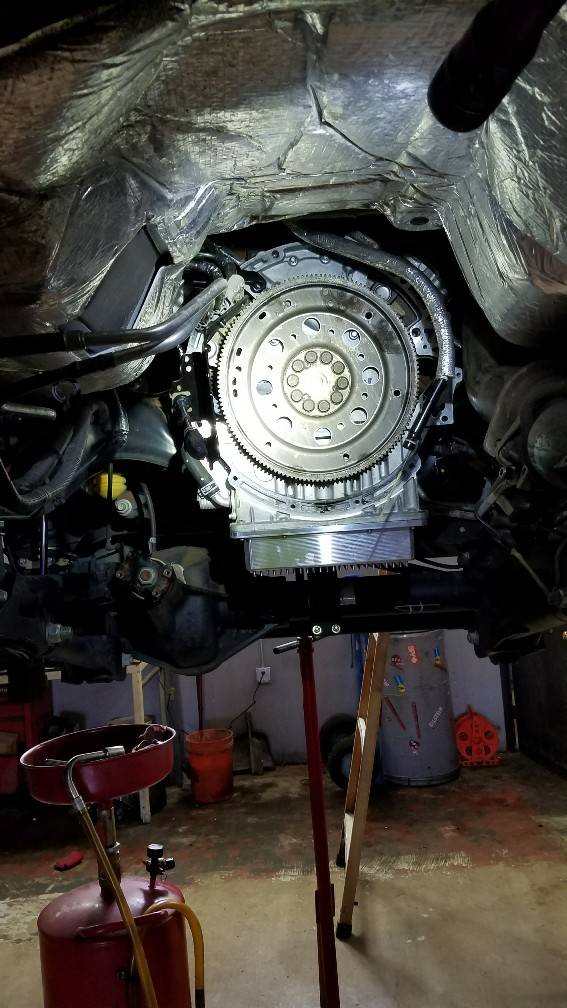

Just by happen chance, my Midwest stage1 trans **** the bed on the drive to Athens that day, sooo we laughed at it and left it there. Ended up that the forward seal blew. All clutches were checked and fixed and we decided it'd be a good idea to upgrade it to a stage 2.
During the trans debacle we him-hawed about all the things that had been decided on the motor build and one thing lead to another and bigger plans were made.
A couple months later we had a finished truck down and running. During initial engine break-in it was decided the upgrade precision converter was NOT liking the power upgrade, so that was addressed with a 4disc Suncoast unit.

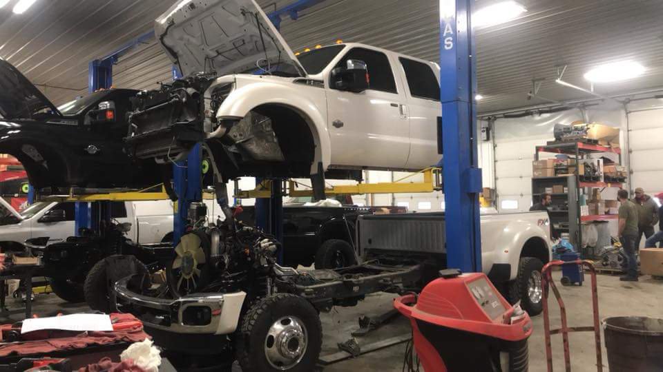

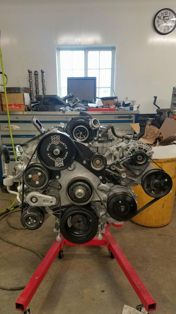

Soon after, during live tuning the motor had a catastrophic failure and was trashed. Never having seen this problem before on a 6.7 was a stark reminder what an asset Morgan was, we needed his problem solving skills damnit!
Another engine was built and a few more upgrades were added for peace of mind. Fast forward a bit and the truck was back on it's feet. The new motor was noticeably quieter and smoother as well, yay.

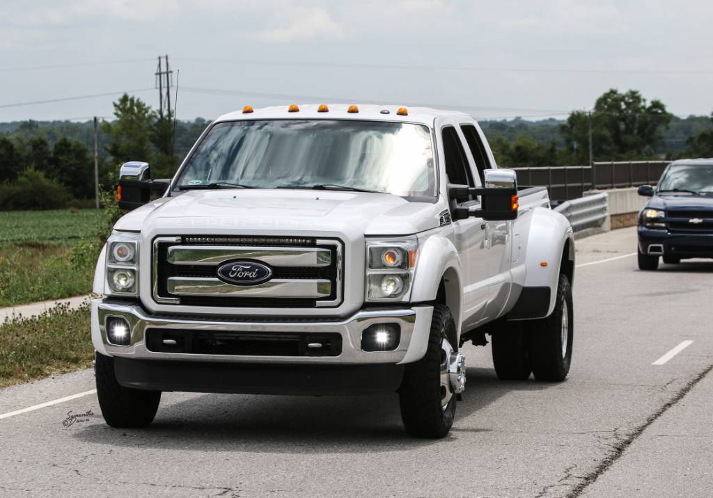

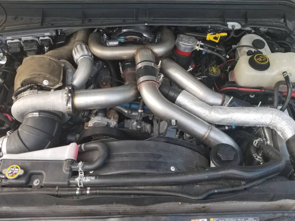

While we're still trying to dial in Vgt maps and driveability, I can without a doubt tell you this thing is a moster even with the small amount of fuel we're set on. Without further ado, here's the build list:
Midwest stage 2 engine
- Forged Connecting Rods
- HS Motorsports Billet Oil Pump Regulator
- OEM Hydraulic Lifters
- Balanced Rotating Assembly
- Torque Plate Honed Cylinder Block
- Tig-Welded Cam Gear w/ Stage 1 River City Diesel Cam
- Tig-Welded Crankshaft Gear
- ARP Head Studs
- ARP Main Bolts
- ARP Harmonic Balancer Hardware Kit
- Midwest Diesel HD Pushrods
- Midwest Diesel HD Valvesprings
- Coated stock pistons
- HS Motorsports dual fueler kit
- Fass Titanium 95gph (directly feeds cp3)
- RCD BFsump for Fass.
- RCD 60% injectors

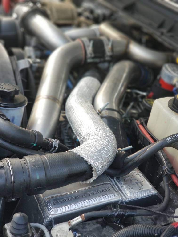

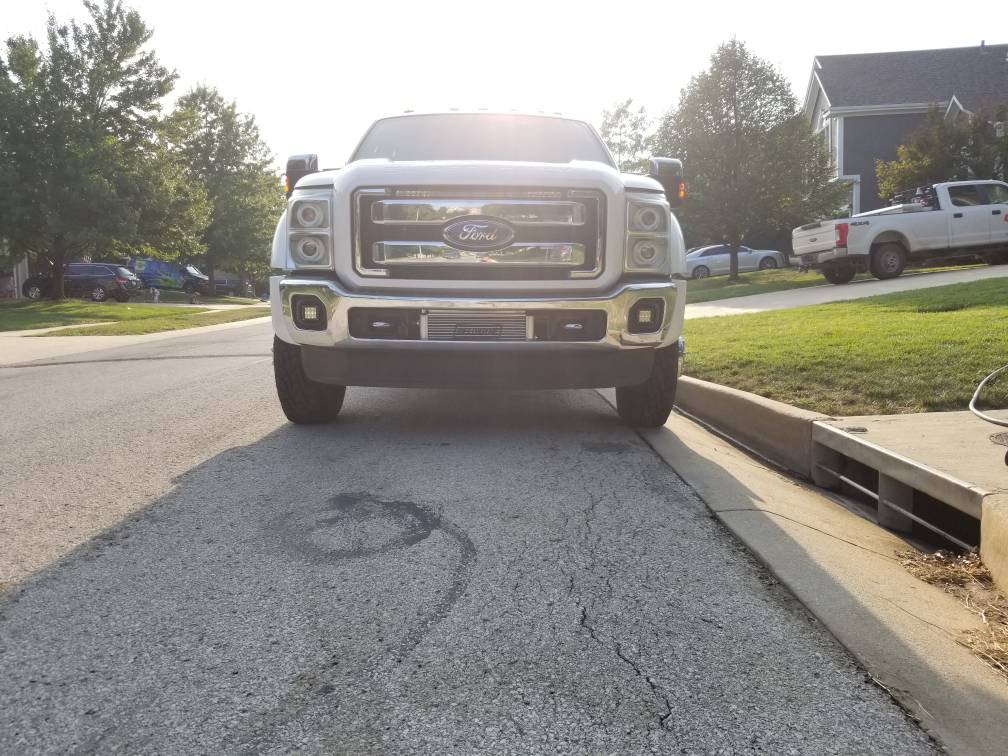

- Absolute Performance Intercooler with custom engraving (see pictures)
- No limit ccv and egr ****** kits
- Midwest MP series 66mm Vgt
- Midwest Compound Kit
- Precision Gen2 86mm atmo (8685 1.12)
- Midwest stage 2 transmission with quad disc Suncoast converter
- OUO ALA kit, traction bars, front height coil adjusters, new street end links, and airbag bypass sytem

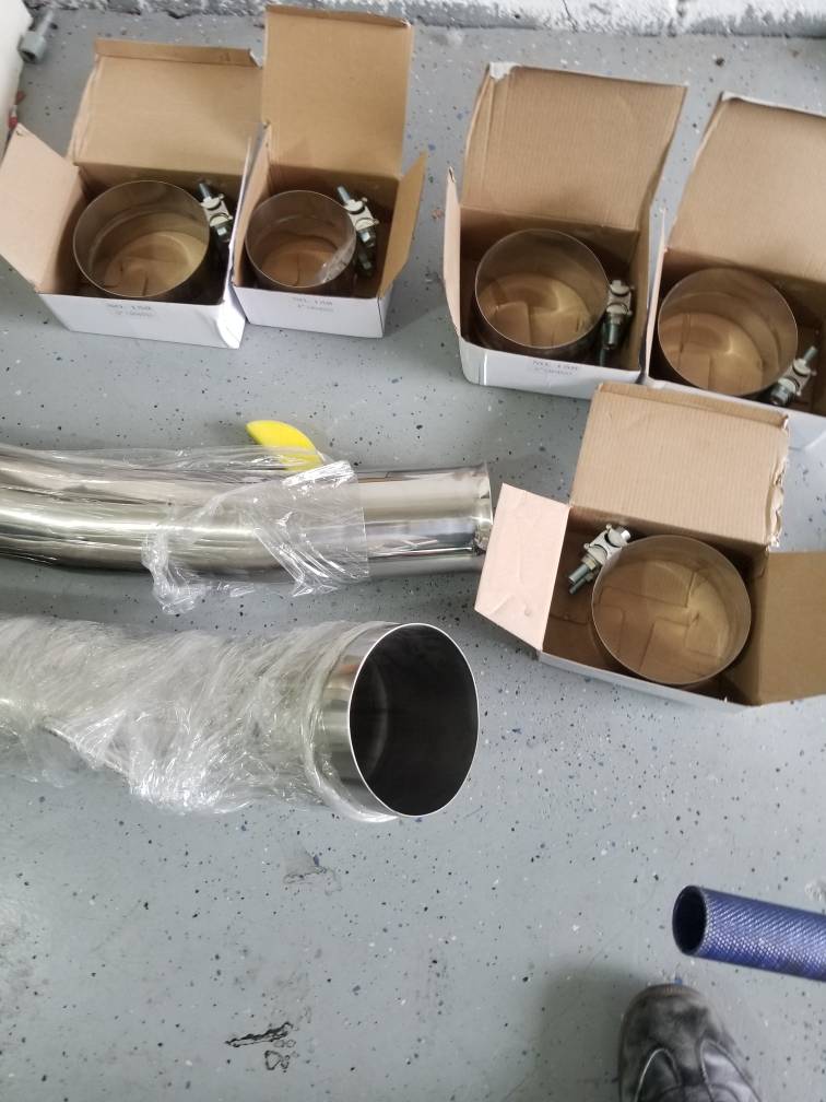

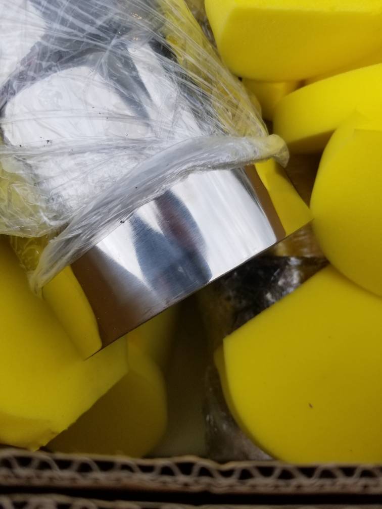

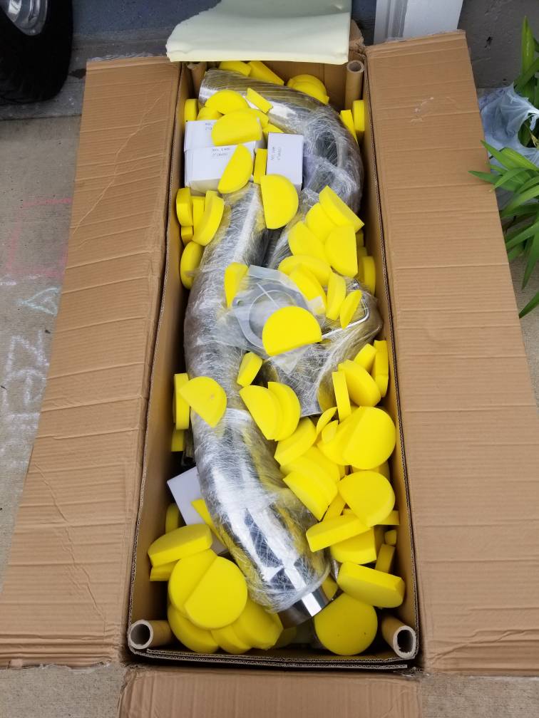

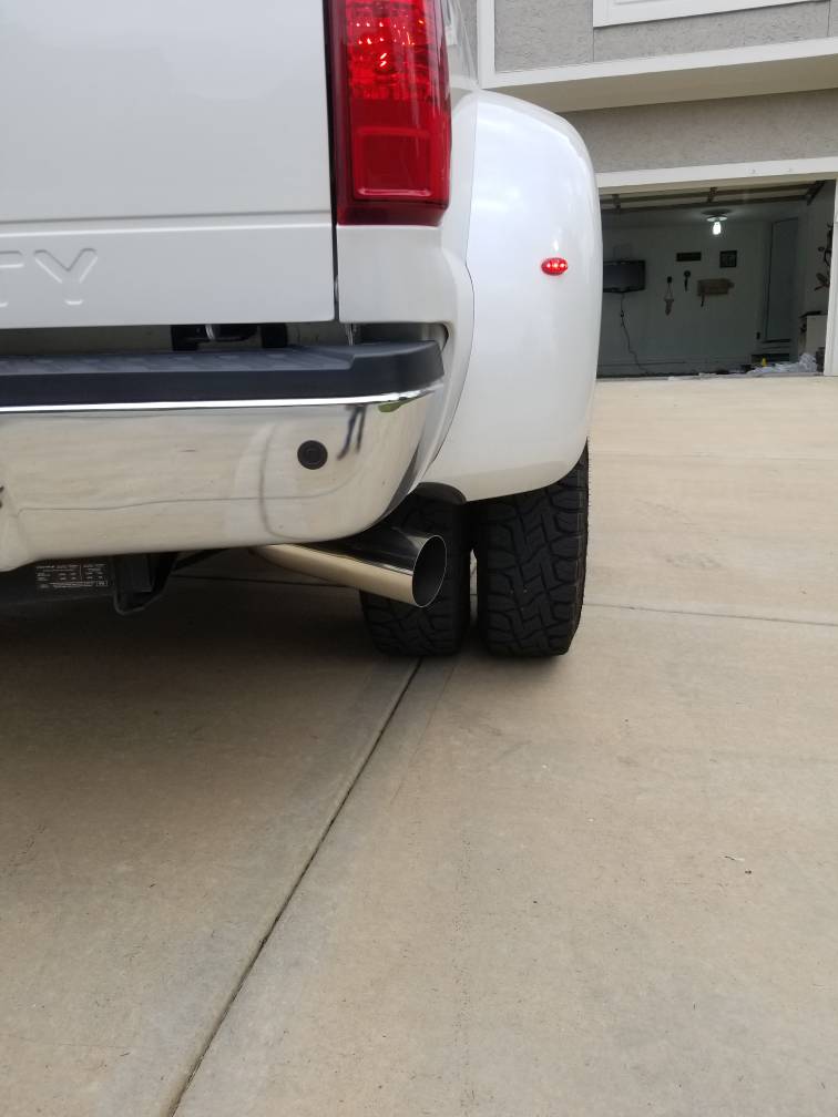

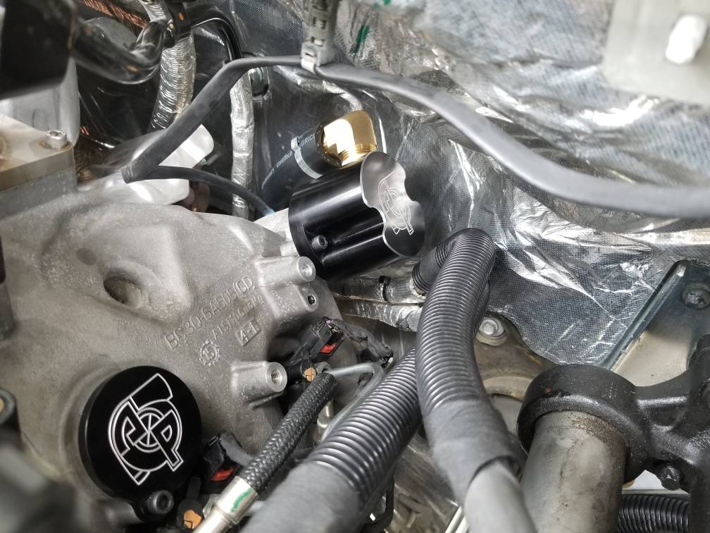

Added a Rudy's true Ss304 5" exhaust and fought with it for a while to get the exit up nice and tight. This exhaust is beautiful.

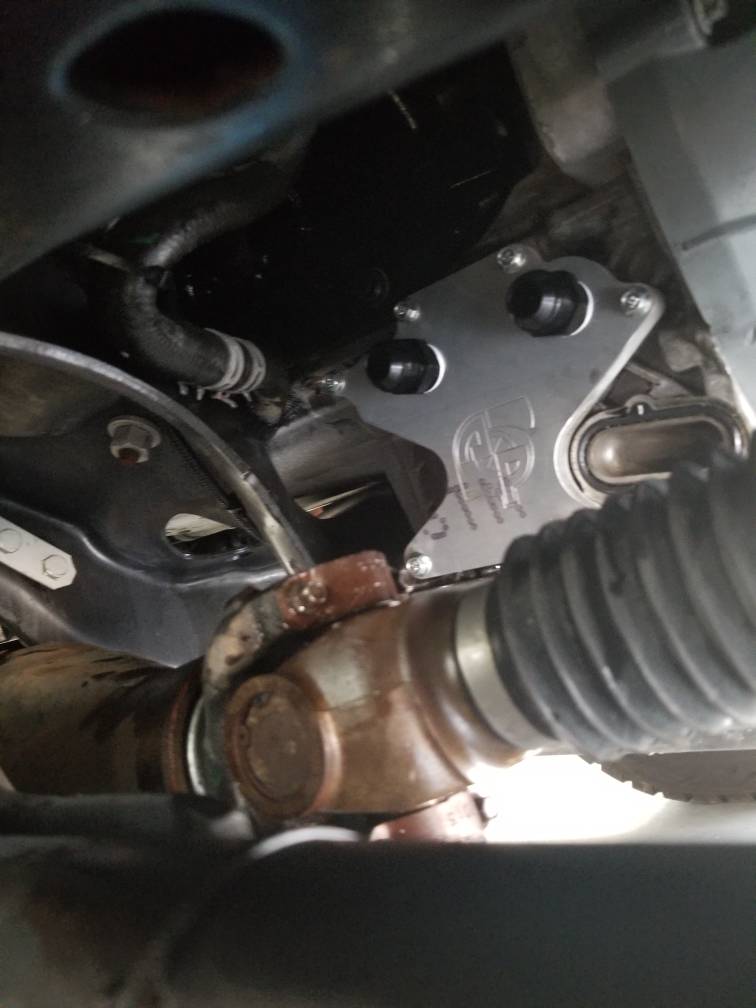

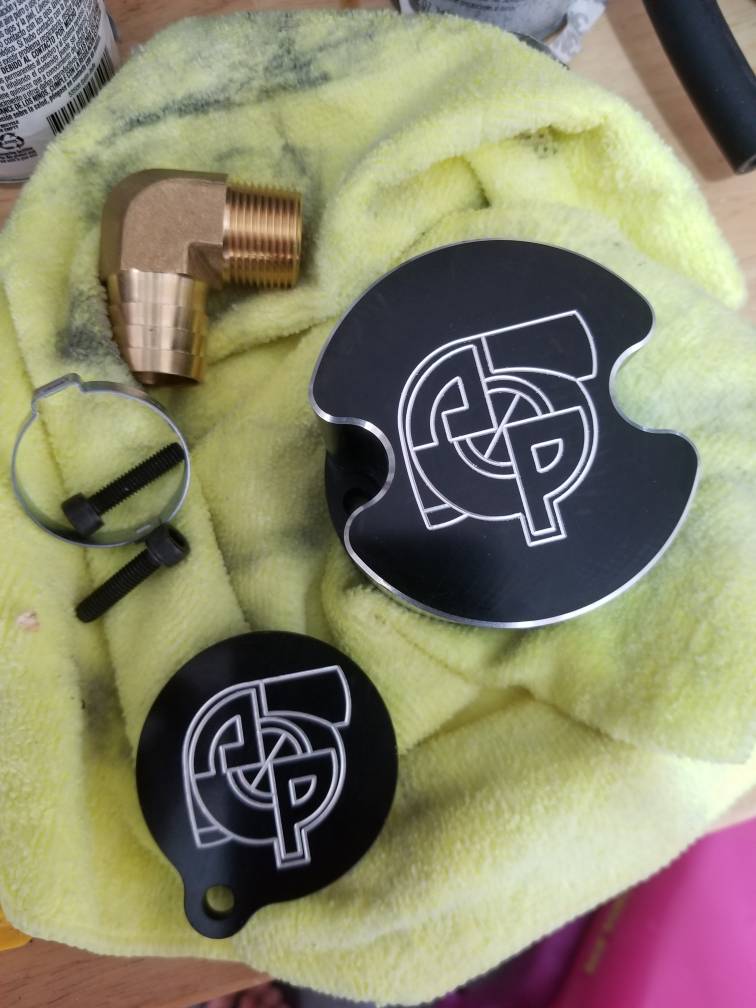

Added AP baffled CCV ****** and Venturi.
Little by little we're getting it dialed in.
jcain
Jul 14, 2013
2,017

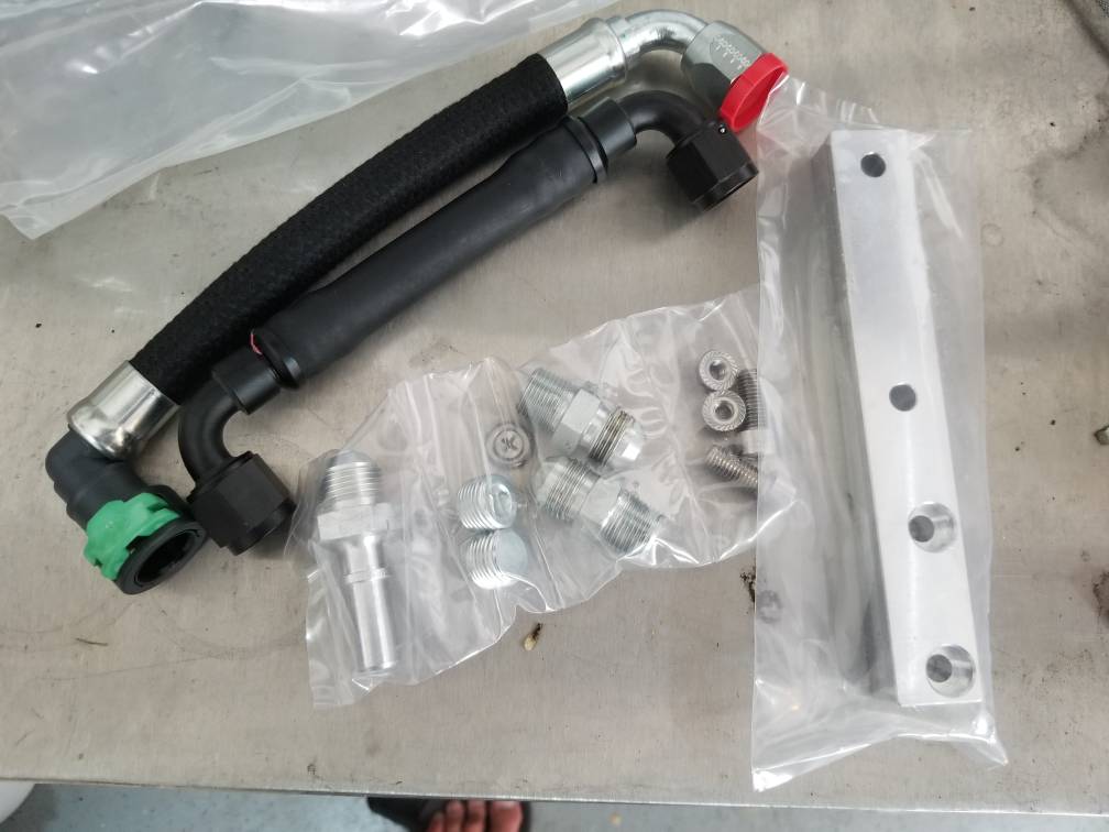

Added the AP remote oil cooler, MPD remote mounting bracket for h&s filter conversion and Rudy's 5" ss304 exhaust
