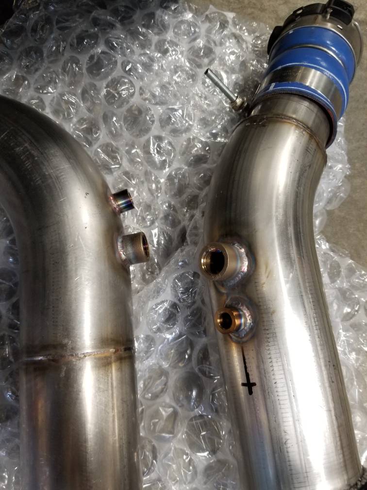

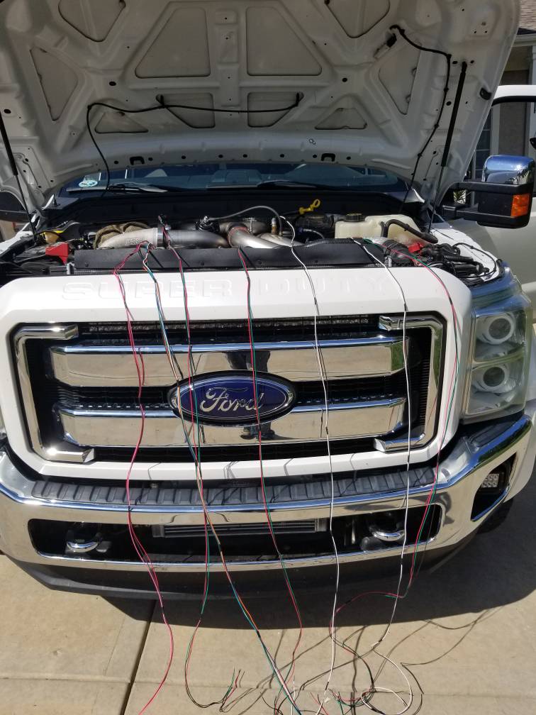

Wastegate fab'd in. Time to party. Also started getting the stand alone data logging stuff in.

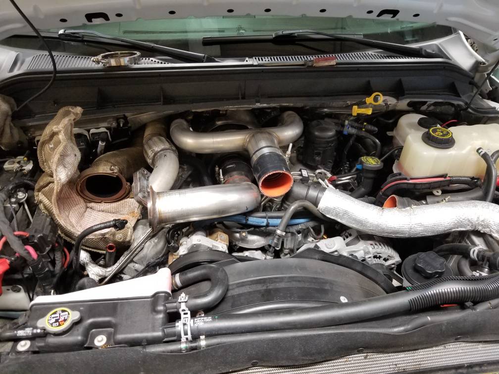

Put down 874rwhp this weekend at the Morgan Primm fall brawl event. Had a wicked exhaust leak and boost leak. Turns out I had blow up pipe gaskets, blow up pipe Bellow and blown wastegate bellow. Took the cab off and had a fun couple days fixing everything.

It made shy of 900rwhp and the injectors we're only at 1700us and 14* of timing along with ALL of the issues. I bet it would've been close with the 60s maxed out. I'd say it'll be well past 1000rwhp this go around.
