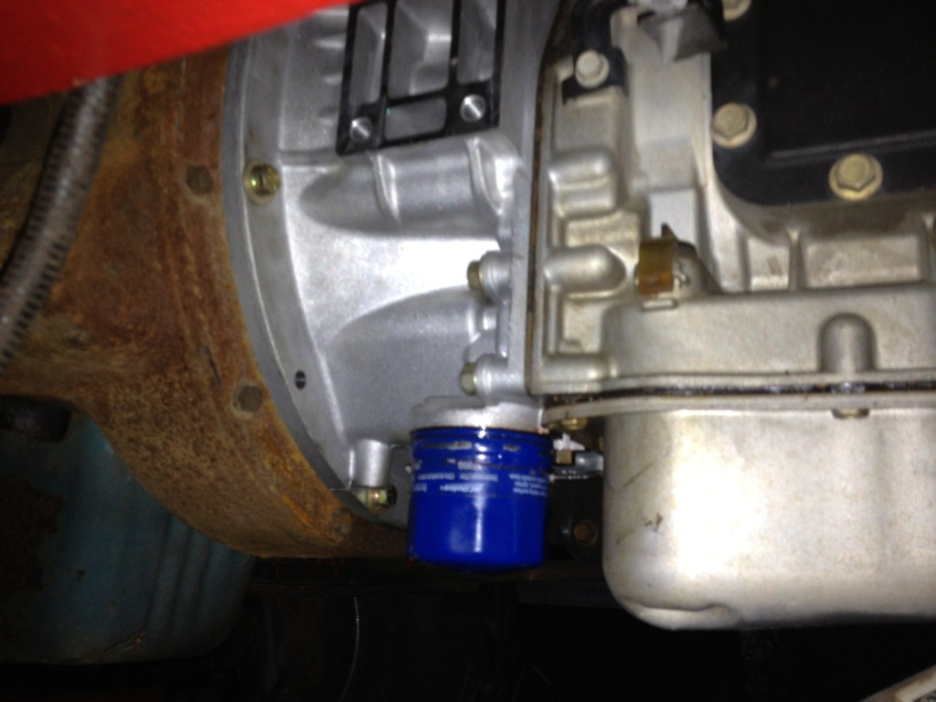

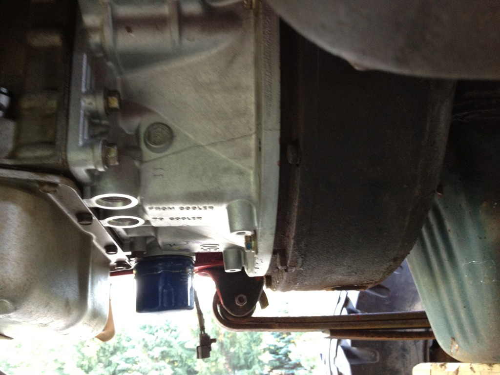

I know I haven't posted pictures yet, honestly forgot about this thread. But here are some pics of the Allison 1000 behind my dt360. By changing the bellhousing and nothing else, the Trans bolted right up the dt360. It will do the same on the t444e flywheel housing as well as the cummins and all other dt series engines. Will on smaller detroits, cats, Perkins and more!

Also by the new setup, my rear shaft will end up a 5 inch 1 piece aluminum. No more crappy 2 piece steel! My transfer case output is less than 1 foot away from the carrier bearing bracket on the crossmember. So I can get away with a 1 piece at 78 1/2 inch long drive shaft I think was my measurement. That's too long for steel so aluminum is what's needed. Price also includes new slip yoke for the tcase output
