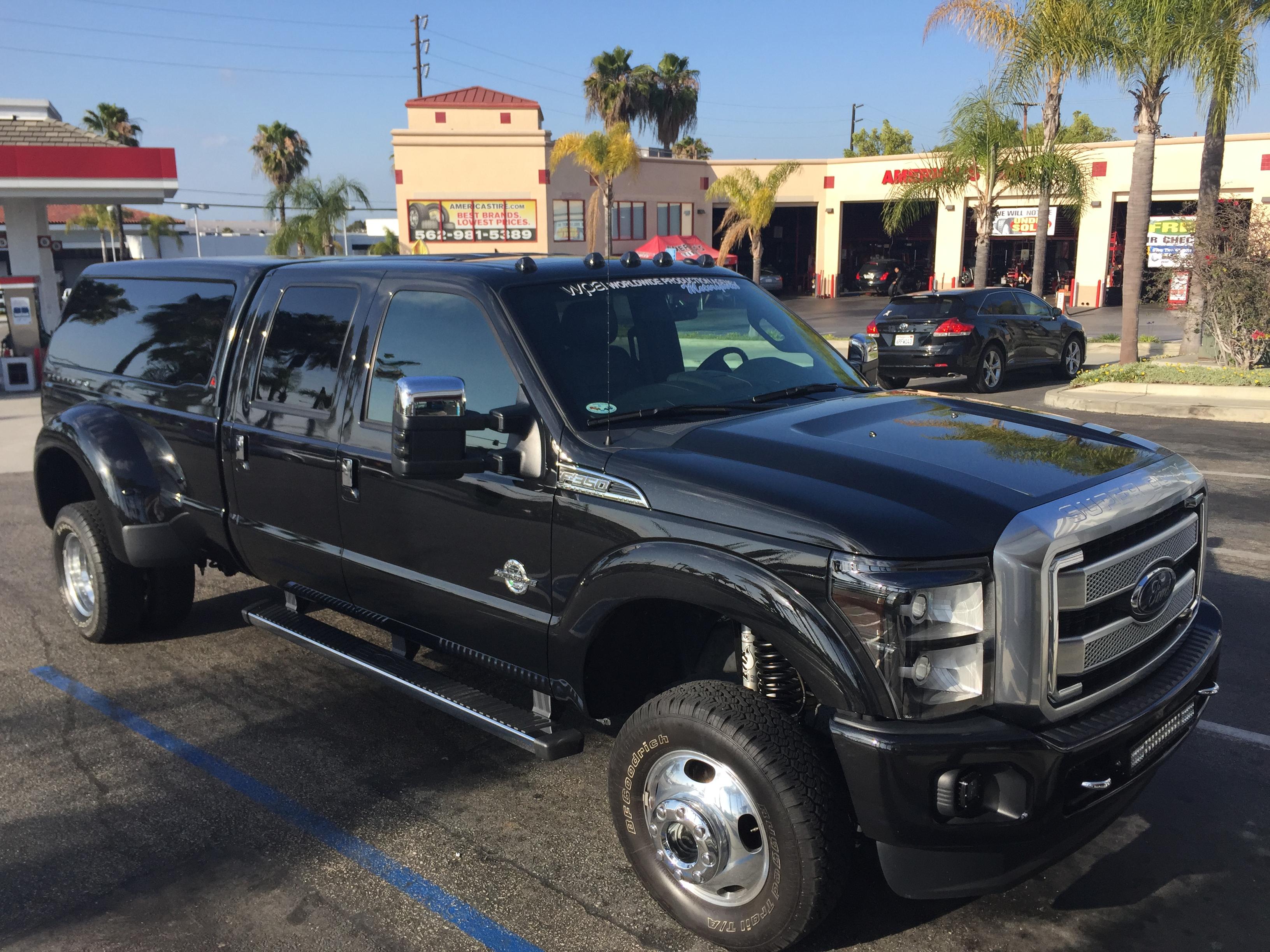

Does anyone have a picture of a tuxedo black truck with just the surround painted? Seeing that ebay part has me thinking it might look sharp paint matched on mine. . .

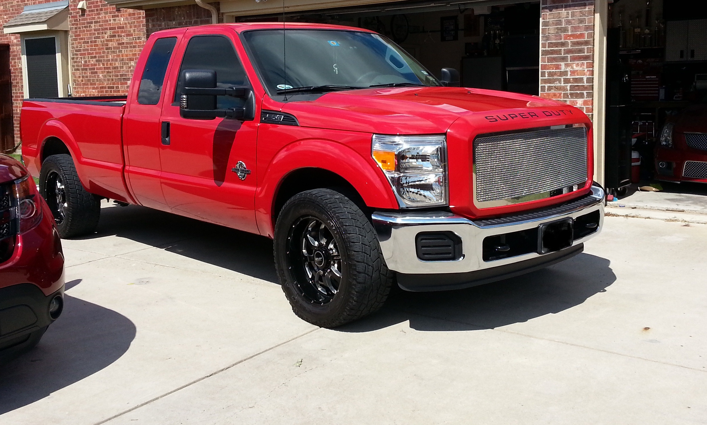

Has anyone painted the textured finish that the OEM XL trucks have on the grill? I tried to get mine done and the shop said you can't paint the textured plastic.
Yes, I did this on my work truck, I used the bulldog adhesive promoter, then primer, then sanded it. Repeated those steps 3 times, got it pretty smooth, then hit it with the paint. Turned out pretty good for me not knowing anything about paint.
That looks awesome!
