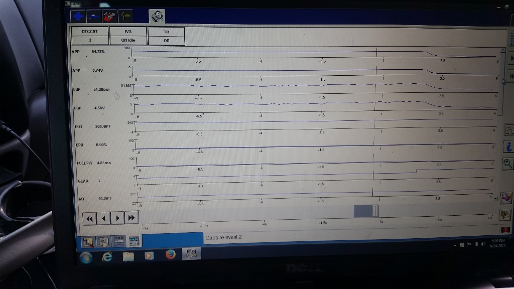

2 things so far. I was able to enter my tire size into IDS and it took, but haven't verified speedo yet. Also my map was reading -0.07. Plugged in a new and now it's .07.. Hmm
Loading up the IDS now and about to leave work

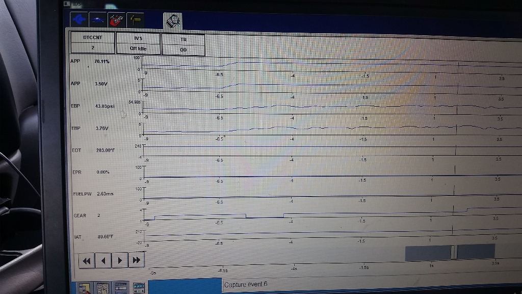

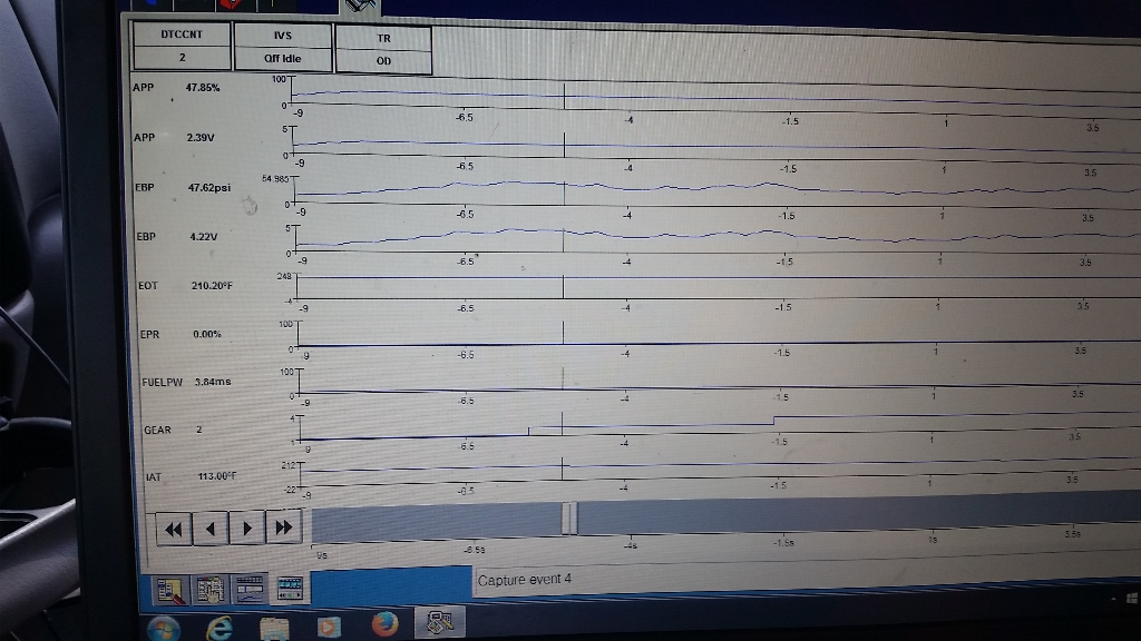

Yes. I just did it, I don't think the trans likes it though cause it winds up, hesitates a bit than there is 2 shudders than a chirp. Uploading some screen shots of some runs now

Stock tune
lincolnlocker
27,913
176
Central Michigan
thats cosher on a stock tune.. higher boost then stock but everything else looks good.. whats ebp at idle read?
and that chirp you are hearing, isn't the tires, its your trans screeming at you to stop... your chit is slipping..

Will check ebp soon, but it's a fairly new sensor and tube and I checked them 6 months ago.
I don't know I could be wrong, but I have beat on plenty of beat trucks with slipping trans and never heard a chirp

That last one puzzles me. Why is DC maxed. I'm assuming the tune is masking true ICP and I have to go off of volts? If so then how do I know what ICP truly is?
