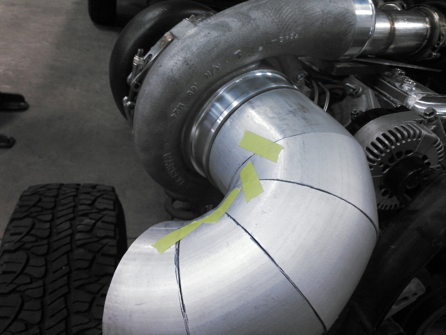

Mocking up the atmosphere turbo. Where it is in these pictures will most likely be how its mounted. Plenty of room between the turbo and hood. He mocked up an air filter pipe which looks like it'll work well. Itll be a challenge with the turbo drain. Hopefully there is enough angle to route it to the valve cover.

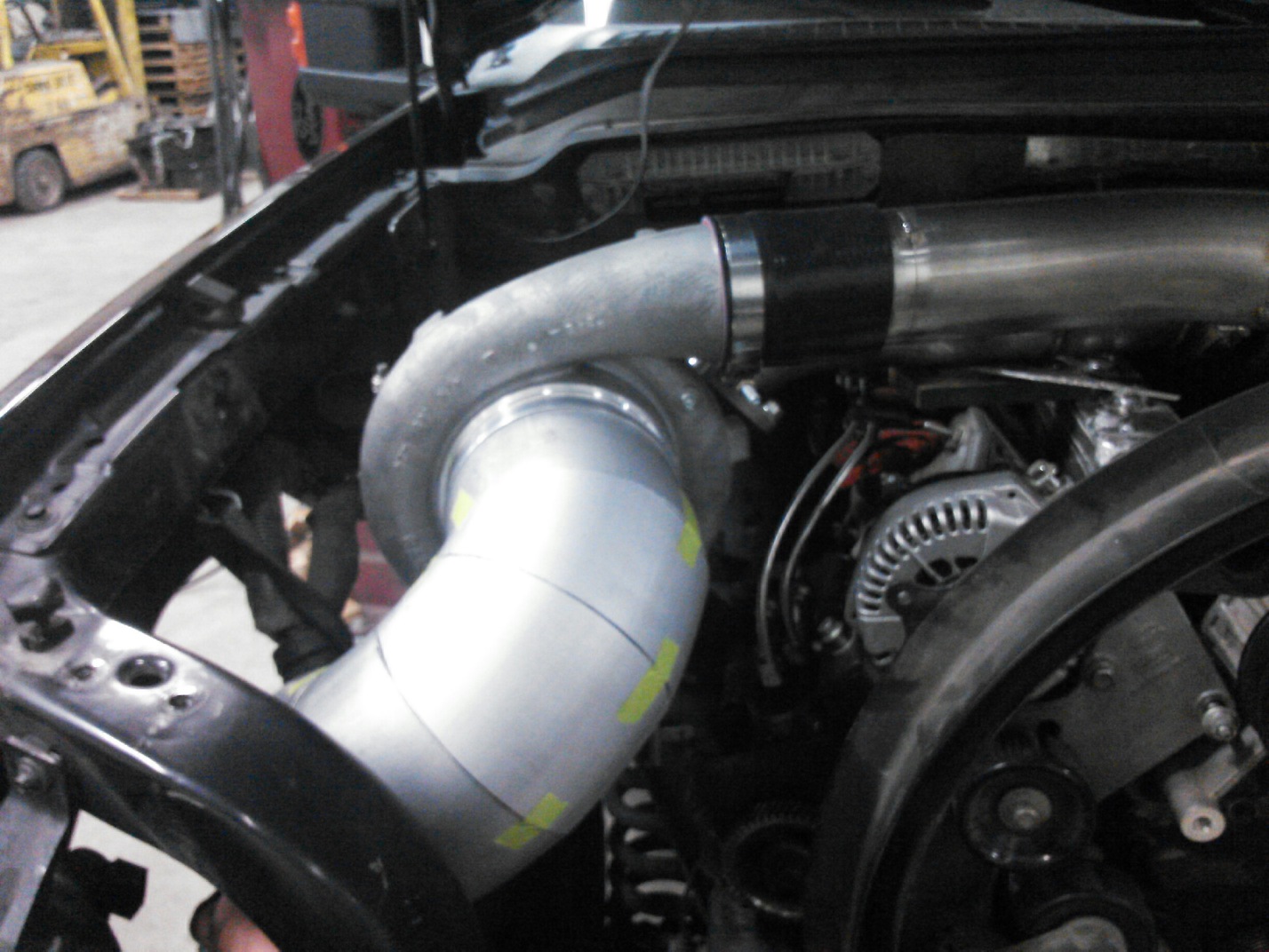

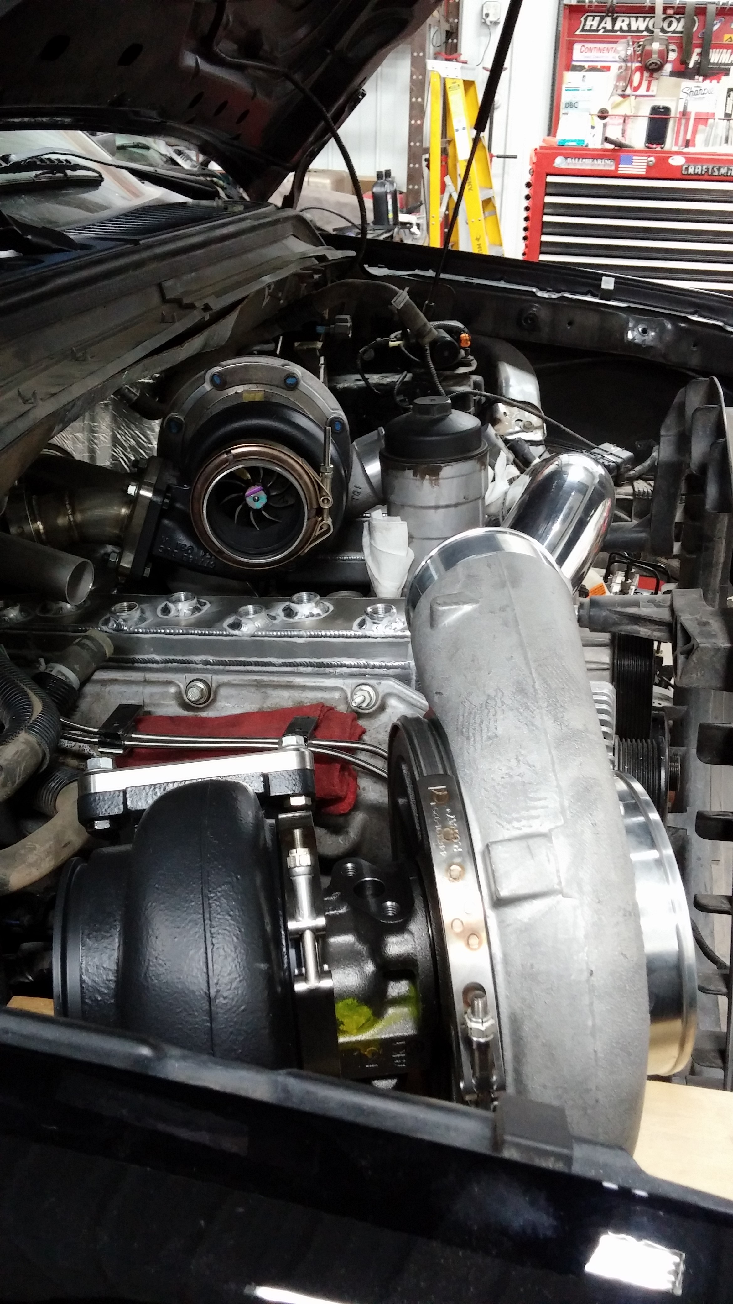

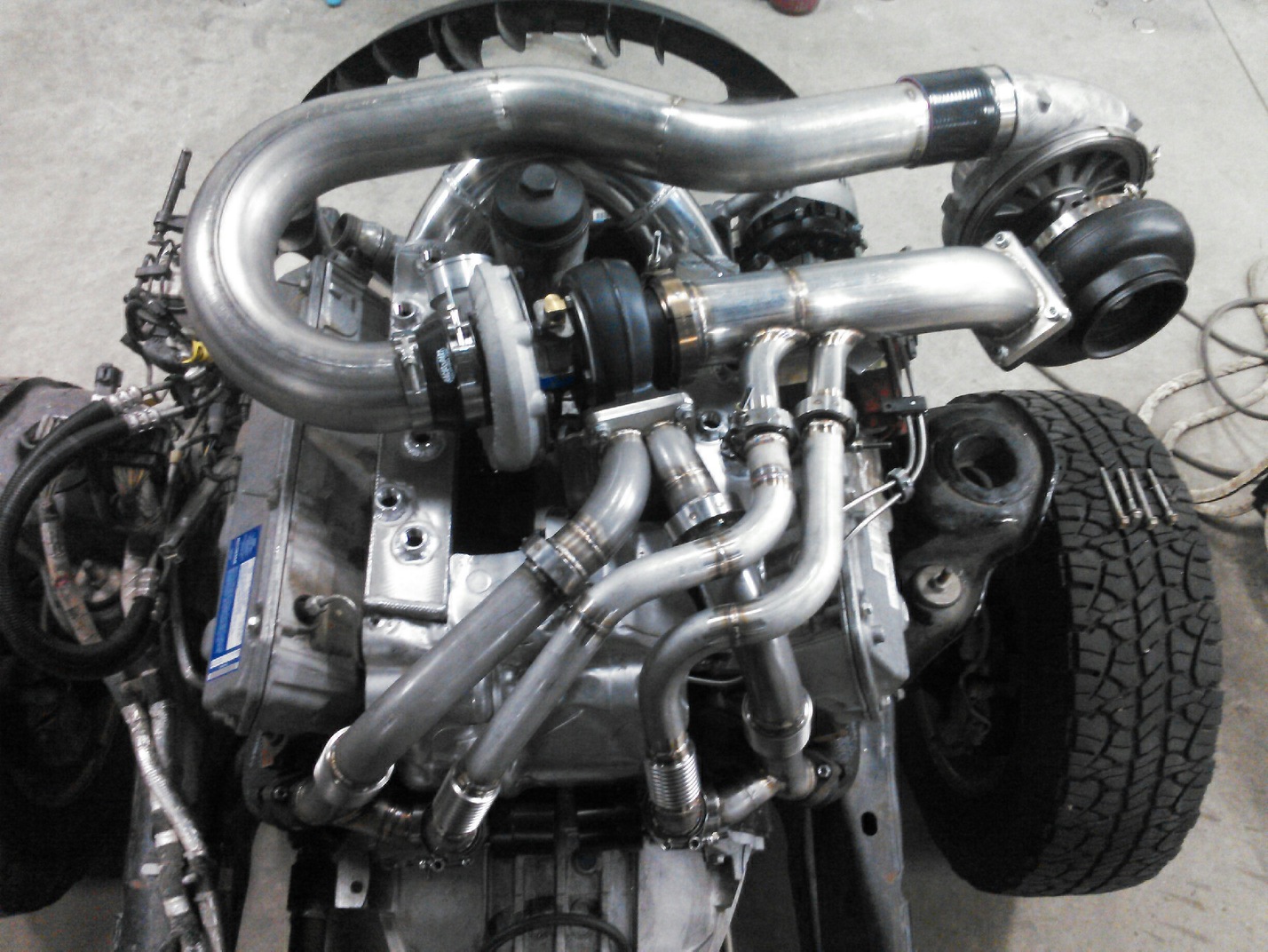

Havent made much progress in a while, a lot if suck builds going on at the shop. Here are some pictures

Clears without issue. You cant see it in the pictures but the cab is on the lift directly above the truck so he has been raising and lowering it as he goes. Heres a couple more pictures that were just sent to me. 6 inch intake piping fits nicely

I've seen nuclear power plants with less plumbing.....whoever is doing all of that is a h#ll of a fabricator.
