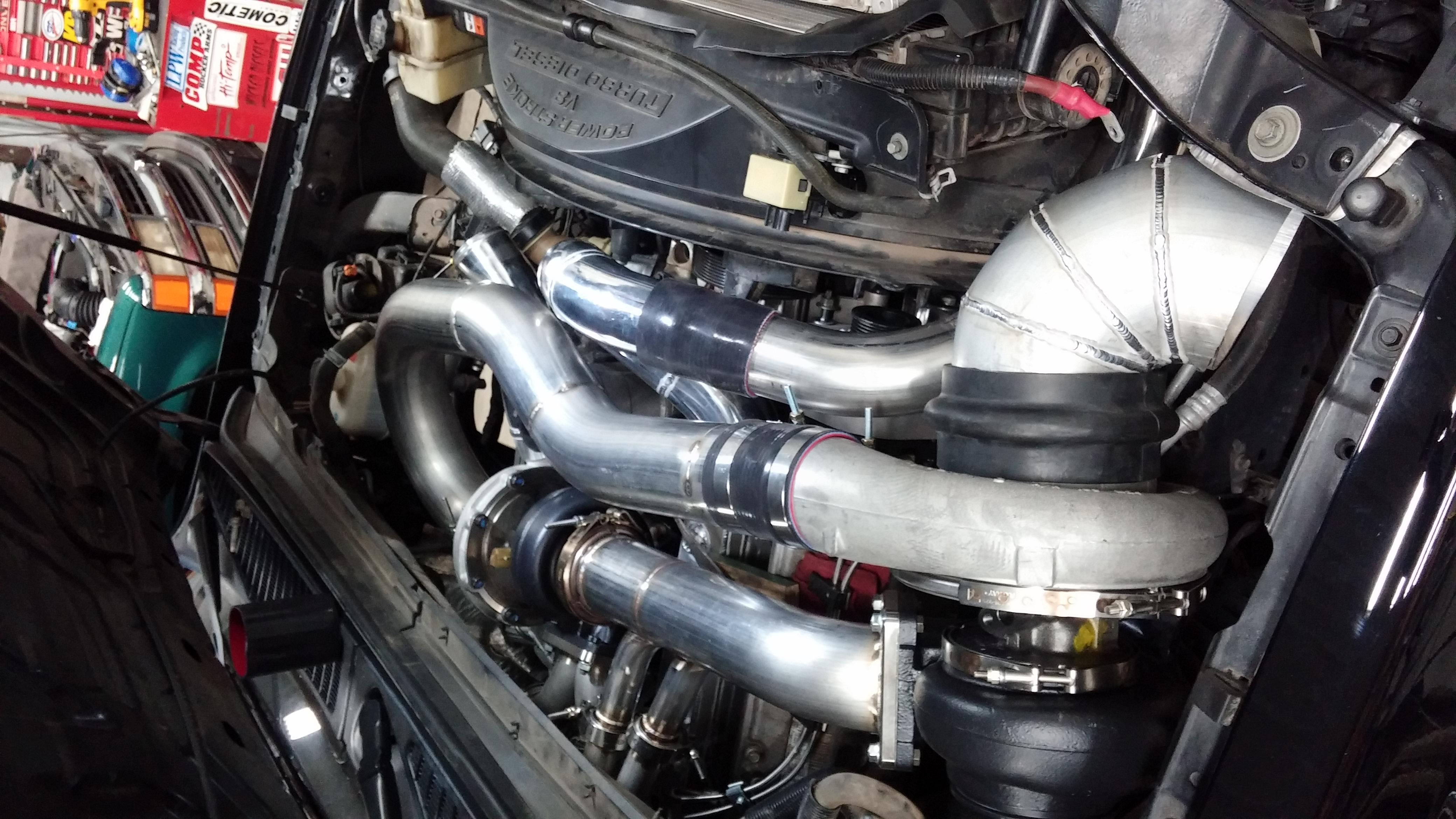

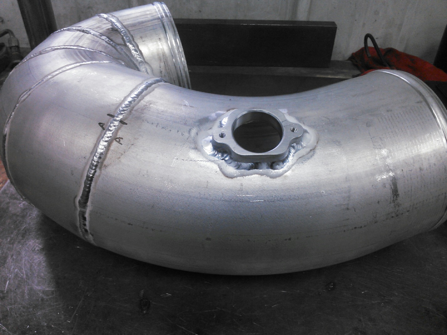

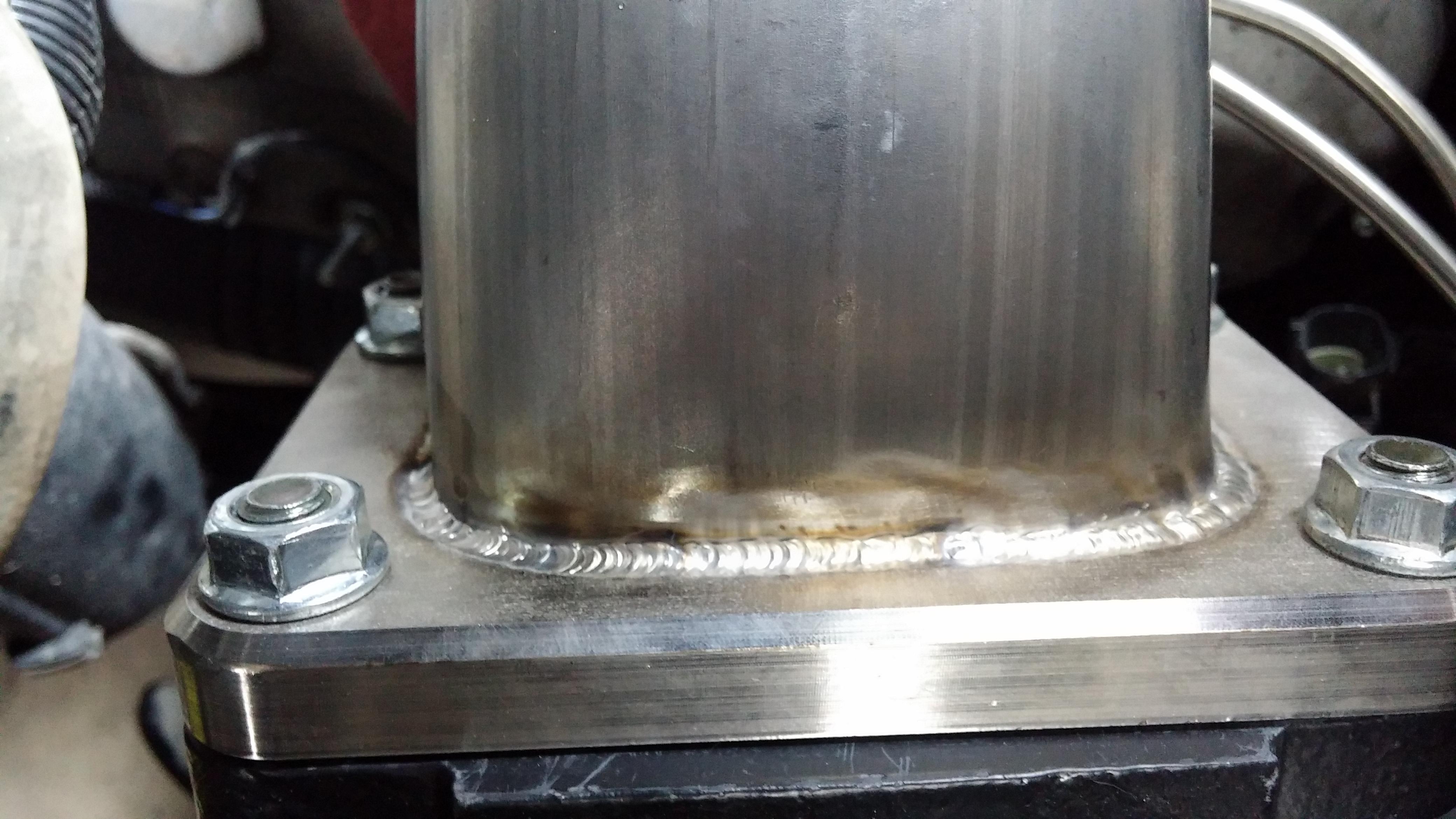

A little progress today. Most of the charge piping still needs final welding. 50mm gate to bypass the large charger needs to be fabbed. Not sure if it will even be needed but itll be there just in case. Still deciding on how to support the large turbo. Also decided today the factory power steering fluid reservior and degas bottle will be removed and replaced with a stainless set up where the driver side battery was. The stock modified hot charge pipe was cut in half, a v band was welded about half way up on the stock, and the top half will be custom.

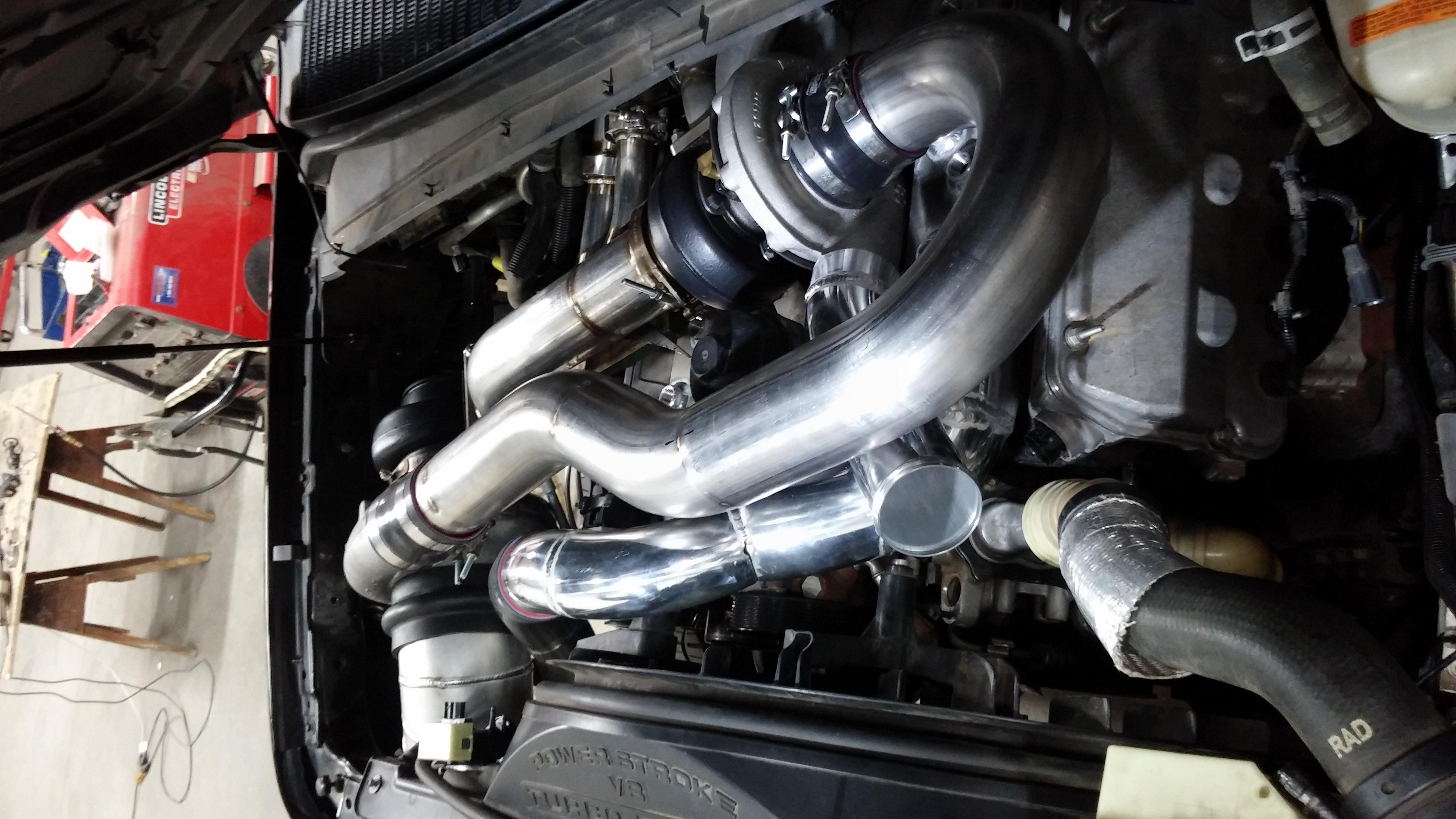

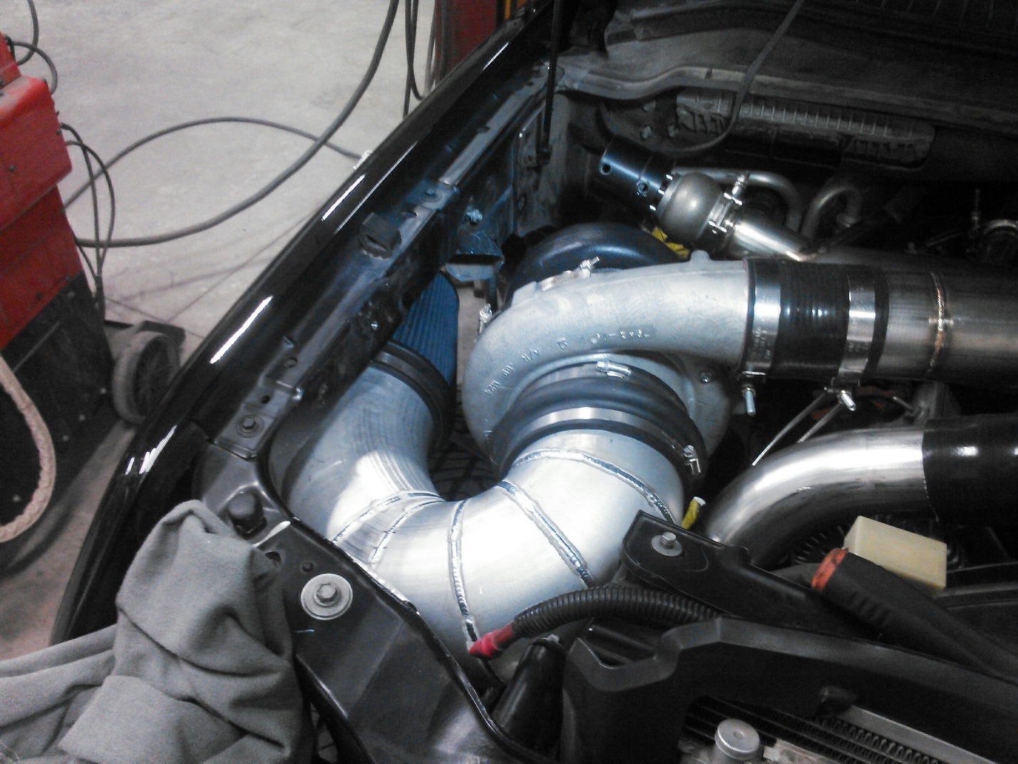

50mm gate, 6inch piping for intake fits!! Also the nice MAF piece supplied by blk350on20s, thanks again!!

Dont you want some sort of bellows on your high pressure exhaust to the low pressure, if you support the lp off the frame and not the engine... And are you supporting the uppipes in anyway?
madman1234509
Nov 20, 2011
2,669
mayfield, ny
Im not sure what you mean? No need for a bellow on the hot pipe that goes between the turbos. I believe the low pressure turbo is going to have some sort of bracing originating from extended manifold bolts, but im not positive. Also unsure what you mean about up pipes being supported? Never heard of them needing to be? They arent weight bearing, the small turbo is mounted on top of the engine, no weight on the up pipes.
StockCar#10
630
cheyenne,wyoming
Ok was meaning if you were supportig the lp from the frame wouudnt yu want a bellows.
And the I ment the other two wastegate pipes going to the hp exhaust pipe, they will have some flex with there length..
Sorry for the confusions
madman1234509
Nov 20, 2011
2,669
mayfield, ny
Haha no problem. No i dont think the atmosphere is going to be supported but the frame. As far as the waste gate plumbing, everything seems to be pretty solid, i dont think there will be any issues
