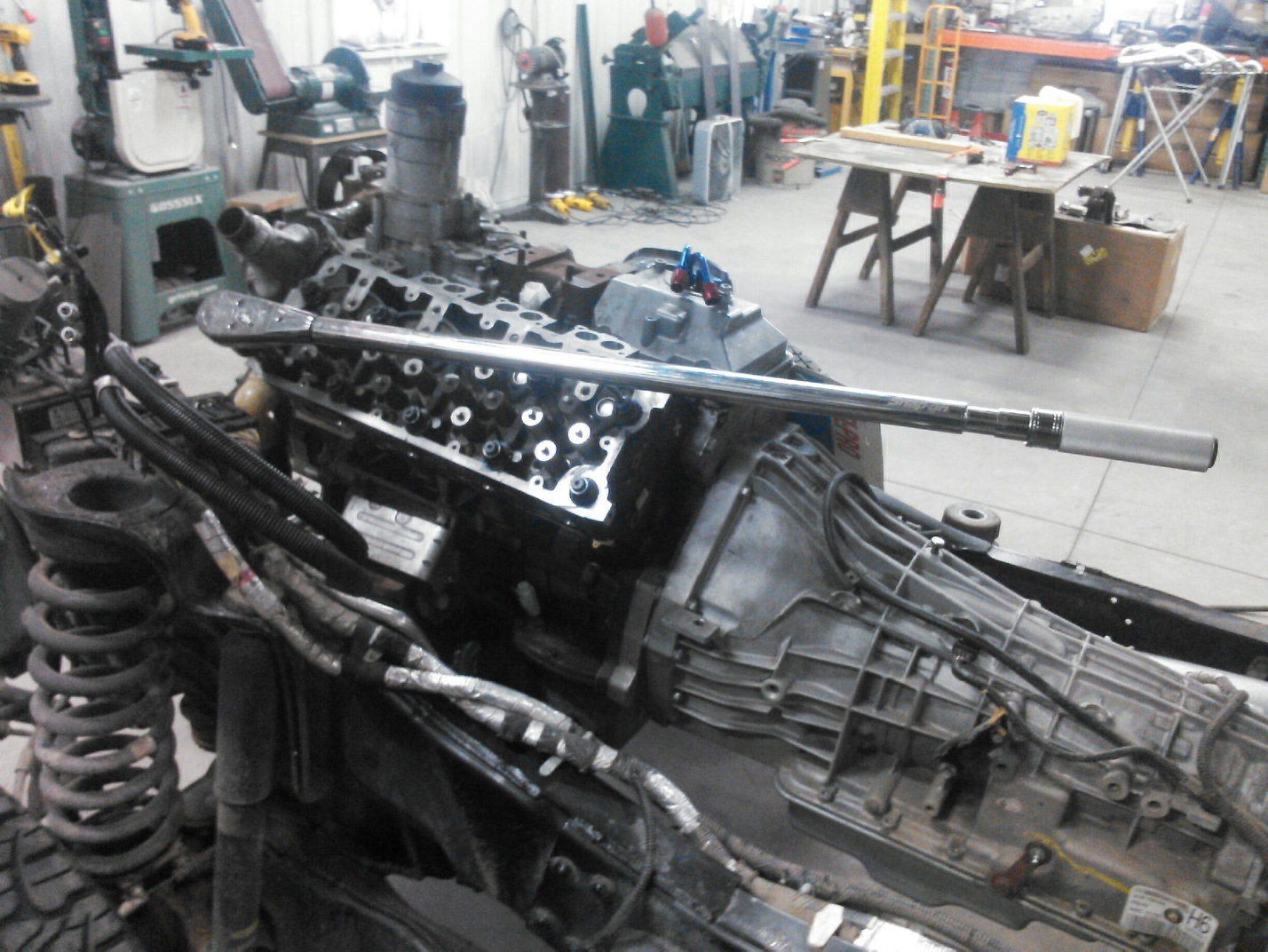

Port and polished, surfaced, no cracks, valve job and new springs.... Ready to go!

The porting was done by the guy doing the work on the truck. He took a ton of material out. The castings have a ton of imperfections and extra metal from casting.

Yea, its easier for the average consumer to understand stages with a lot of aftermarket parts. The average person would have no idea about cam specs if you rattled them off so they are just rated in stages. Like i said. The guy building the truck did it, not one of the big companies so I cant really rate it as a stage for you. A lot of extra and rough material was taken out though.... Also, I noticed the intake runners for the rear cylinders were way smaller than most of the others, just to add insult to a poor flowing manifold and cracking pistons.

Well, getting ready to put everything back on the heads.... Noticed every single push rod was slightly bent. Looks like Ill be surfing the web for the next little bit and ordering some up.
