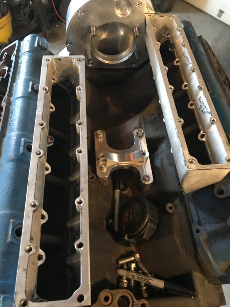

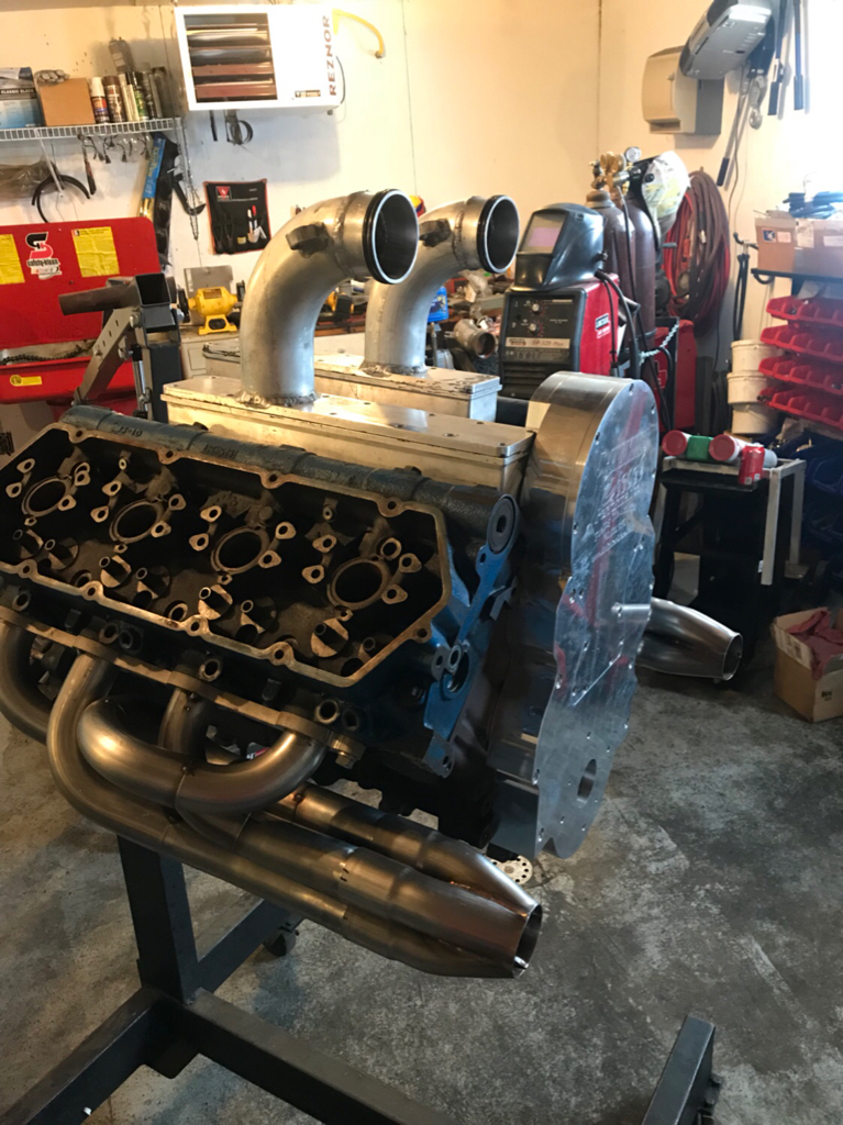

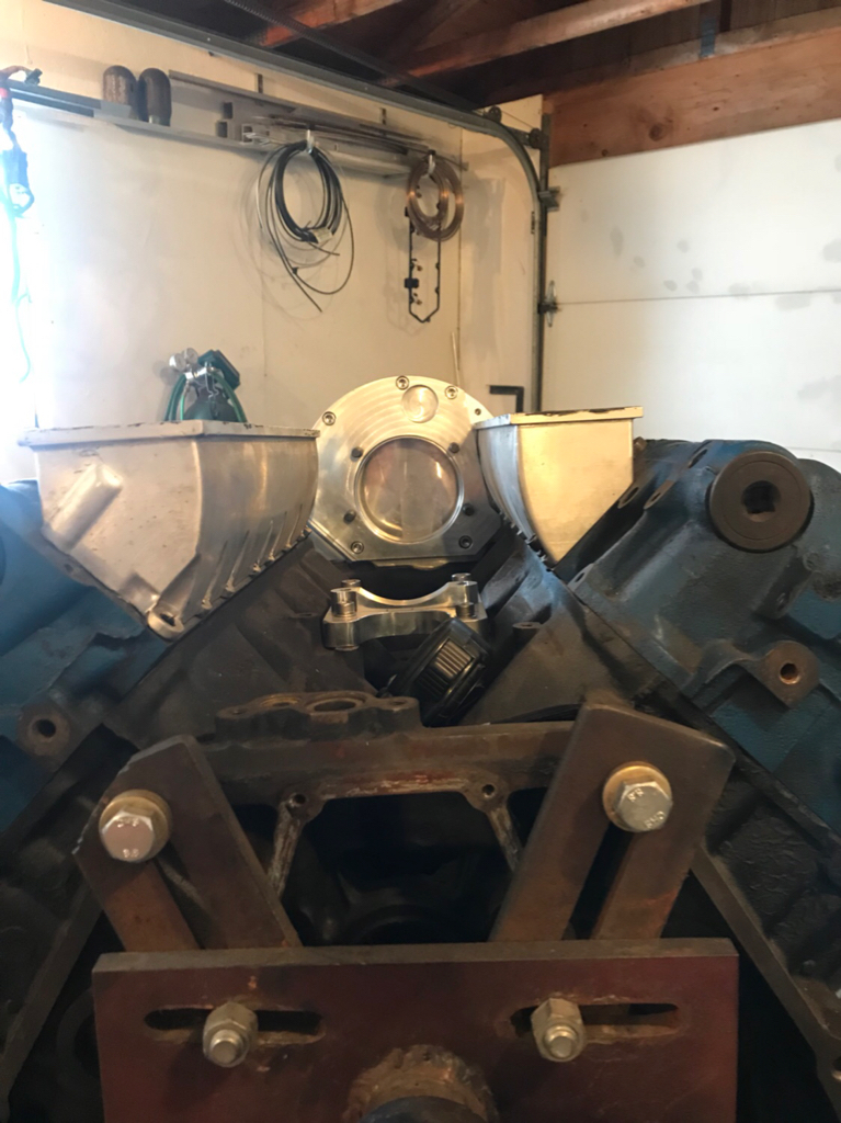

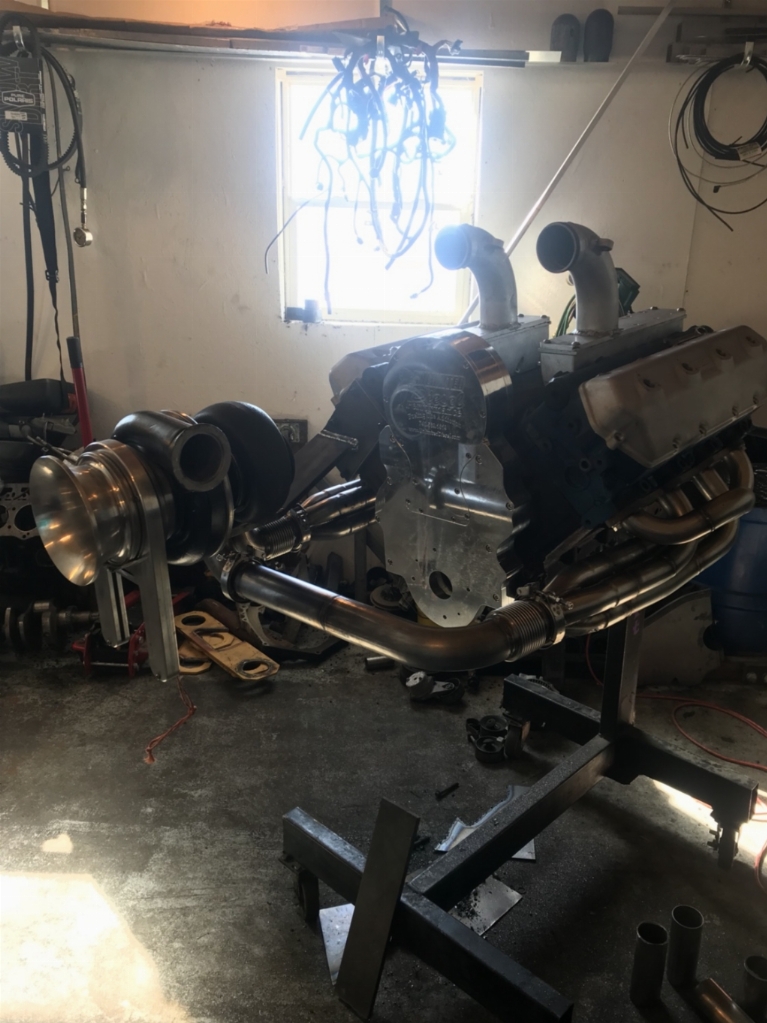

Well after not really touching this thing for a year and a half, I decided to get back at it. Finally got the headers done, about 12hrs per side to finish them out. Next is to fabricate the charger mount and piping.
