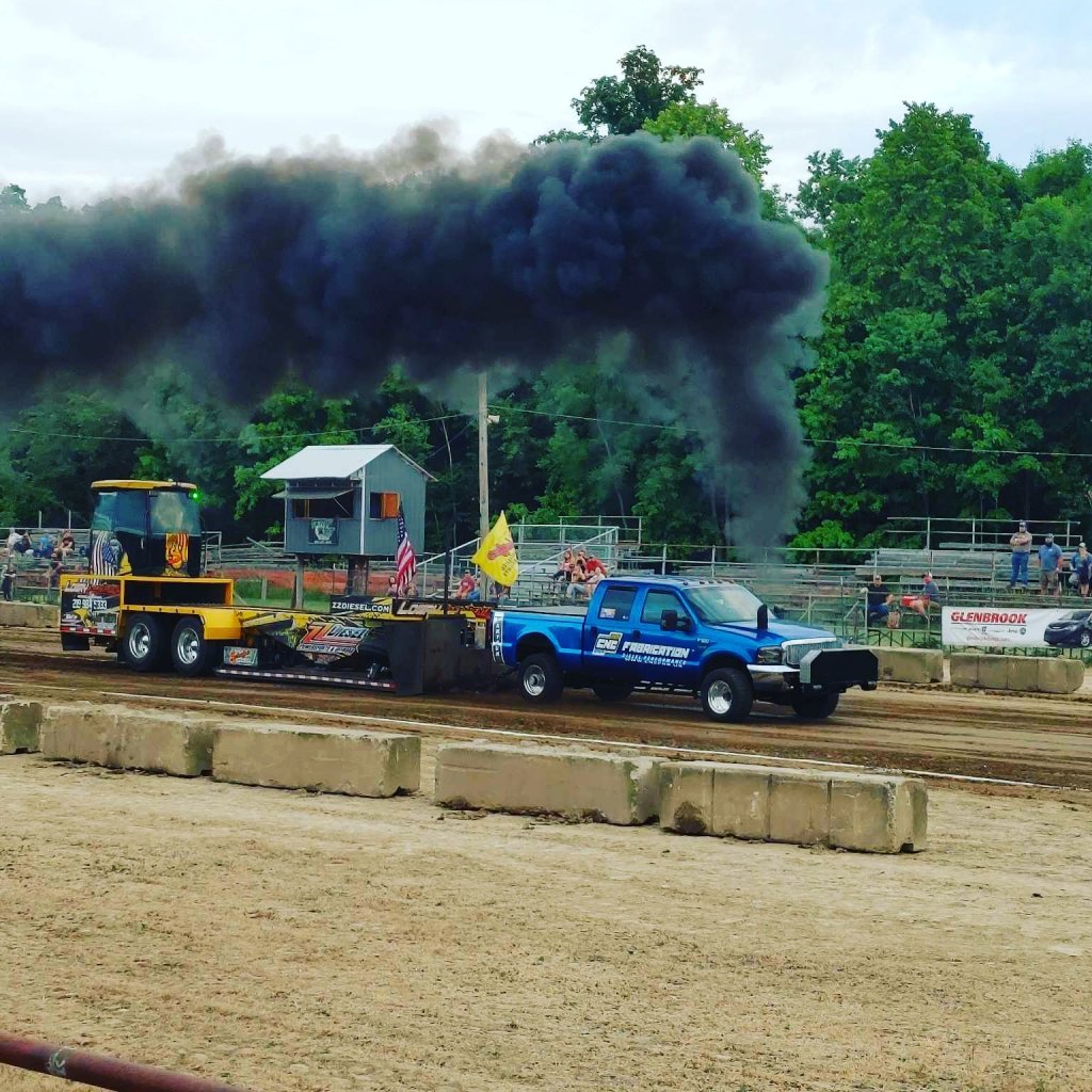

Here you go. 5th place out of 22 in open class. The truck is a running 2.6 class normally with no injectables. Truck in first ran NOS and compound chargers.
How much distance between 1st and 5th?
Looks like it's running good. A lot more power on the table if you had more air.

First place was way out front at 413ft, but as I mentioned he was spraying nitrous and had triple chargers in a well over 2000hp truck. 2nd through 5th was 10ft.
Ya, I'm well aware that 2.6 charger is too small, but the guys can be at a lot more local pulls and not have to travel all over the country. Plus there's a couple other nearby friends that they run with in the 2.6 class. This engine can easily be in the 1500hp with a 4.1 charger, but then the truck will need a lot more chassis upgrades....$$$$$. Lol.
