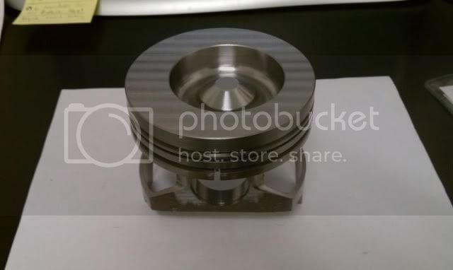

I'm sorry but the bowl isn't dead center! Does it matter ?
Anyone with the ability to design and make one with the bowl off center surely had a well researched reason, which I'm fairly confident has to do with where the fuel hits the bowl area. If you are worried about "balance", consider how many pistons have relief cuts for valve protrusion on one side.

Does it? Are you sure? Because we really want you to be perfectly at ease with the design from one of the foremost innovators and experts on 7.3 Powerstroke parts, and you really seemed to seriously question their design.
LOL !!!

Billet Steel pistons? How can they be lighter then aluminums?
Piston design. By designing a piston with weight only where it needs to be can come out to the same weight or lighter than an off the shelf production piston. The trick is to put material where it is needed and not where it is not needed. Compare the pictures earlier in this thread with each other and you'll see what I mean.
