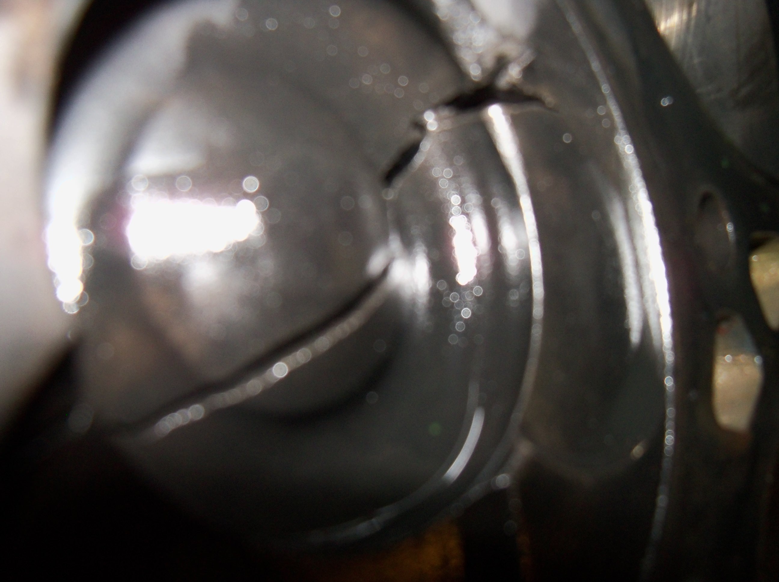

They crack in the bowl - and can ultimately torch through the crack and blow into the crankcase - sometimes they break up before that happens. Fuel bowl tweaks and design variations can all but eliminate that issue - but there are limits on what can be done with that design. By making a new piston - we can increase strength, improve its ability to stand up to high pressure injection, give it ability to hold up to higher cylinder pressures (within reason - other limits exist).
Plus best of all - if you have to ask - maybe you don't need em. :D
Lol you know I don't need them - I was more curious on more info, I can see the importance of bowl design changes period but wasn't sure if a monotherm was really needed in the 7.3 application material wise. I have always thought they were the way to go in the cr world however.

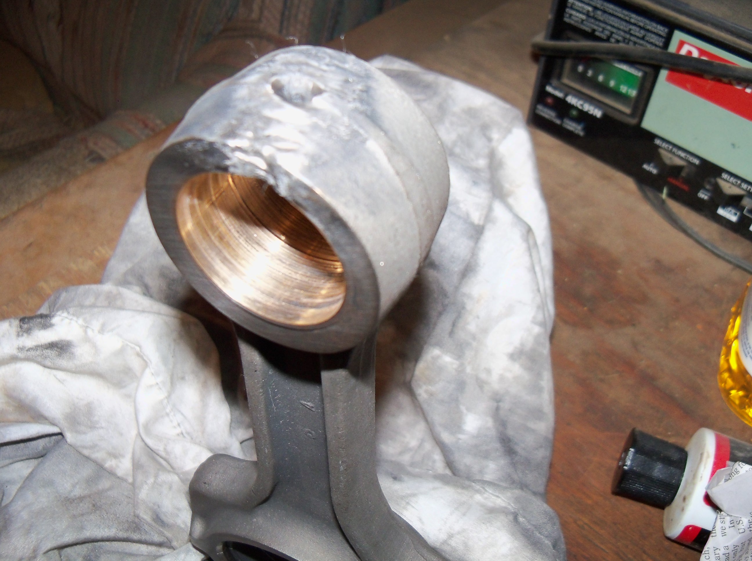

Does it? Are you sure? Because we really want you to be perfectly at ease with the design from one of the foremost innovators and experts on 7.3 Powerstroke parts, and you really seemed to seriously question their design.
I was just asking a question, because I didn't know. I was not expecting a 12 year old reply in return. Sorry for asking a question on a forum. I figured that was allowed in a place like this, guess not. I honesty thought everything was centered to spec. Saw the pic and asked.
