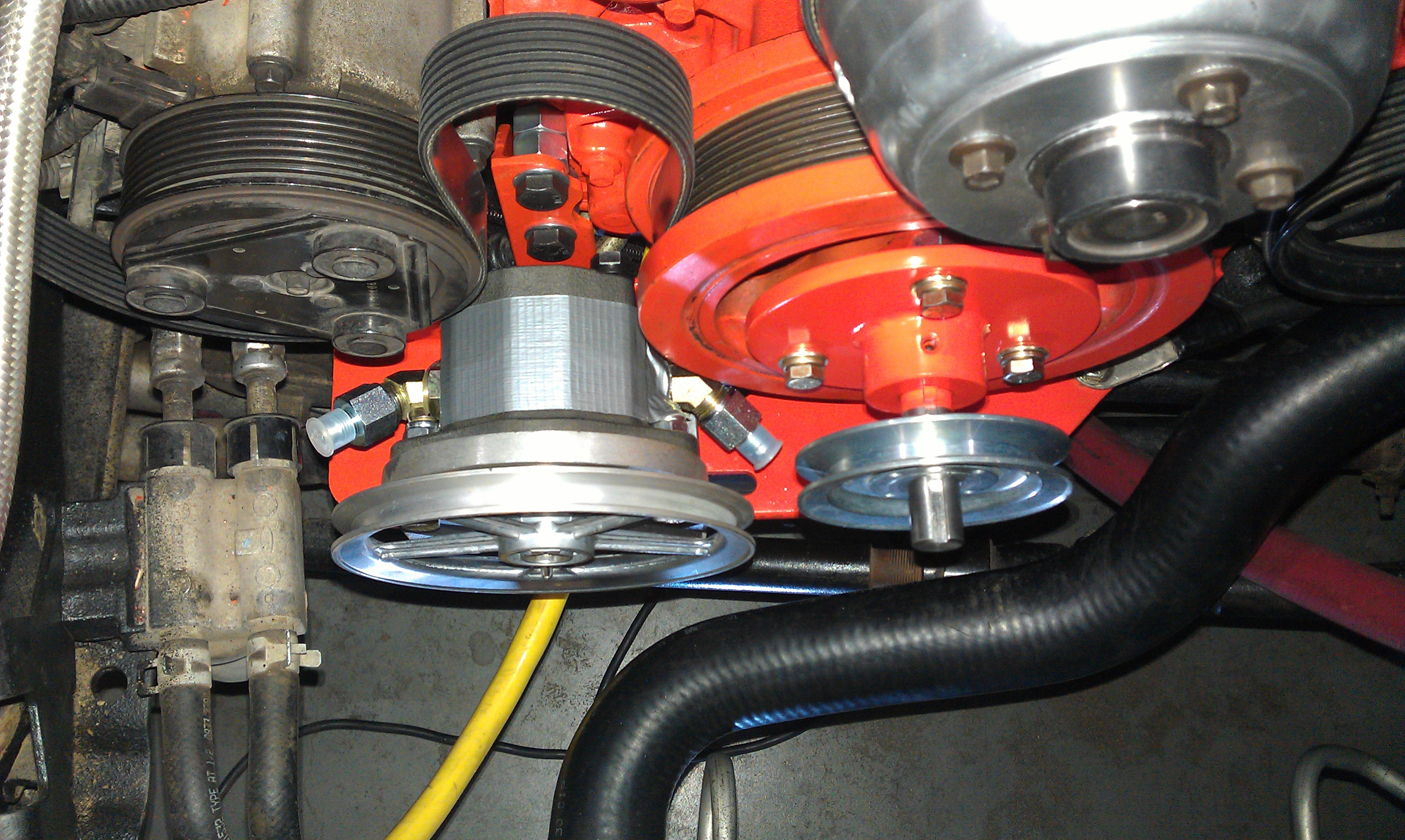

Finished the crank pulley, and pump mounting bracket for the second hpop.
And then I pulled the threads out of one of the holes on the stock dampener.
Holiday weekend...need a heli coil. Not gonna happen.
Oh...also changed the DAHL 200 2 micron filter...wasn't bad at all.

how the heck did you pull the threads on one of the holes for the dampener? Hopefully the flex-a-lite fans work out good for ya Ivan...so far so good for me.
Extended Power
May 24, 2011
2,216
The first time i inserted the bolt, it was tight...so I chased the threads out with a new tap.
(paint inside the threaded hole)
The second time I tried the bolt, all the threads were wrapped around the bolt when i pulled the pulley off to shorten up the pulley shaft.
Not too big of a deal...but I really don't wanna pull the balancer off again, as it such a pita to torque up...and I used the bar that I used to hold the engine from turning over for some of the new brackets.

Heli coil installed on balancer, as well I got the second hpop mounted up.
Get a couple of belts for it tomorrow.
Waiting on an inspection camera and injectors...ehem......waiting on injectors....:poke:

Badass Ivan, Jess got mine friday too, i need my truck running! :cursing:
