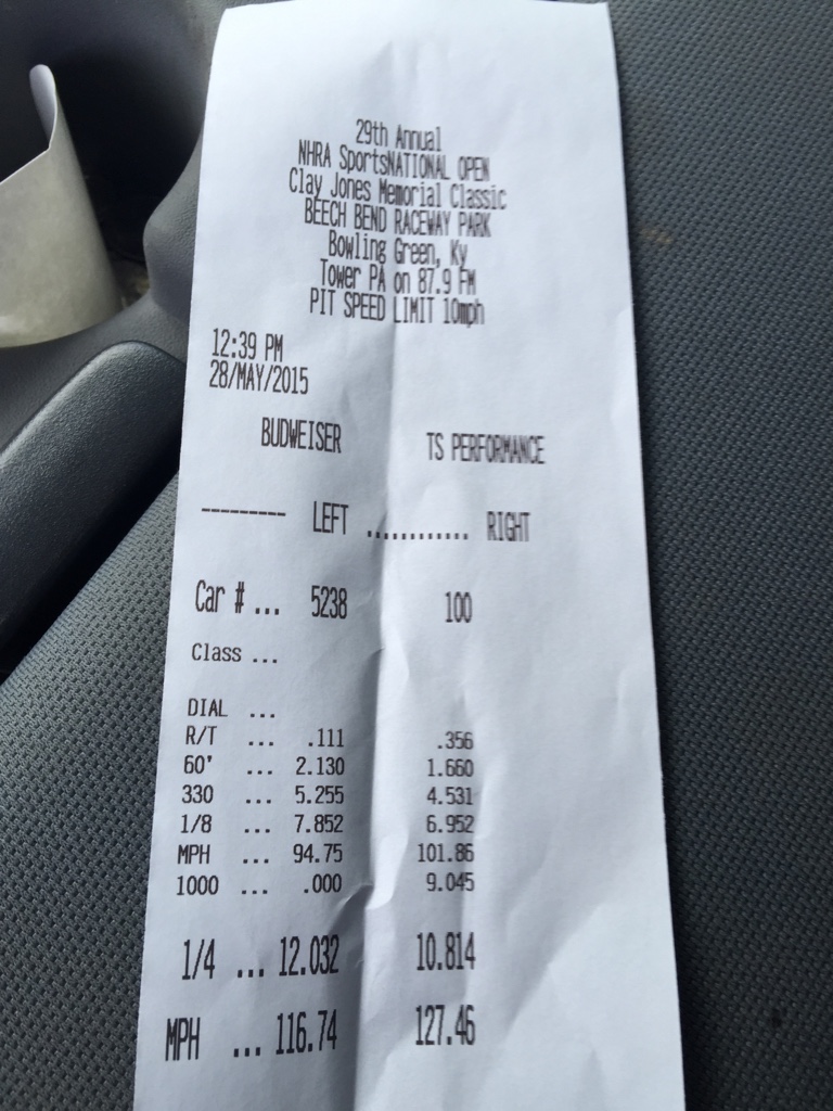

Well we made it to TS.
Added 3.73's and dual pumps. The new 66 is on and boy does it flat work. Spools better than the 66 and doesn't seem to give up any power.
Got it all laded up and headed down Wednesday.
Made a fuel run...
Made a pass on one stage...
Truck is flat out getting it!
I couldn't be happier for stock appearing turbo, dual pumps and built 6r... All on a stock lift pump! Very fun and simple setup.
