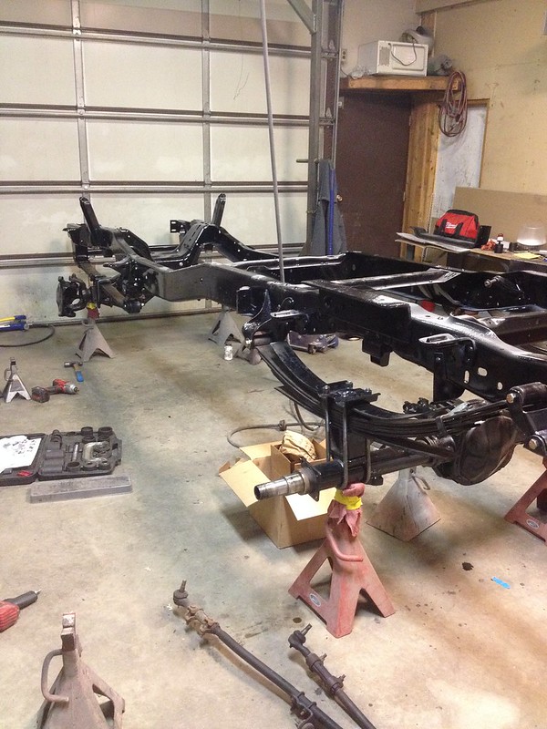

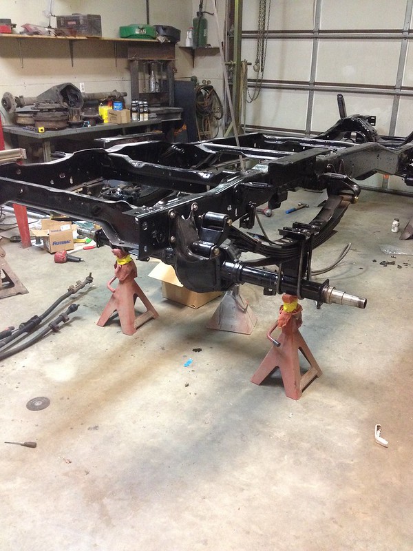

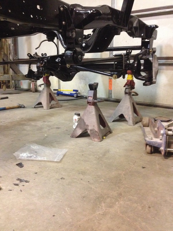

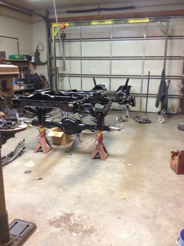

Finally some more progress after the holiday.
Got the axles all installed and mounted to the frame yesterday with new leaf spring bushings, trac bar bushings, u bolts and ball joints. New spicer drive shaft u joints, axle seals, spindles, bearings, etc. are up next. Got my BDP sump in yesterday. Today will be working on traction bar mounts and making the brackets on the plasma table for a rear disc brake conversion.

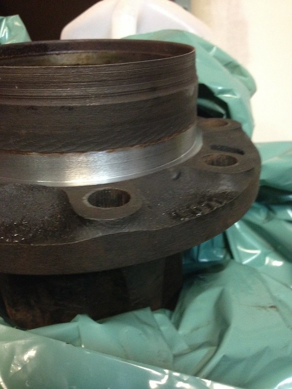

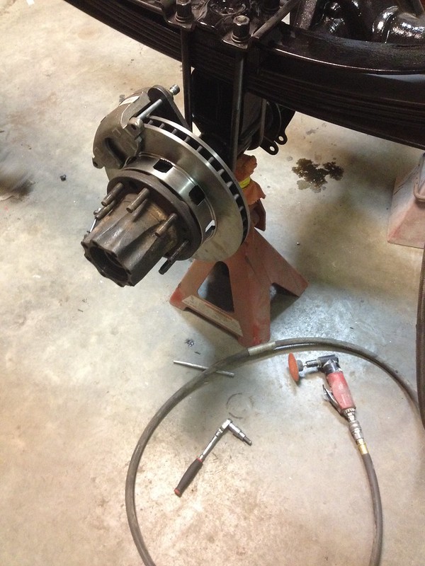

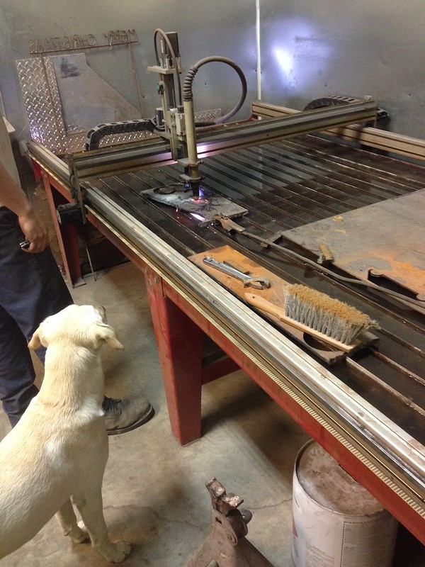

Spent today putting new axle shaft u joints in and assembling the front axle some more and working on making everything for the rear disc conversion. Mock up is pretty much completely done, still needs some tweaking though.
Started by putting the hubs on the lathe and turning down the small lip on the back side of the hub so that the rotor would sit down flush with the stud holes

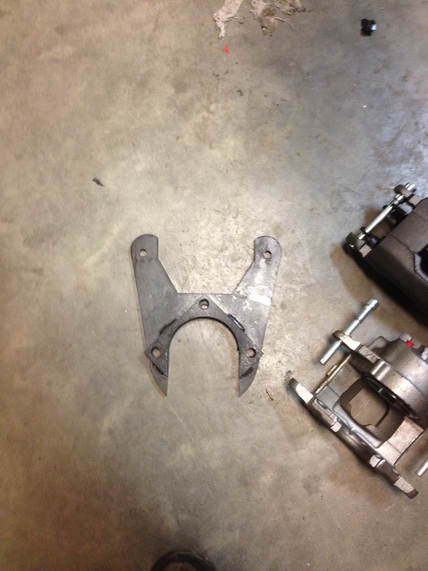

Went with front rotors off an 86 K20 as well as front single 2 15/16 piston calipers from the same truck
Cutting out he caliper brackets and spacers
Mock up bracket
Matt_P
1,375
Lima, OH
You have pretty amazing skills to machine your own parts.:thumbup:
Thanks! That plasma table makes it very easy to make your own parts. I cant take all the credit though, my buddy who owns the shop worked with me all day yesterday too making it and already had a design for a disc conversion for a gm 14 bolt that we worked off of and modified
Wow I want the rear disc conversion. Would you be interested in making the brackets for people?
Sent from my Pear phone 5 using Tapatalk
Yeah we talked about that and we would be interested in making them when its all finished, we would just have to figure out pricing. The only thing though is you would have to get the lip of the hubs turned down by anyone with a lathe, unless you wanted to ship those here first.
