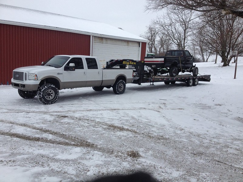

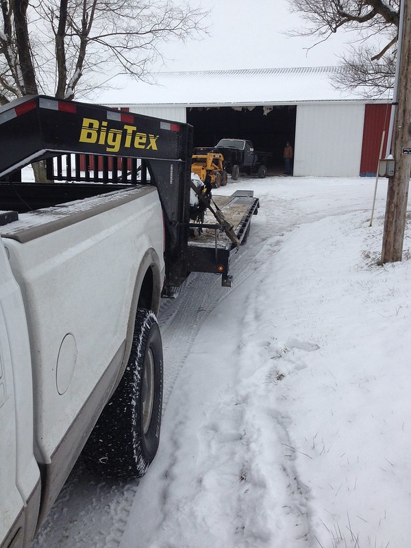

I also went down to Jason's (Hotrodtractor) today and picked up the 86 and brought it to the shop

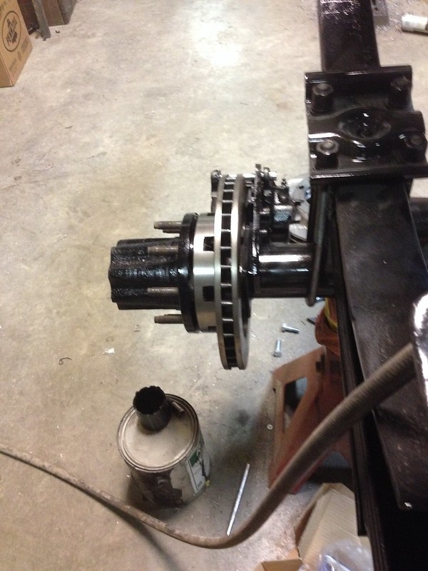

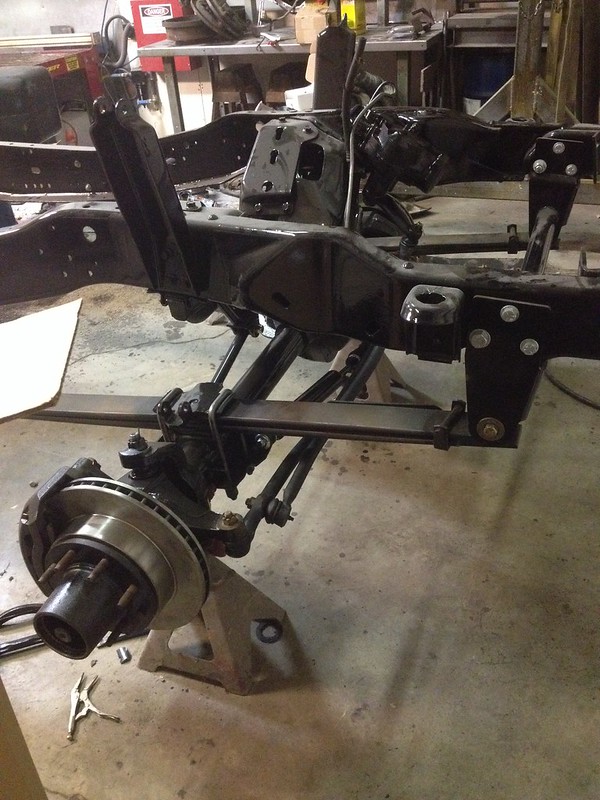

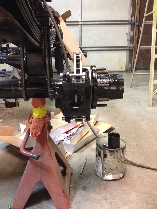

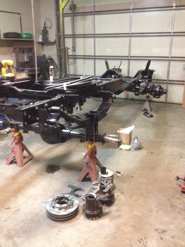

Unfortunately I havent had a lot of time to work on the truck lately, but I made a little more progress and am at a stand still now for the most part. Im waiting on my Destroked adapter plate, auto world engine mounts and Valair Clutch to arrive which should be here in a week or so.

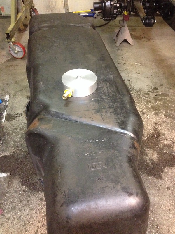

All the steering and gearbox is on now so the front end is done. I just have to paint all brackets and hubs for the rear and reassemble. I got the tank in and BDP sump installed. Still need to install the brake lines. Then its time to put the drivetrain in.

All that 1/2" cloth line sitting on my frame is to make my own fuel system with a fuel lab pump and regulator.
