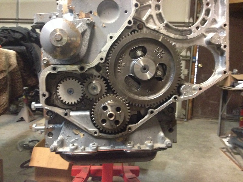

Made some more progress today:
Cam retainer and new oil pump installed:

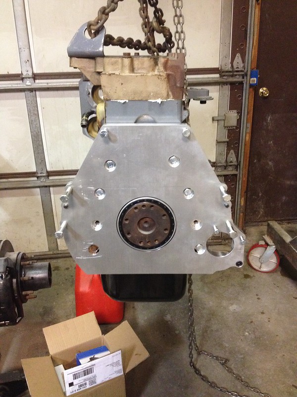

Destroked adapter plate installed

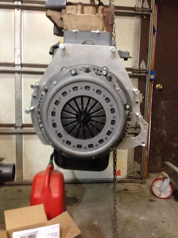

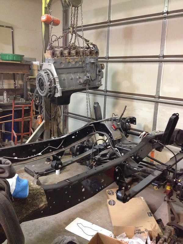

Flywheel and clutch installed
Engine in the air

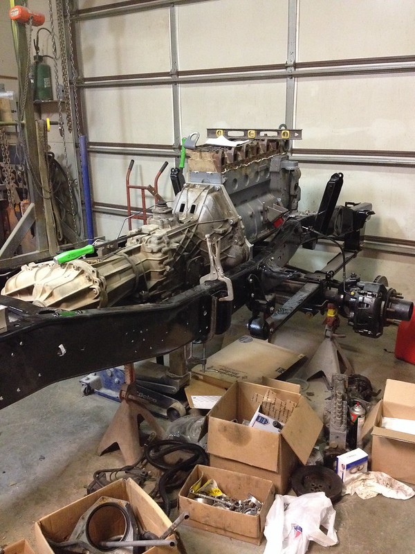

Drivetrain in the air

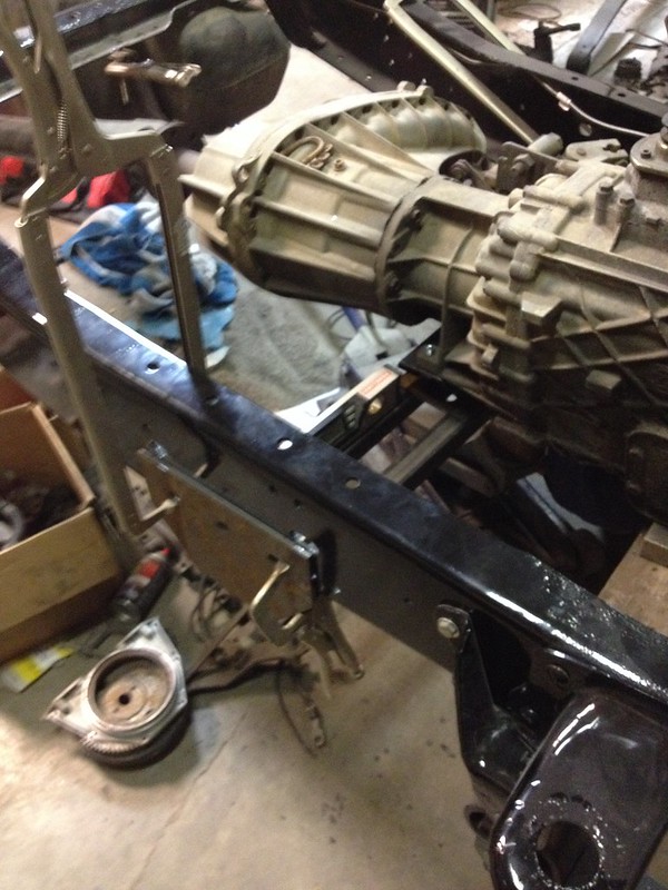

Drivetrain in
Im gonna go ahead and make a whole new crossmember out of round tube and then I can get the driveline angle down 3 degrees and get the drivetrain centered perfect. Then get the rear driveshaft shortened and the front lengthened. Dont mind how nasty everything looks right now, everything is just getting mocked up and then it will all be torn back down and painted.

No really exciting updates right now. Just got the drive train situated perfectly in the truck as far as driveline angles and sitting within 1 degree of level side to side. Monday will be building the new crossmember.

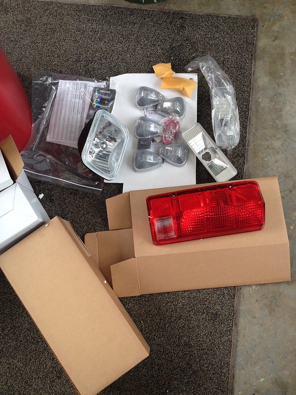

All new lights for the truck did show up though

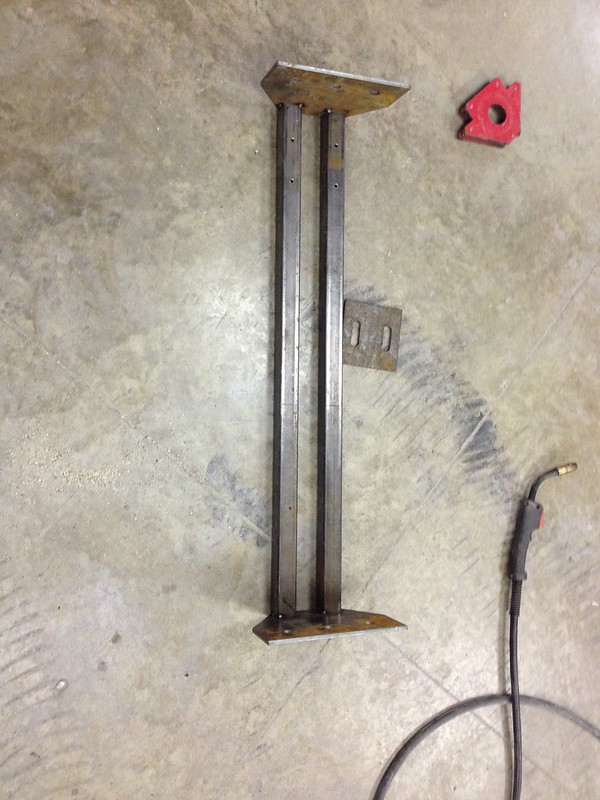

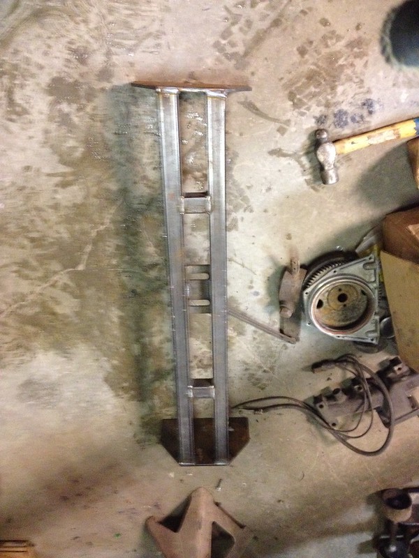

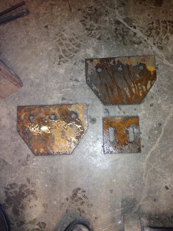

My buddy and I got the new crossmember built today. Im really happy with how it turned out.
Plates cut out on the plasma table
Square tubing tacked in
Getting the fitment right
Finished Product

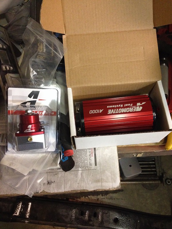

My A-1000 and regulator should be here tomorrow so I can start building the fuel system

Picked up my aeromotive A1000 tonight and regulator. Just need to get filter bases and fittings and start building the fuel system next week

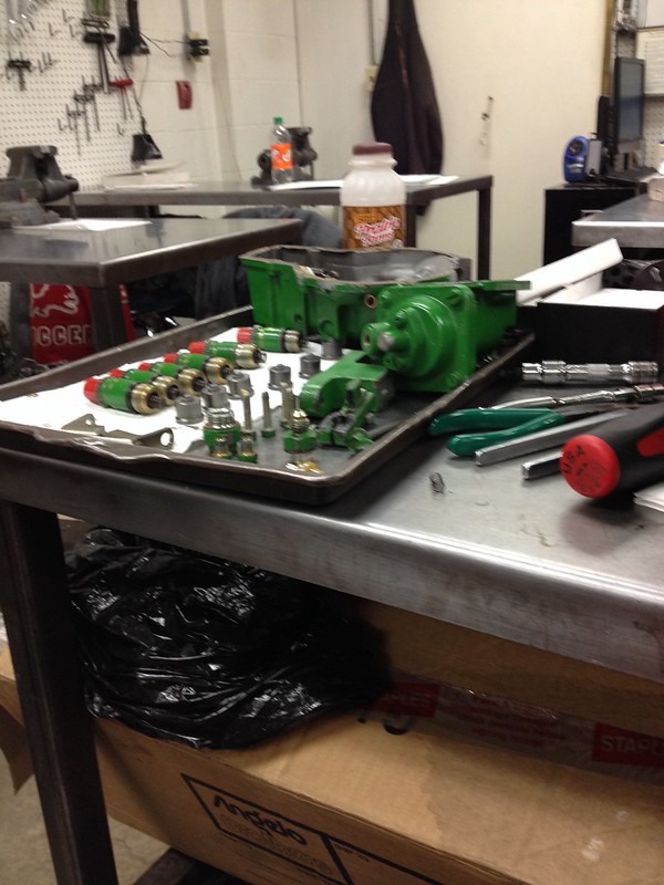

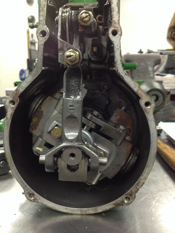

Did some work on the p pump today. The guy I bought the pump from failed to mention that a mixture of coolant and oil went through the governor housing so it was a little bit of a mess. So today I pulled off the governor housing cover and cleaned out the fuel side of the pump as well. I also installed the 191 delivery valves that I traded for the full cuts that were in the pump.
Before cleaning
Cleaned up
Dont mind the ugly green paint, that will be coming off very soon
