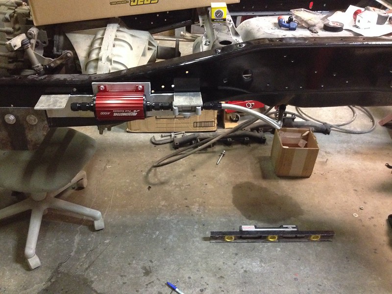

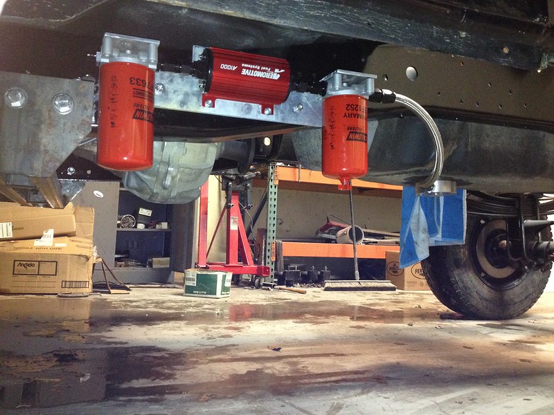

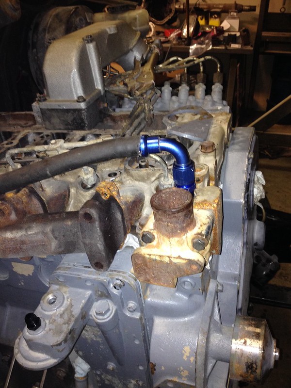

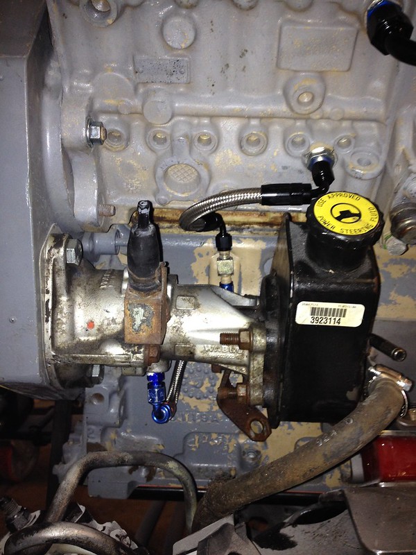

Built the mount for my fuel system out of 1/4" aluminum, it will be polished. Im still waiting on one filter base to show up so that kind of has me held up at the moment. But I have that mounted and the -10 line made from the sump to the water seperator. Im gonna wait to make the rest of the supply line and return lines once the cab is on next week. I also built the oil supply lines for the vacuum pump and p pump

I got the last couple fittings I need today for the fuel system. My other filter base is still MIA with ups. My 5x.012 injectors should be here tomorrow and as soon as I hear back Ill have my S363/68/.91 on the way

That pump filter setup looks great and is clean, may have to redo mine to something similar.
love this obs project btw :thumbup:

Thank you! Im really happy with the way the mount came out, itll look even better when its polished up

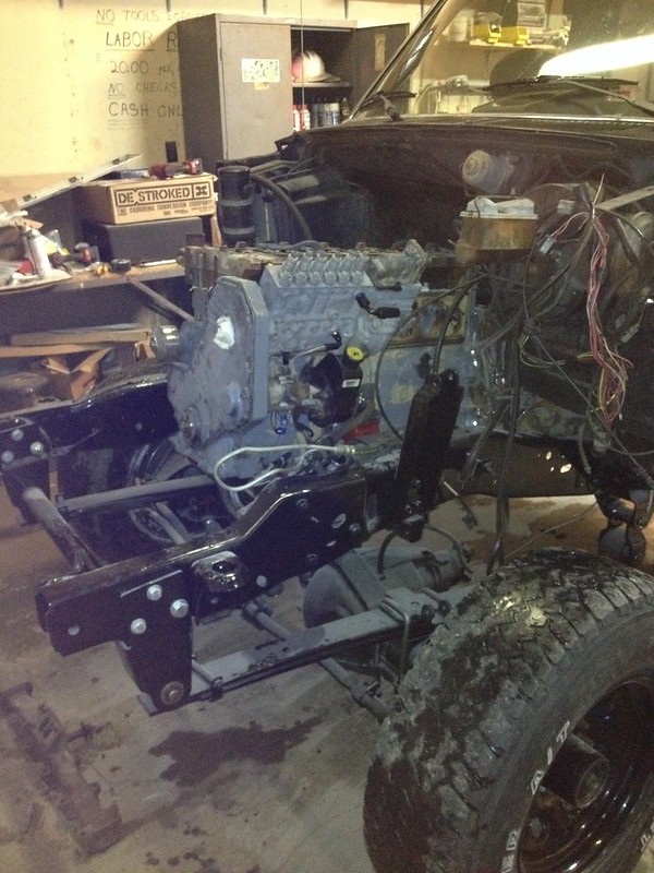

Made some good progress today:
Got the truck back on 4 tires
Then Rolled it outside
Grabbed the 150 frame and brought it inside
Cab ready to pull
Cab off
Cab on the 350 frame
Plenty of firewall clearance
Got a little more done on the fuel system, now that the cab is on I can finish the plumbing and get the holes drilled for the filter bases on the mount

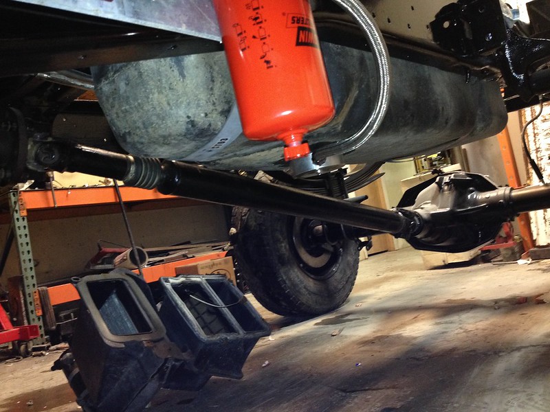

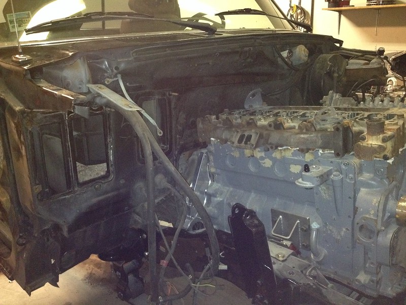

Pulled out the heater box, since Im gonna run one with no AC so it will look a little cleaner and Ill have better clearance for the turbo since I dont want to use the industrial manifold I have
Also got my driveshafts back today

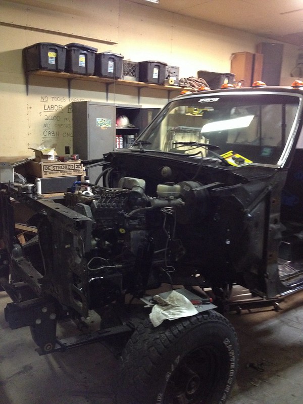

Little more progress.

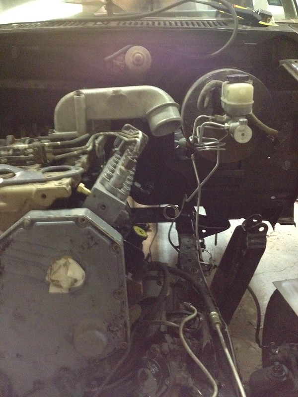

Cab pretty much completely stripped
7.3 powerstroke brake booster and master cylinder installed for mockup with new stainless steel brake lines. Just need to modify the lines for the rear brakes to attach to the manual adjusting proportioning valve
Powersteering lines done:

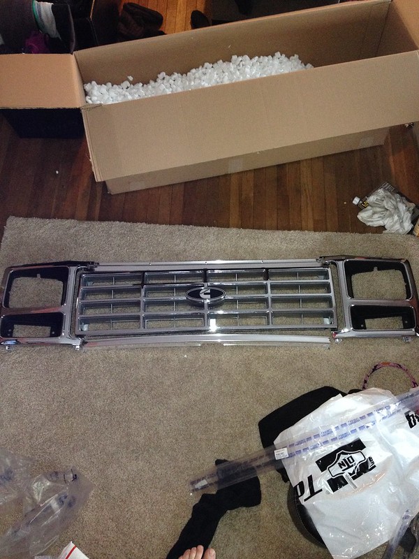

All new chrome for the front with the custom billet badge
