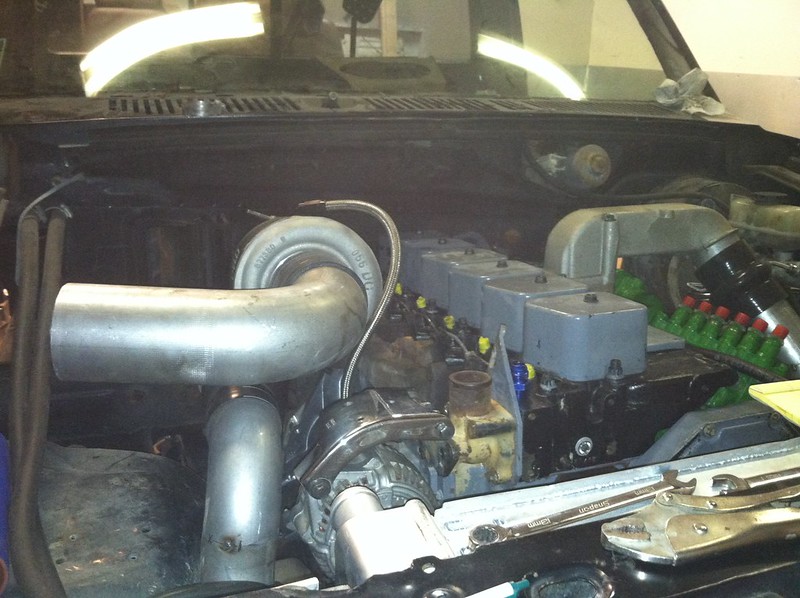

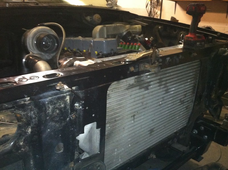

Well I had a bunch of pictures to post of progress from today but my stupid ass just put my work clothes in the wash, while I was smart enough to remove my wallet, keys and knife prior to washing I failed to remember to take my phone out of my lower pocket so it recieved a nice rinse cycle. Im an idiot.
Got the intercooler and radiator mounted up and the core support installed again, pass fender installed. Mounted the fuel pressure regulator and ran the rest of the lines. Got my new head torqued down and everything put back on the engine. Also got the top alternator mount built.

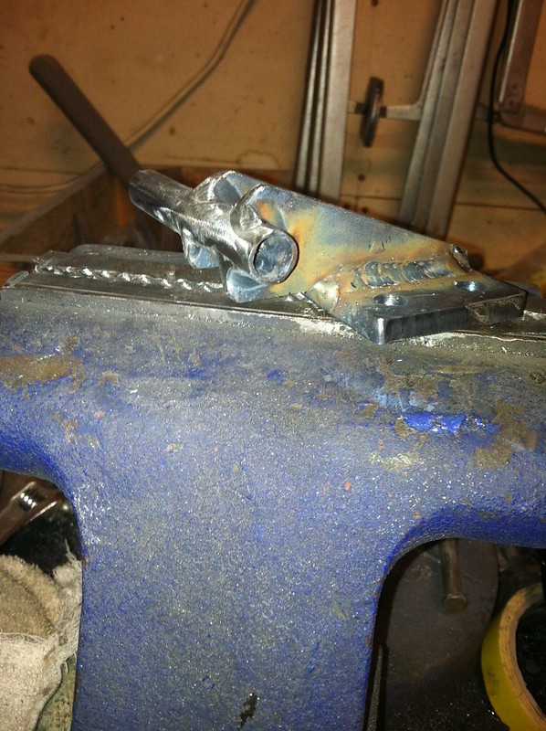

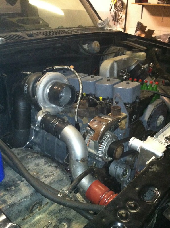

Got some pictures now.
Also got my non ac belt on and routed leaving plenty of clearance to build my lower radiator hose. Got my grid heater delete, one more return spring for the throttle linkage so it returns properly now.
Alternator mount

I'm gonna see if I can find a pair of 12" fans I like when I'm at jegs today otherwise ill run Taurus fans. The dodge mechanical fan works well on my king ranch but I don't have enough room to do that on this truck

I did end up getting two 12" slim fans from jegs today that each push 1200 cfm

Where are you getting your pieces to build your intake and exhaust? The boots and stuff look really good
Sent from my Pear phone 5 using Tapatalk
Thanks! I got all the piping from a place called principle truck supply in columbus, they sell take off bends for dirt cheap. I got the boots and clamps from there as well. The intake boot on the turbo came from Jegs
