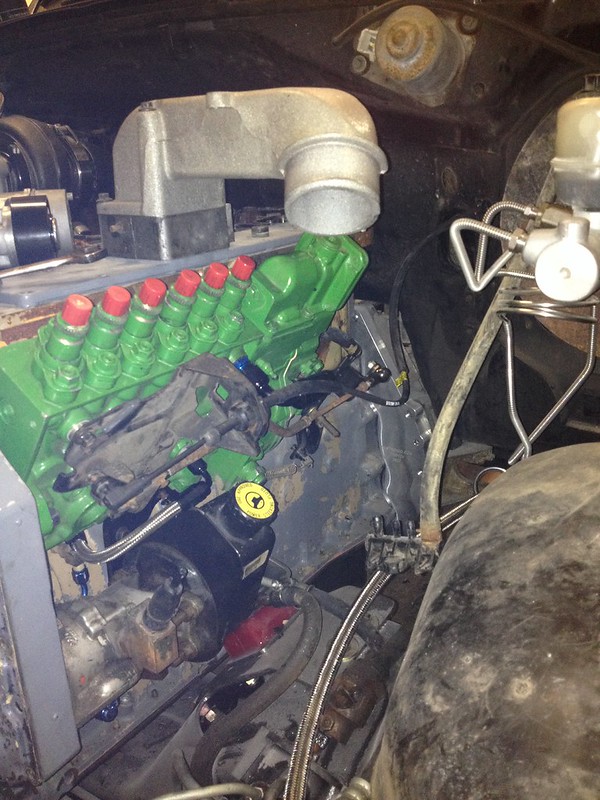

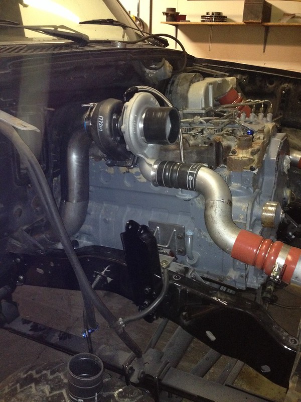

Well unfortunately my king ranch took up my night yesterday with some repairs so I dont have a ton of progress to post but I did get the intercooler pipes made and tacked together. Also got the rest of the exhaust mocked up, just need to cut those sleeve fittings off that look like crap (just used for mockup) on the dump part and then weld the pipes up and all the piping is just about done!

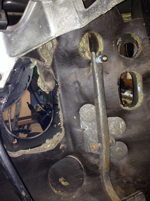

Some firewall clearance pics for reference

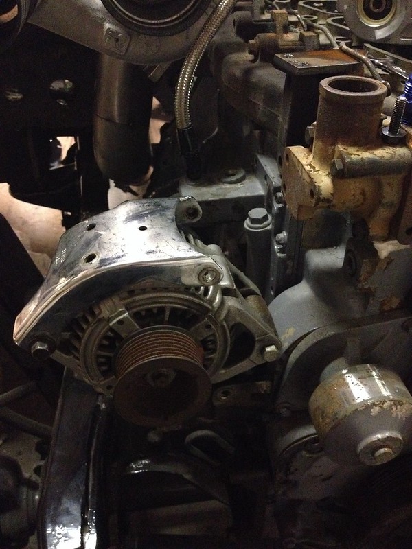

Got my internally regulated dodge alterntor and Im gonna have to make a new top mounting bracket so I can use the top entrance for the upper radiator hose

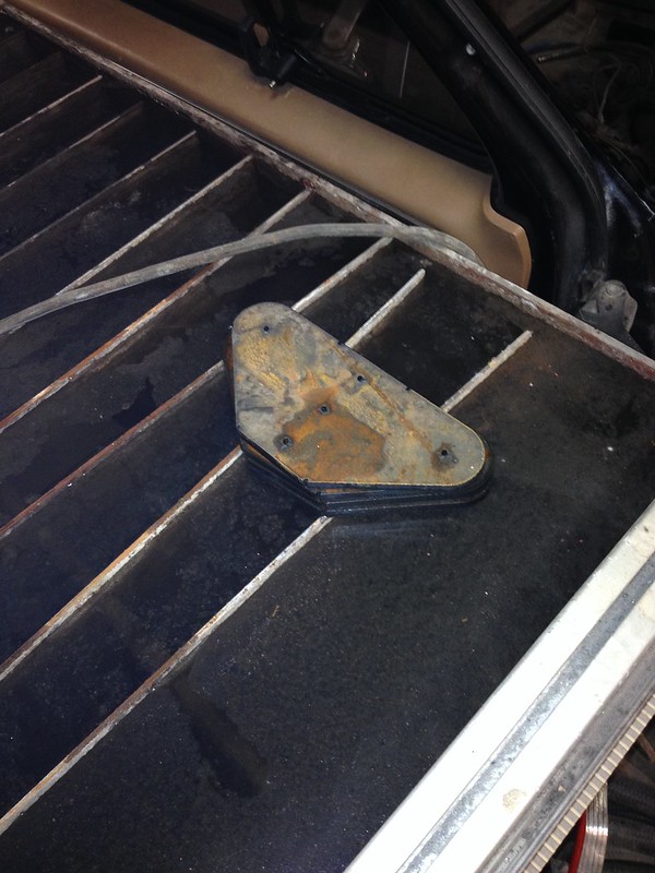

New mounting plate for the top alternator mount cut out on plasma table

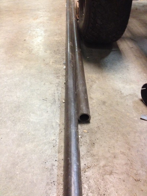

2" Chromoly tube

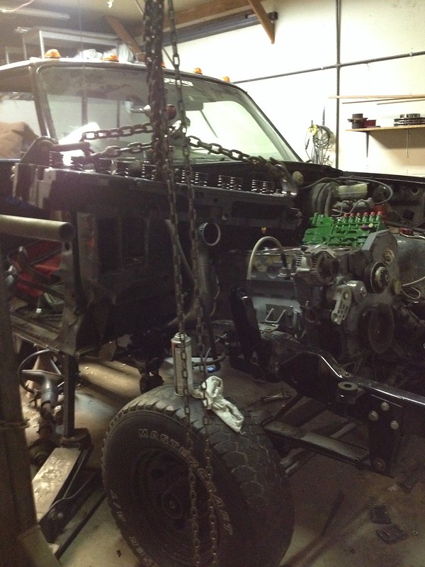

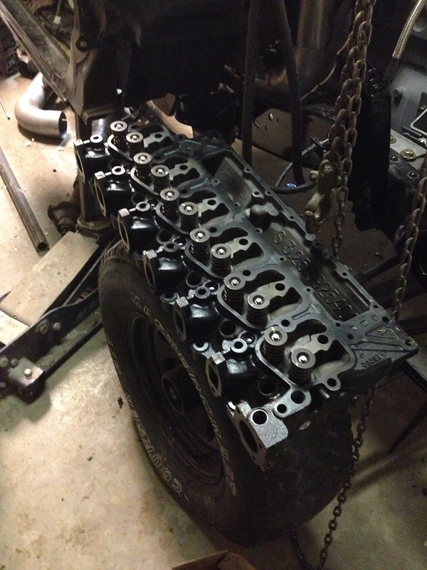

Friday me and MINK took a trip down to Indy to meet up with my good friend Matt kelly to pick up the good head for the 12v. Has all new valves, guides and seats
And got to work on putting on the new head, but quit early since I had been up for 30 hours straight
