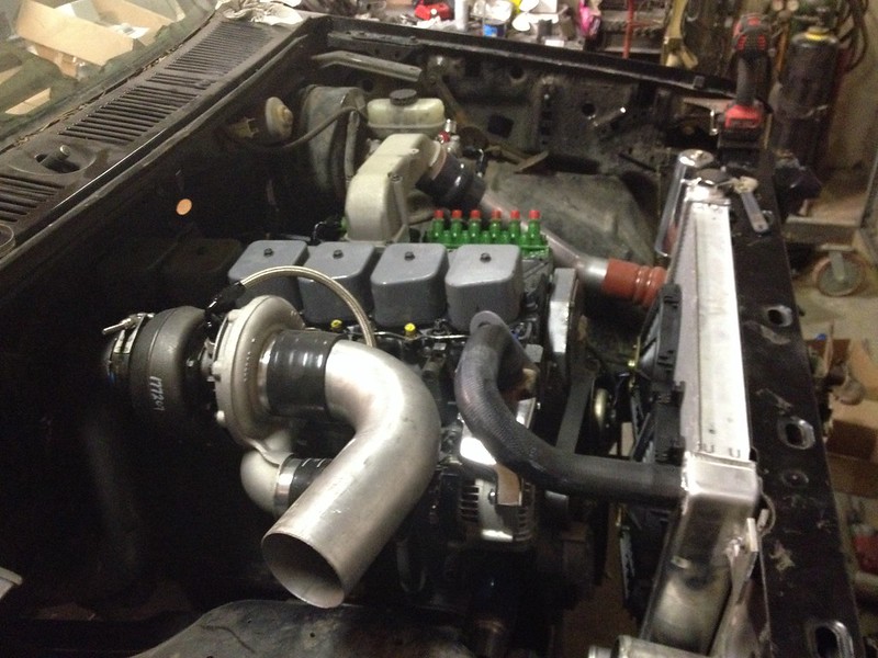

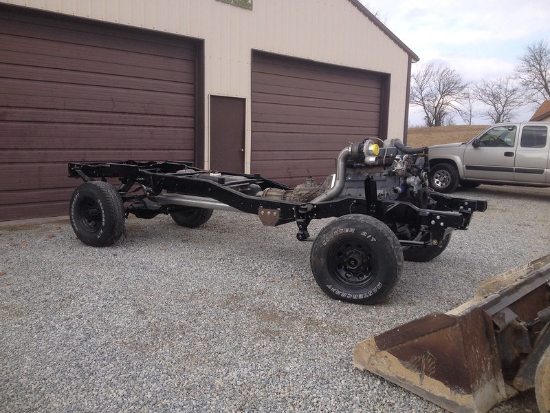

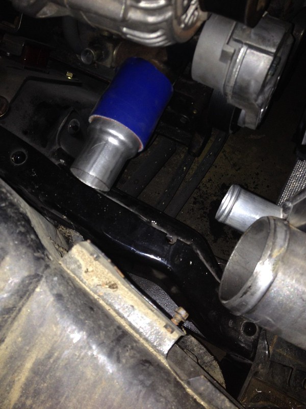

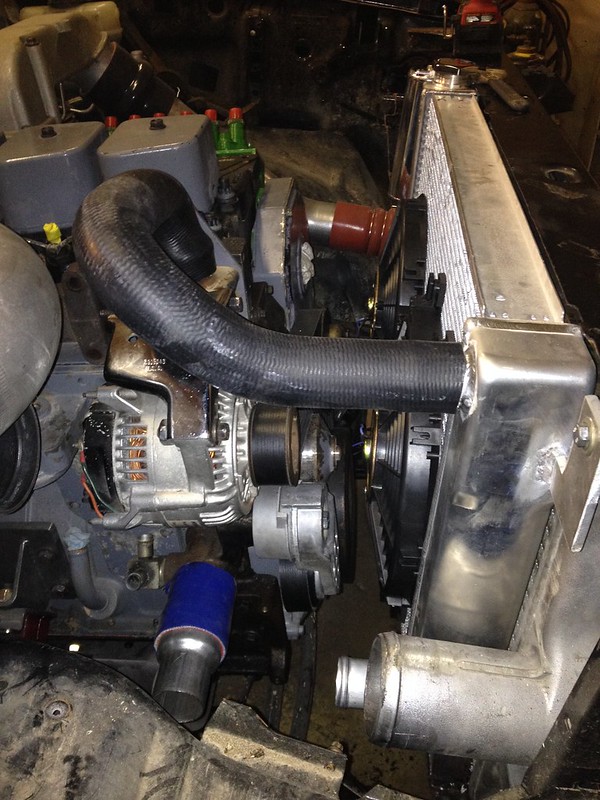

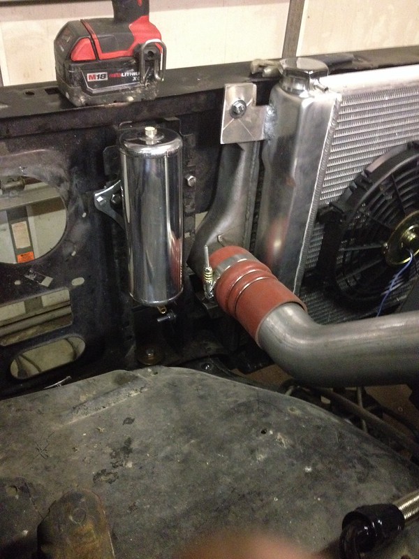

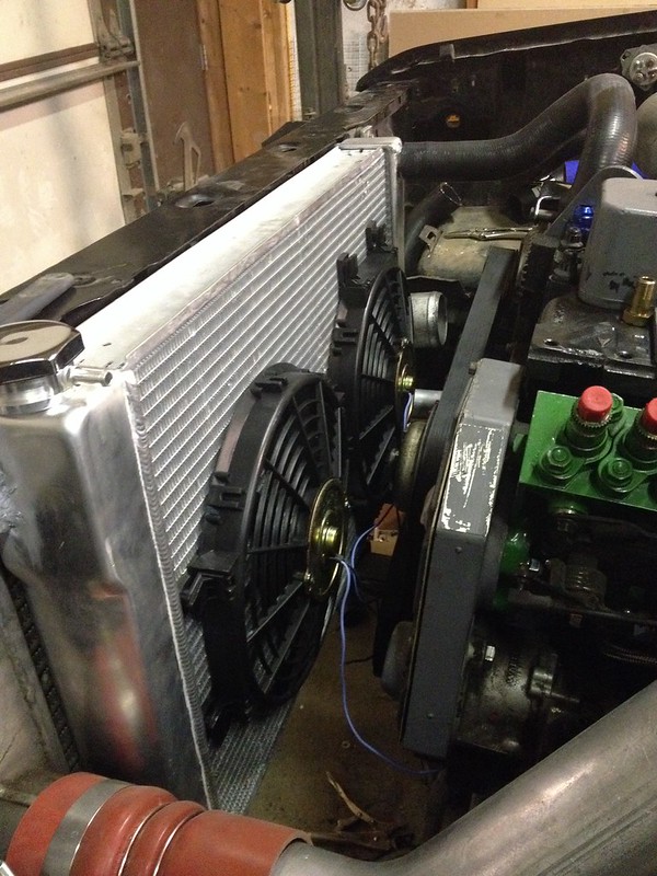

More good progress made today,

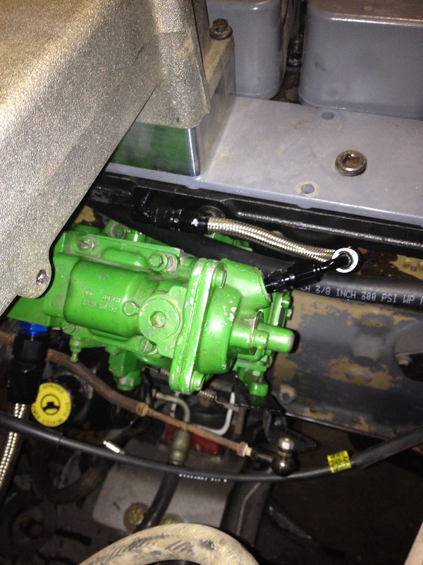

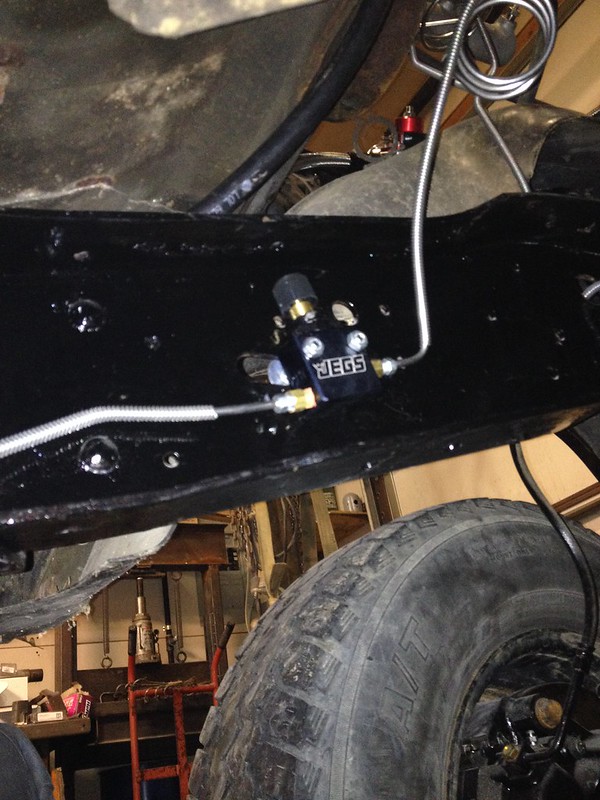

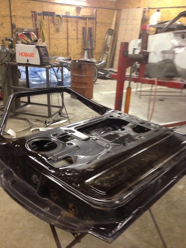

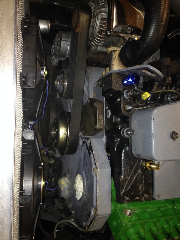

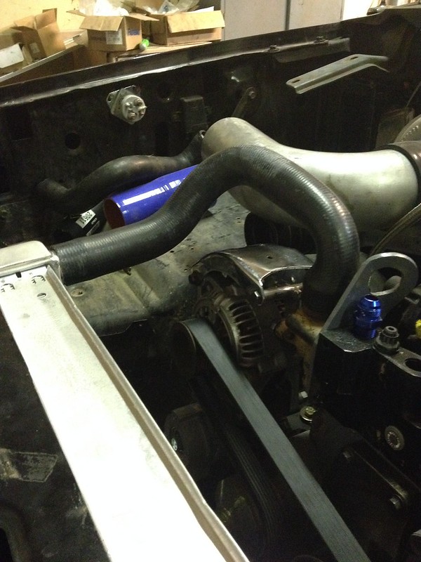

Got the electric fans mounted, upper radiator hose made. Lower radiator hose will take a little more work, I need to get 3 1 3/4" 90 degree mendrel bends to build it. Boost reference line for the AFC on the p pump made, Proportioning valve mounted and brake lines plumbed, both fuel return lines ran to tank, coolant overflow tank mounted, also got one of the doors completely stripped down and ready for blast. Just about ready for the body to go off to get blasted.

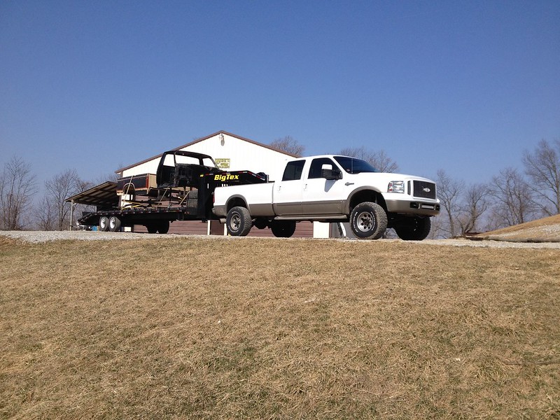

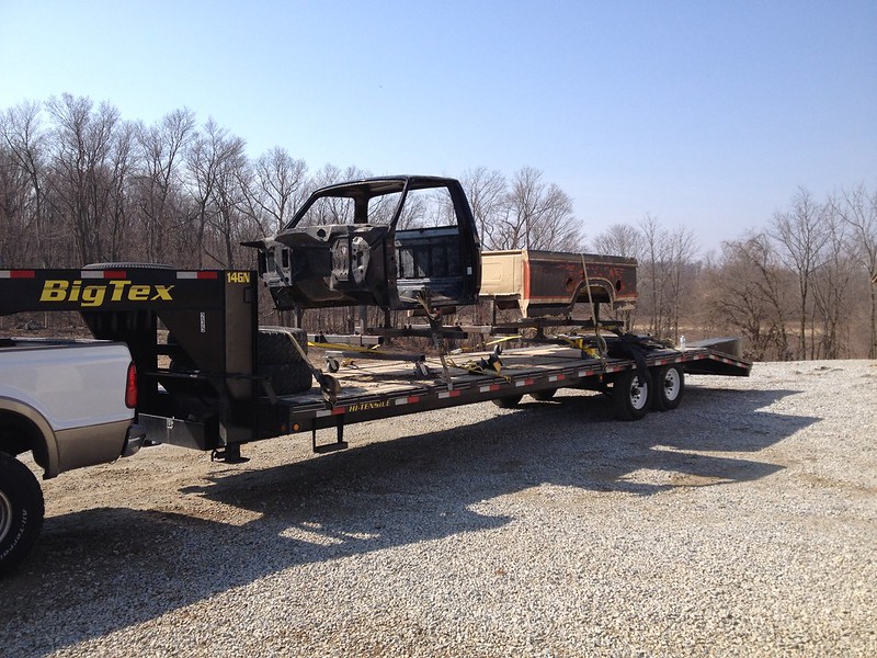

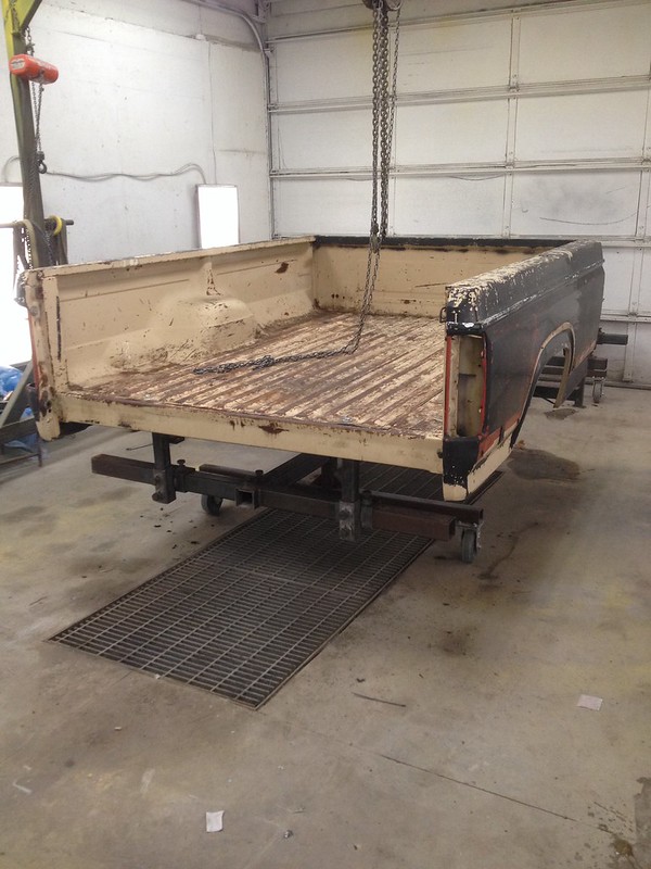

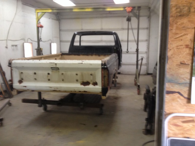

Went backwards and stripped a lot of stuff back off, but that was just to get it ready for the next big step. Got the cab completely stripped down and bolted that and the bed to the body cart tonight. Doors and fenders all stripped as well. Tomorrow its all getting loaded up and Im taking it up to get media blasted so it will be ready to start the body work

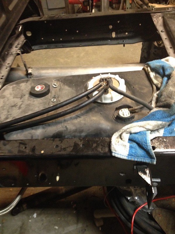

Are you only running one tank or are you going to put a second tank in later?

Im just gonna be running one tank, this truck wont be driving long distances much so I didnt see a need for a second one, that way I can shave the rear fuel door and make it look a little cleaner

Tis a shame you couldn't get the best of both worlds, shave the rear fuel door but have a larger bronco or newer F550 rear mounted tank. That way you could keep the clean look but have some real range. Then again I guess that 19gal should get you far enough. Plus no stupid selector valve to fail.

Yeah I thought about doing the bronco tank but I decided since I had this good poly tank already I'll just stick with it and it should be enough range for what I'm doing with te truck. Unless my king ranch breaks and I have to tow the gooseneck with this truck instead lol.

Got the body up to the media blaster yesterday, only issue was my airdog motor on the king ranch burning up for the third time now. Time to get rid of that crap and build a fuel system. Also got my wheels ordered from daryl@tdp and the body will be done being blasted Friday

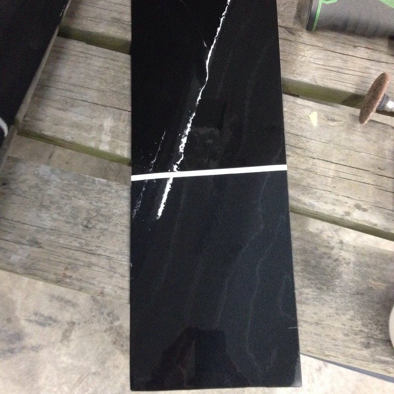

While Im waiting for the body to be media blasted, I got to preview the paint colors that will be going on. Cadillac black diamond and cadillac phantom grey
