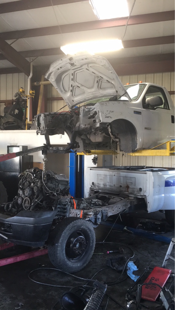

Here's to the start of the race truck lol. I bought this gem. An 06 f350 and I'm gonna use the cab and that's about it.

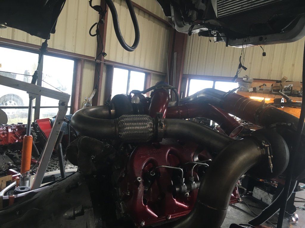

Well the trucks back together. I have a stock (ish) motor back in it. I'm running stock bottom end. Studs, push rods, 10mm cp3, h&s lpfp, 3" intake plenum, afe blade runner intercooler, precision 6466 gen 2 turbo, mishimoto Trans and fuel cooler, I have alto clutches in the trans with 9 od clutches, revmax valve body, Midwest/precision converter, and I couldn't be happier. The truck is super responsive. No turbo lag, not much smoke all the way from takeoff to wot. I currently have tuning from Morgan on there and he did a great job. The best tuning I have ran.
I'll get some pics and videos up soon. And hopefully get it on the dyno soon. It defiantly feels like it has somewhere in between 6-700. But only numbers will tell.

Gonna run compounds now lol. 64/66 with a 76/75. Gonna be interesting

Shoulda let me know man. I would have sold ya my 6466 cheap. Should run pretty damn good. And I agree. The piping looks much better
