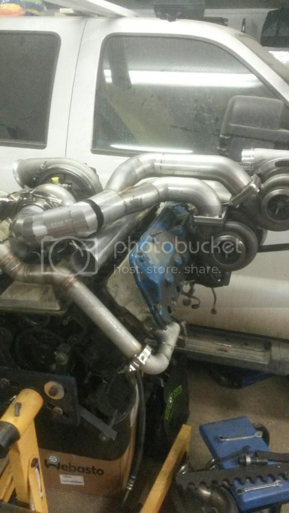

Doing boss stuff. Shane fabbed the hot pipes up in about 4 hours last night. A bellow will be in the open section.

Some Nice Looking Stuff Matt (And Nice Fab work Shane!)
Hey Look Guys....Project Never Ever Will start is in the background..... LOL

Very nice buddy!! Way better then the first setup. Just like its supposed to look like now. Shane does killer fab work. Not just the king of cab on anymore lol

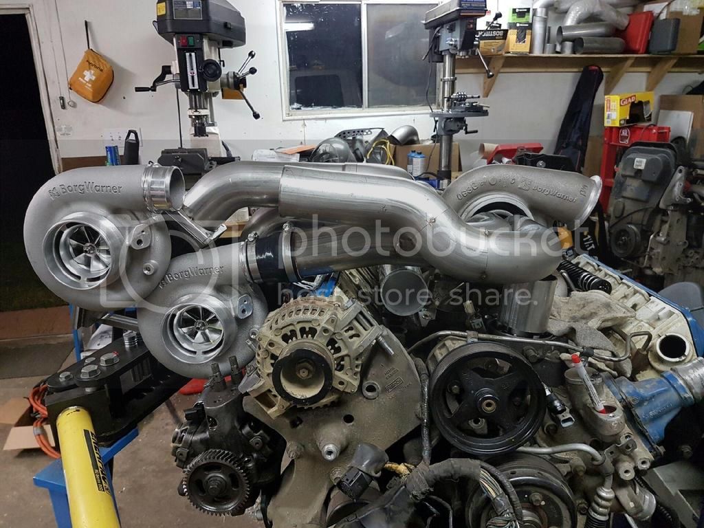

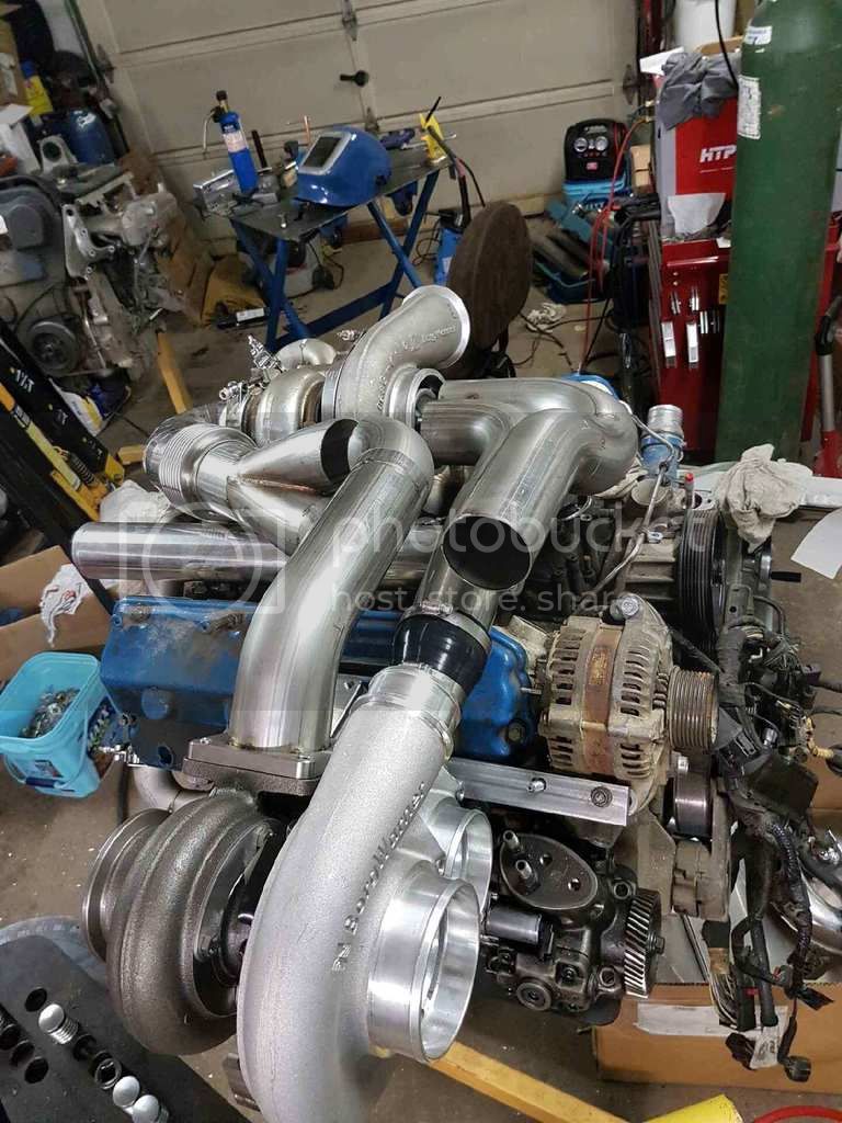

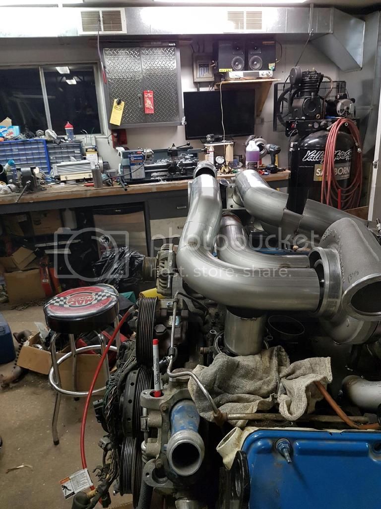

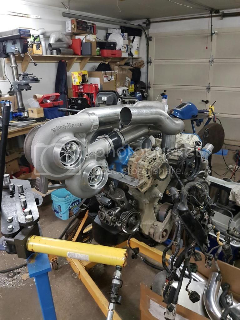

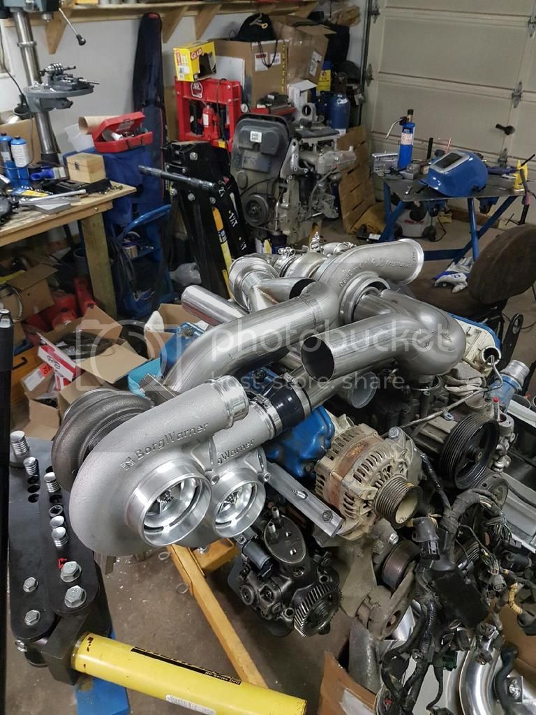

Been a little bit since I've updated so here is some new pics in no specific order.
