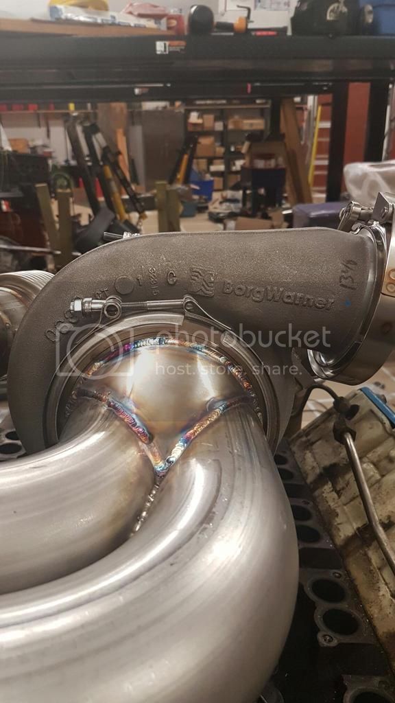

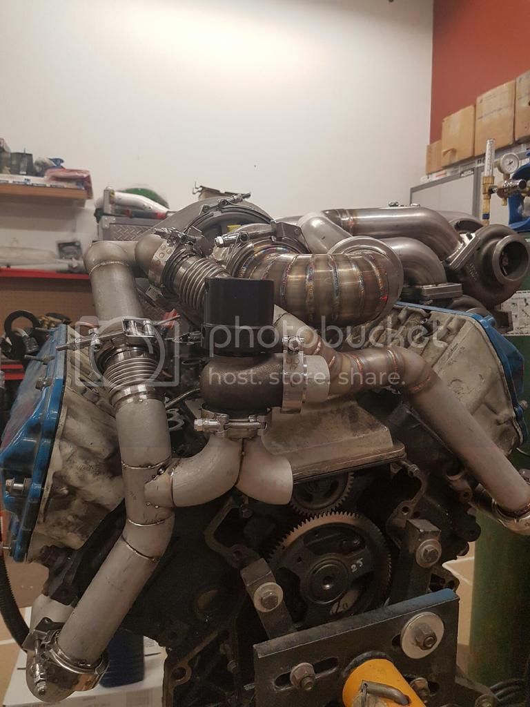

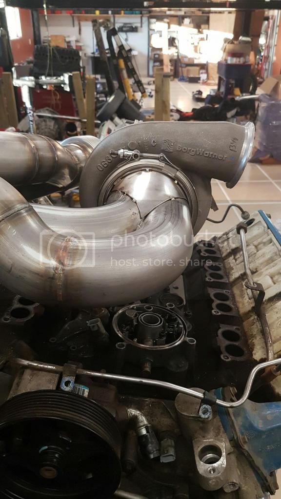

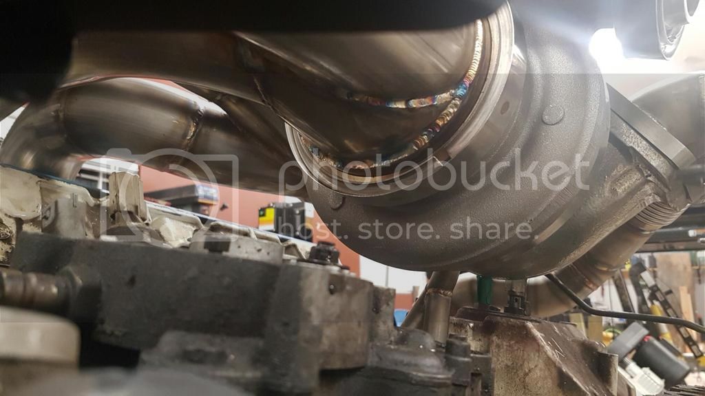

Thankfully I'm on xmas holidays very soon at my house so I can focus some time on this and get it finished up for Matt. With all that has gone on this year Matt has been so understanding and patient. Final piece to tack up is the waste gate piping and former the merge at the inlet of the high pressure turbo. Most of the welding is finished and everything has been back purged during welding so the welds look great inside as well. I'm excited to see this kit completed and start on a new kit and project.
As for being tight under the hood it shouldn't be any worse than it was before. It's all very low profile and close to the engine. Matt should be happy.

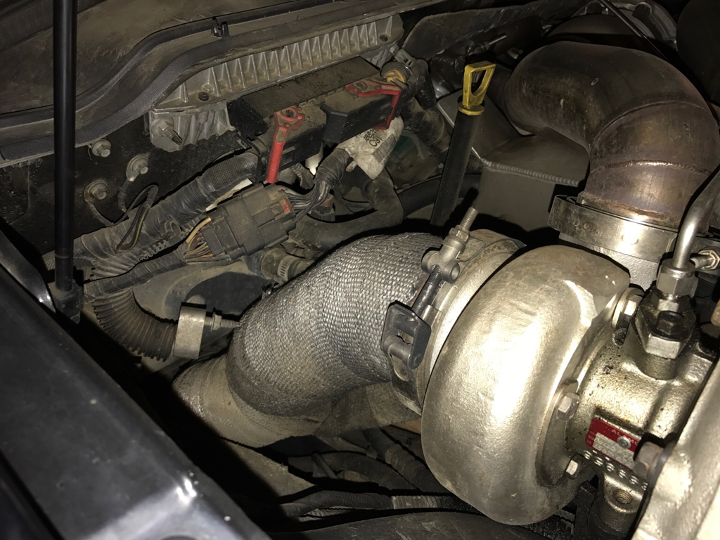

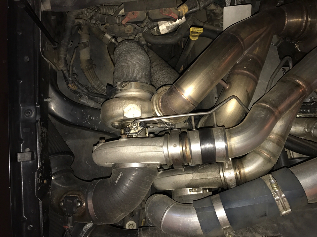

Is there going to be enough room for down pipes with the turbos sitting that far back?
#letsgochamp
Going to be tight but it should fit. Plan on doing 3" downpipes to under the cab and then merging them to 5".
Jordan and I had talked about using two 4" then merge under the cab but there wasn't enough room. He ended up merging two 4" into a 5" before going under the cab.

Cool build, should be a running mo fo. Shane is dong a killer job. Sure wish my tripple set up was like this last time....lol

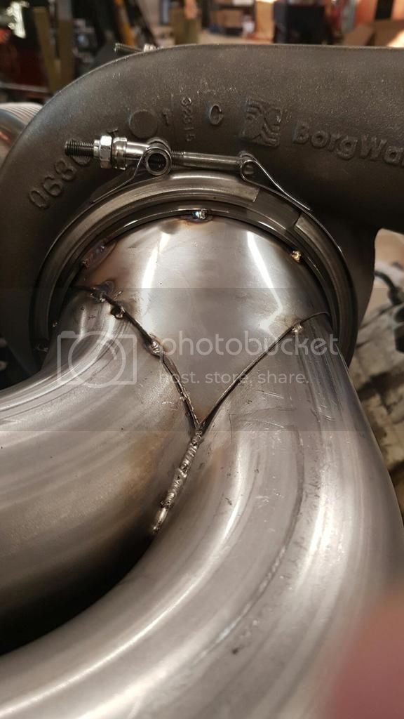

Matt
1,897
Minnesota
Shane got the 2 into 1 merge tacked into place. I think it'll look pretty boss when it's all welded in.
