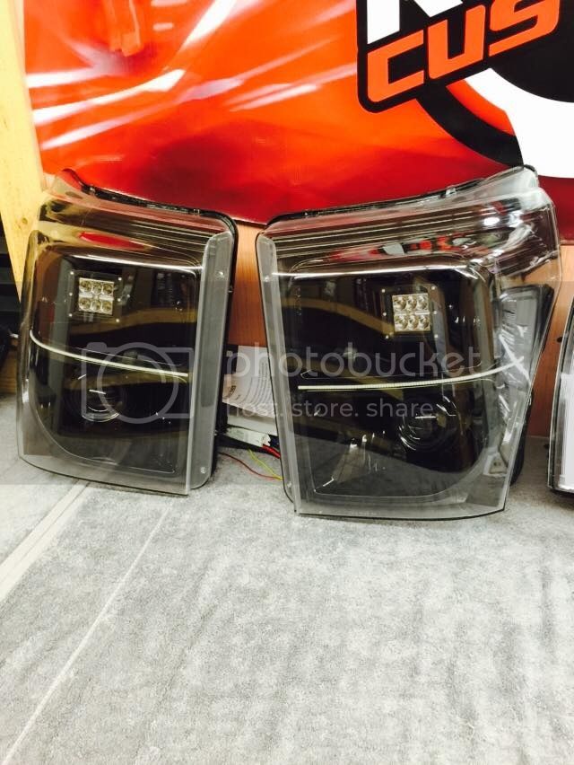

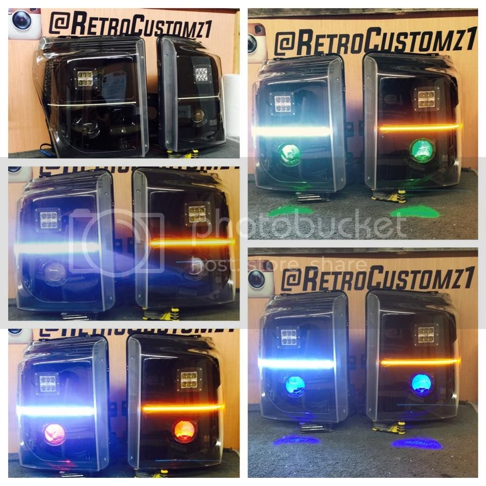

A little update, my lights from Retro Customz will be here next Monday! You might recognize these from Mikeyfitz's truck, and yes I copied the hell out of him! Sorry, but these lights just looked perfect, so I had to have them :p
Will post more pics when I get them in and installed!
WatchTryst
Jul 1, 2015
75
The Jersey Shore
I would love to see a video of these beauties in action.
Notneb
Jun 26, 2015
1,733
I'll probably do a write up as there is some electrical work according to Mikeyfitz, so I'll do a video so everyone can see them in realtime.
Mikeyfitz
Mar 22, 2015
761
Houston, TX
If you have Instagram you can check them out have a couple videos
@mikeyfitz
There you go good build name hahah
