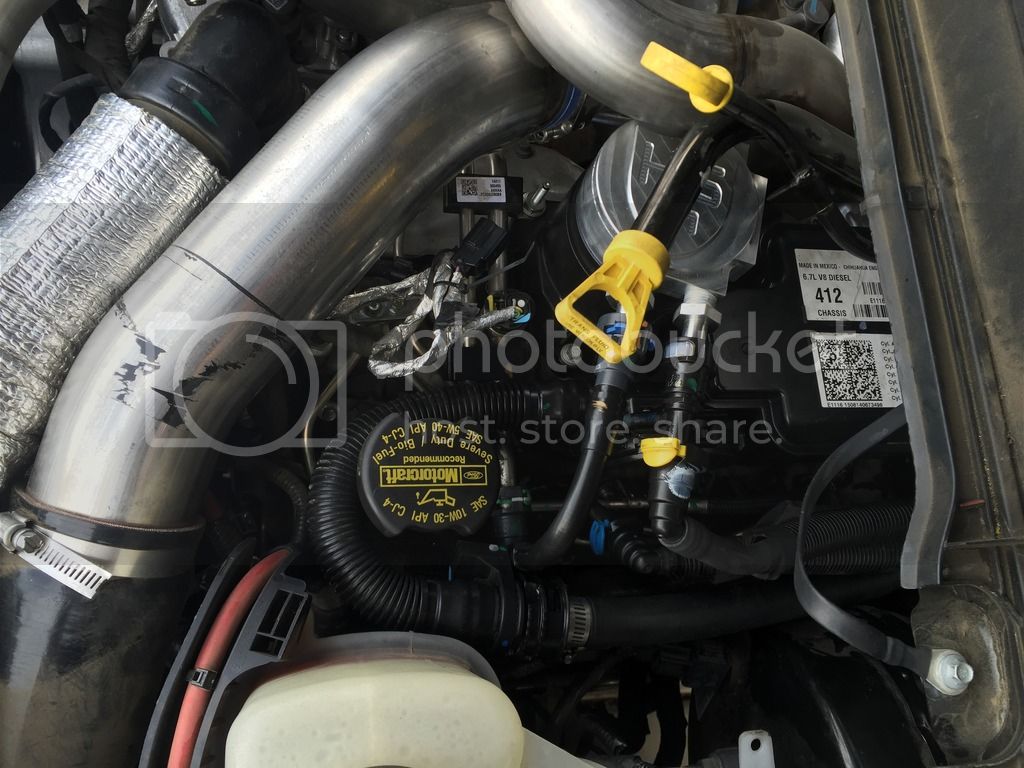

Ok so I got the H&S Fuel Filter Conversion and CCV Box in place mod. Basically all the CCV mod is a fitting to be able to use the stock CCV filter in place but still vent to atmo/exhaust. I have the Midwest SS Intercooler Piping kit, and I believe there was some concerns whether the CCV box would still fit. Answer is: yes, fits fine, no issues at all. The only issues I had were with the fuel filter conversion, it was too tall sitting in the stock cradle, so I just cut the bottom of the cradle out and now she juuuuust fits. I will just do away with the stock cradle after I get measurments to fab up a better mount.
Just a note: for anyone doing this like I did, where I already had the CCV filter removed, make sure you pull the o-rings off your CCV mod blocks!
^^^ You guys like a tight fit right?!

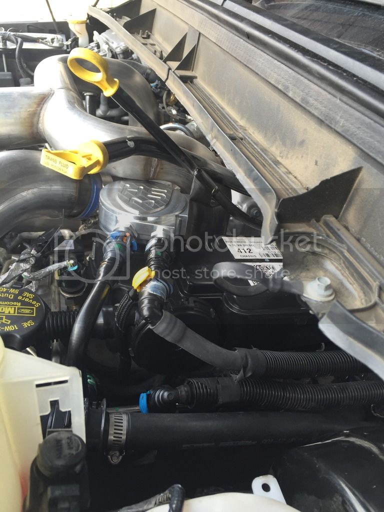

^^^Overhead so you can see where I routed the hose.

And to clarify: The reason I had to cut my stock cradle was that the SS Piping kit replaces the stock intake, so there's just a smidge less room at the driver side intake elbow. If you've got a stock intake plenum, it will clear with no cutting. Fortunately for me, there are already tapped holes in the filter block, for aftermarket mounting! Gotta love H&S!
