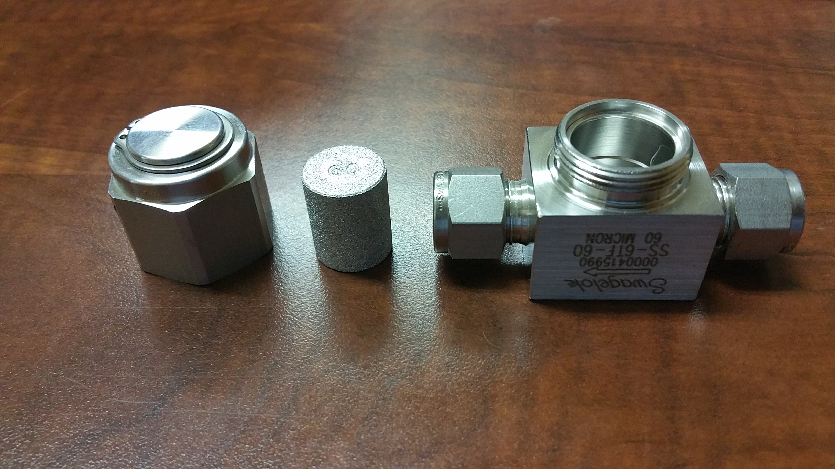

I'm curious what you come up with on your CCV filter. I've been thinking about it too and am waiting till stuff comes in and see what I'm dealing with. I'm wondering if something mechanically simple like this is gonna work. An inline replaceable 60 micron filter that could be swaged onto a tube?

Noooooooooo, you need a pretty good sized coalescing filter to condense the oil vapor, since there is soooooo much volume. Another PSA member *Jomax* found an industrial filter from Parker/Raycor that might do the trick, only problem is size and where to put it!

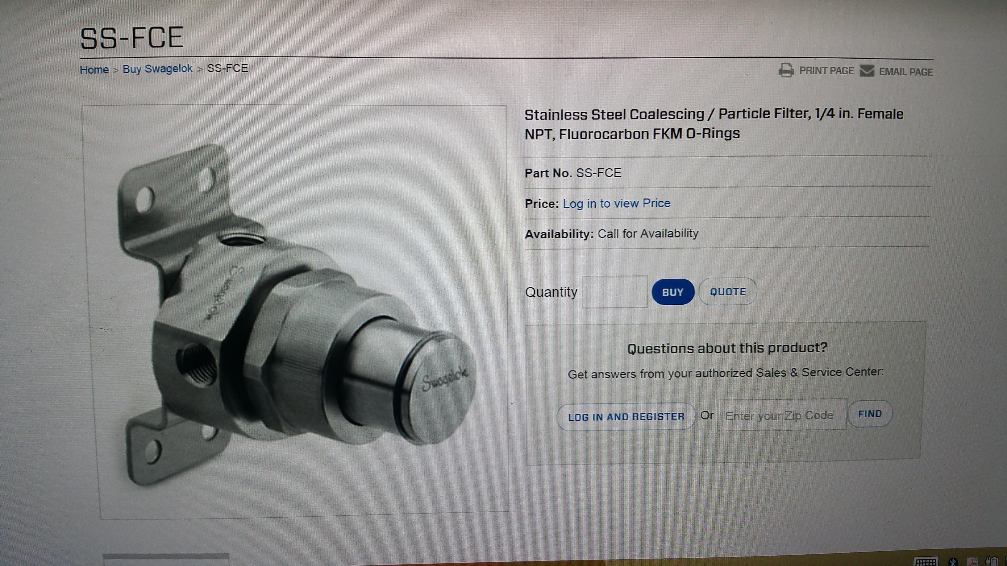

Lol, okay, what kinda flow are we talking about? I was obviously underestimating it. Any idea about what the scfm # is. I'm fortunate to be in the industrial construction field doing controls commissioning and start-up for new power plants and stuff. With that being said there's no way I'd go Parker over Swagelok. Lmao, that's like comparing Ford and Chevy!

Sorry for no reply, never got updated! I'm not sure on the scfm, but look at the stock CCV box, that should give you an idea of the size of filter you'll need to build.
