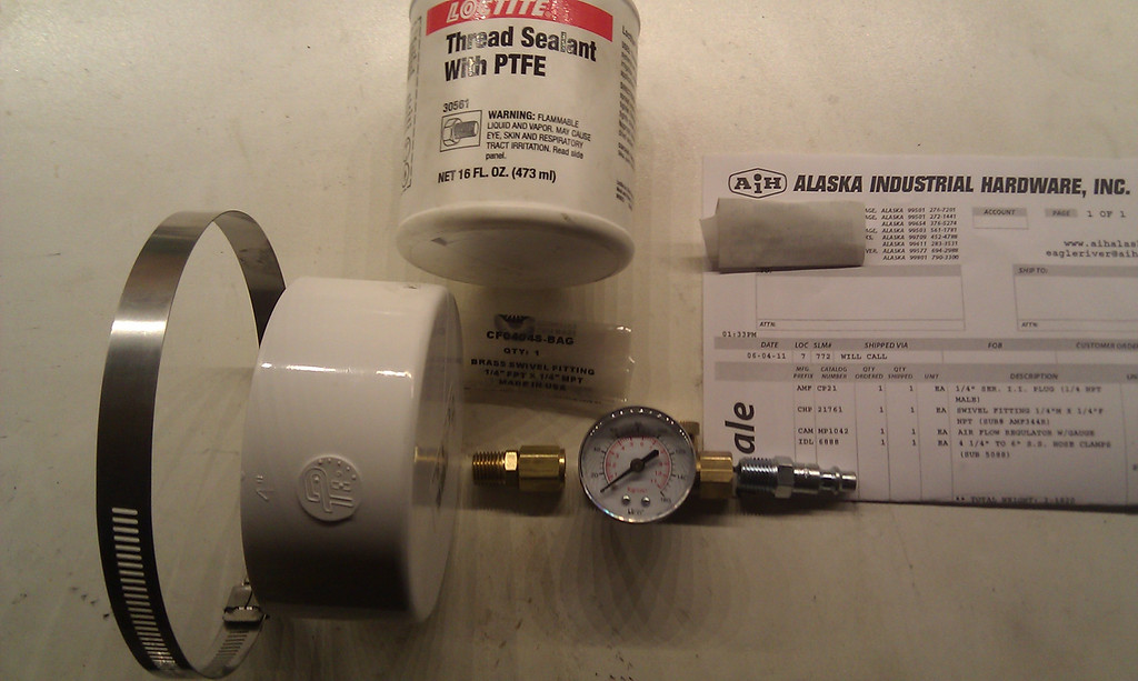

How exactly did you pressurize? I've tried doing mine but it'll blow the plug I'm pressurize through off at about 20 psi.

I put a 4" pvc end cap with an air hose disconnect threaded in it and double clamped it to my no limits elbow. Then hooked it up to my air compressor and slowly turned the ball valve to get the pressure I wanted in the intake.

I took my BOV off and put a rubber boot for PVC there and clamped the heck out of it. I also had a PCV plug in the top of it with a ball valve and nipple fitting for air at the top. I put a 5" center cap in my intake elbow and clamped it hard as hell. Blew it out one time but put it in way further and double clamped it. shut the ball valve after 75-80psi and sprayed all pipes with soapy water. Found 1 pin hole in one of the cold pipes and fixed that. Havent done the exhaust yet but if this last fix doesnt work I will be making a steel plate and o ring to replace the downpipe and pressurize from a wastegate port.

The first time I did it with one clamp and it blew the pvc cap out( I had a valve stem in it the first time) and it ripped the end of my finger nearly off. Tore the skin from under the nail and whatnot! ***ing hurt! Thats why I double clamped it and switched to an air chuck fitting.
