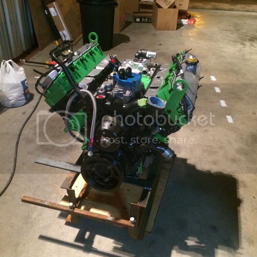

Whoa. Progress. This can't be real. I thought it was fake when I saw pics the other
Shhhh over there mister .... Lol
So clean. Good job.
Thanks man finally getting there :joy:
Dude that's such a wicked sick clean look. I hope it turns out as bad ass as it looks. Well done man!
Haha dw this is only the start... I won't disappoint
the race is on my friend....the race is on.....
Shhh go on your vaca and just watch what happens when your gone lol
Maybe i missed it but what pistons did you use?
Mahle stock bore, wide bowl, 0.120 fly cut, deliped, coated ~ RCD pistons, josh is the mad man behind them!!!
Wow, that thing looks awesome! :rockon:
Thanks man it's even better in person
I believe he went with RCD everything.
Winner ^^^^^
Yeah he did, found it on the 1st page :slap:, thanks.
:toast:
That'll add up quickly!! lol. Wish I had the coin to drop like that. haha :thumbup:
Haha that's why it's been a year and half in the making lol :cursing:

looked sweet when I was there a few days ago and it looks even sweeter assembled. can't wait to see video's and some #'s!
sorry been slow at up loading stuff well things started to get back on track after a ton of shop work we been paying attention to this build little each night at the shop

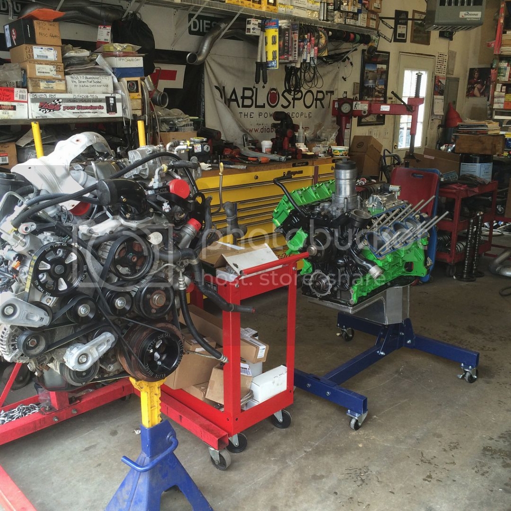

As you can see its like built motor month here at SDP, sled pull 6.4 motor ready to go
that 6.4 needs some intake elbow love.

That's gotta be the cleanest 6.0 I've ever seen!!!
What's the plans as far as HPO?
Feb 21, 2012
481
Cromwell, CT
Pretty sure I saw some sweet oil rail fittings on instagram ;)
haha yes you are correct still working on that part some...
Thanks man that was kinda my goal :rockon:,
and dual hpop's, high volume RCD pump in the rear and an Elite/my own set up using a stock 04 pump up front
I thought I saw some parts from a dieselsite HPODS?
its going to use some of those parts but not all of them....

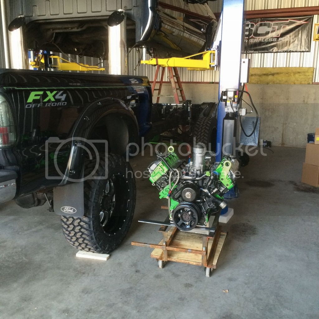

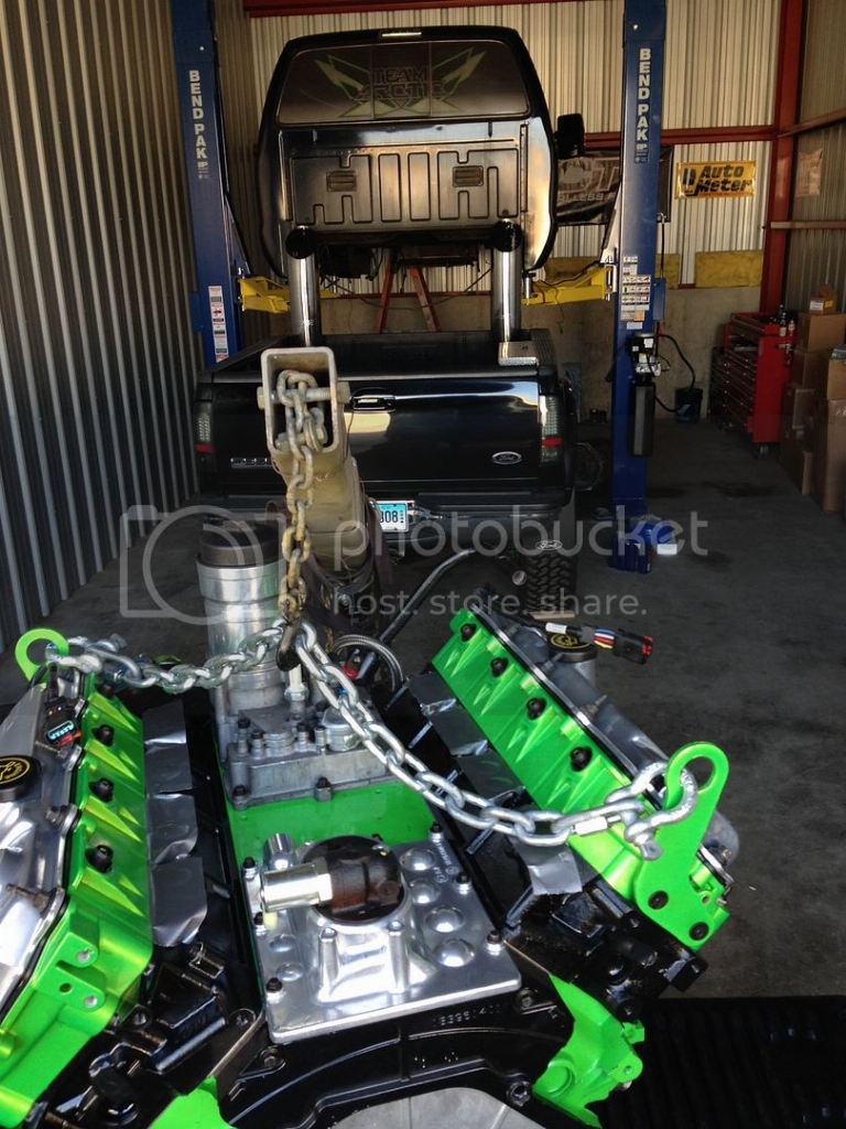

figured it was fitting it made its was to my shop in a 6liter so i barrowed Seans DD and strapped her down on our stand

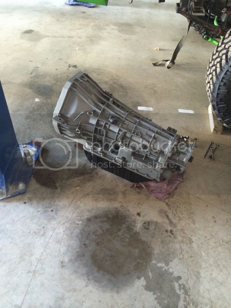

getting the trans ready to go in
trans and transfer case in

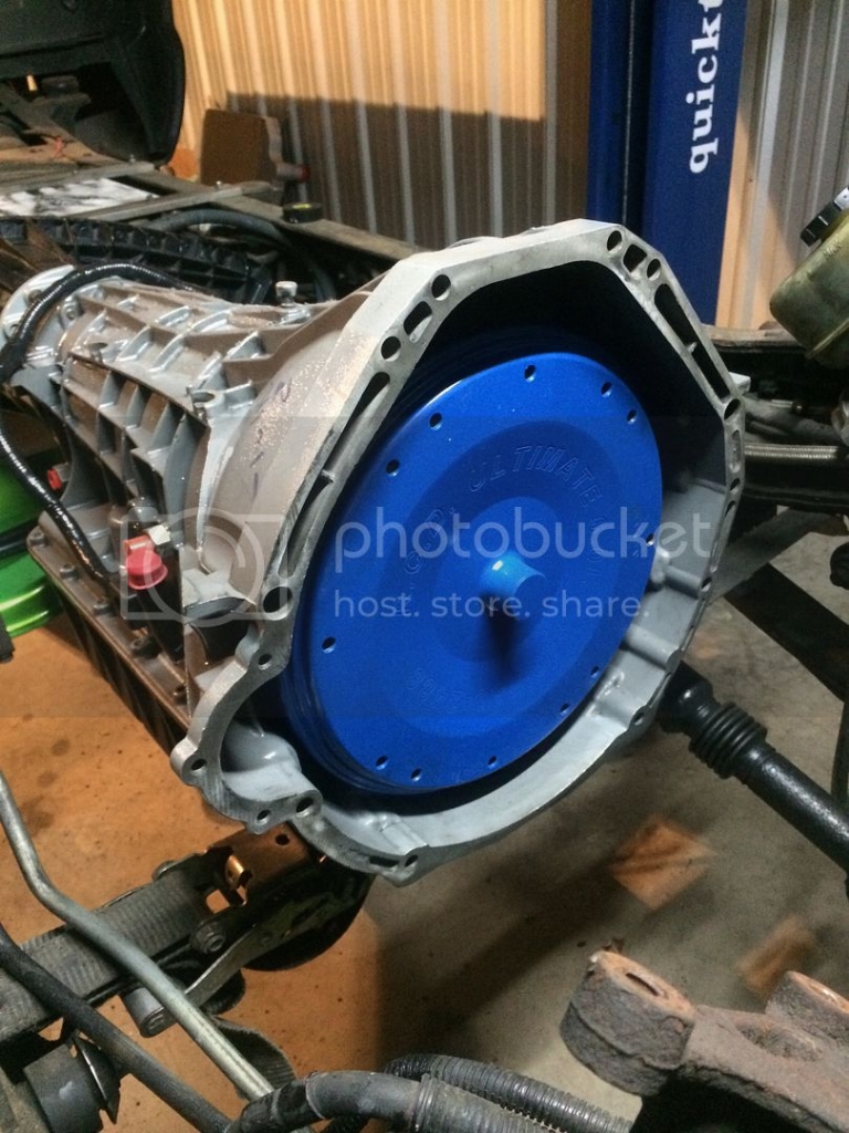

RCD 2200 stall converter
RCD Relo kit came in thanks jared :rockon:
Deff cleaned up the top of the motor for sure
strokin6L

Looks great Tyler. Digging the RCD relo bypass. I've been wanting to get one for years but always find something else to spend money on lol! I like what you did to the oil cooler cap. How did you block the outlet off...got a pic?
Feb 21, 2012
481
Cromwell, CT
no i don't have a pic ill get one for you tonight basically i cut off the nipple where the egr delete hose normally attaches and had my welder weld up the hole for me
