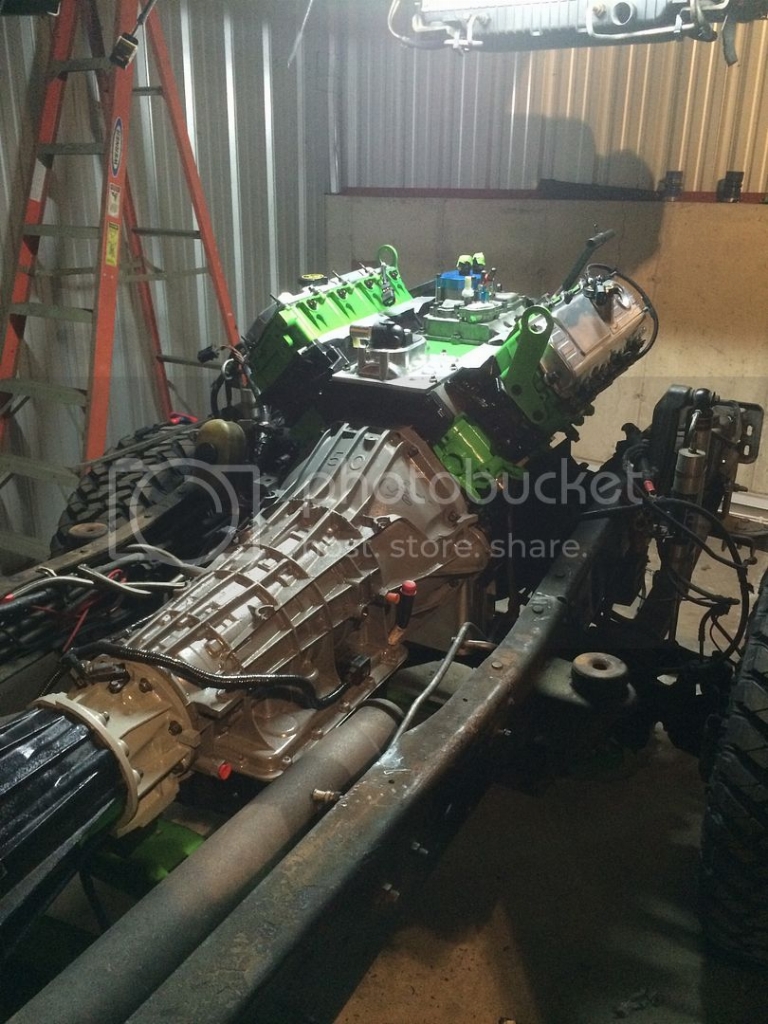

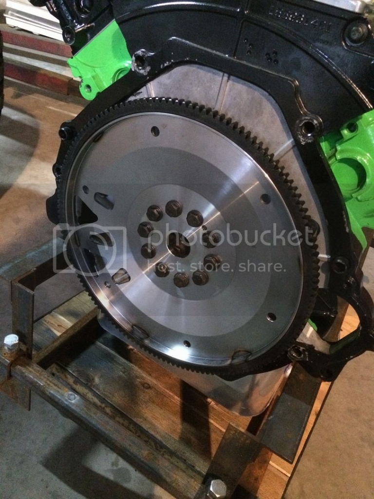

SunCoast billet flex plate came in the other day got that all installed
That same night dropped the motor in and connected her to the rest of the drive line

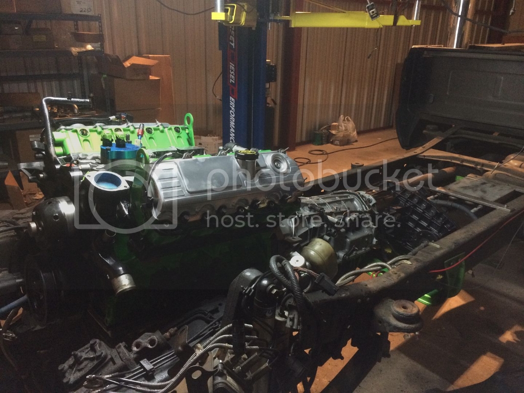

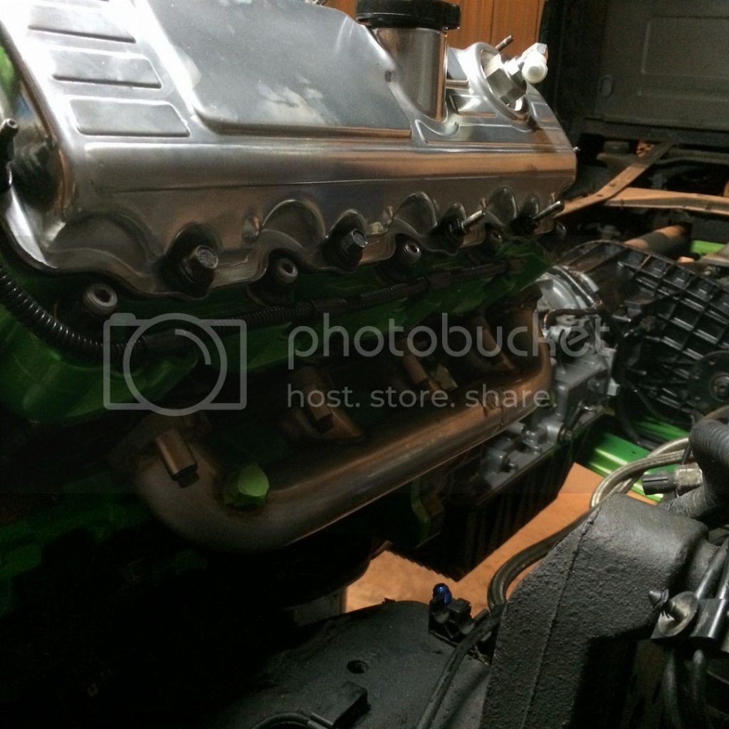

started messing around with putting the RCD tubed manis on for mock up of the turbos
this might have been the pic morgan was talking about earlier with some fittings in the oil rails :poke:

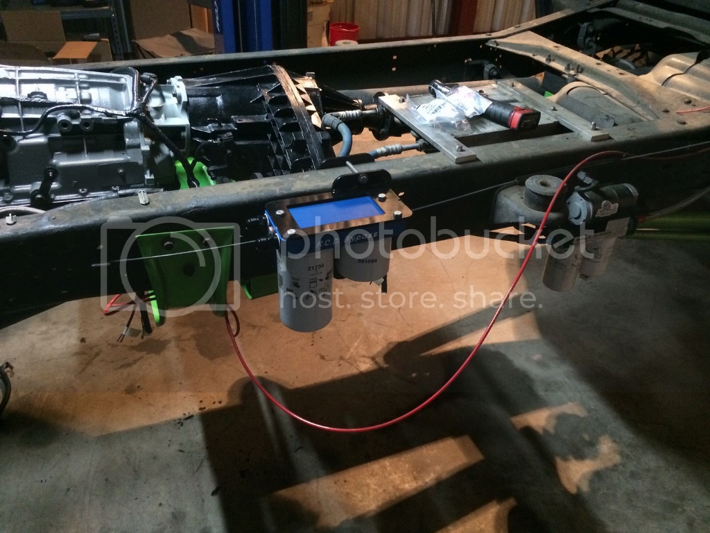

got the RCD RELO kit all mounted up, a little farther back on the frame then its suposto be but wanted to leave room for a coolant filter and other stuff up front

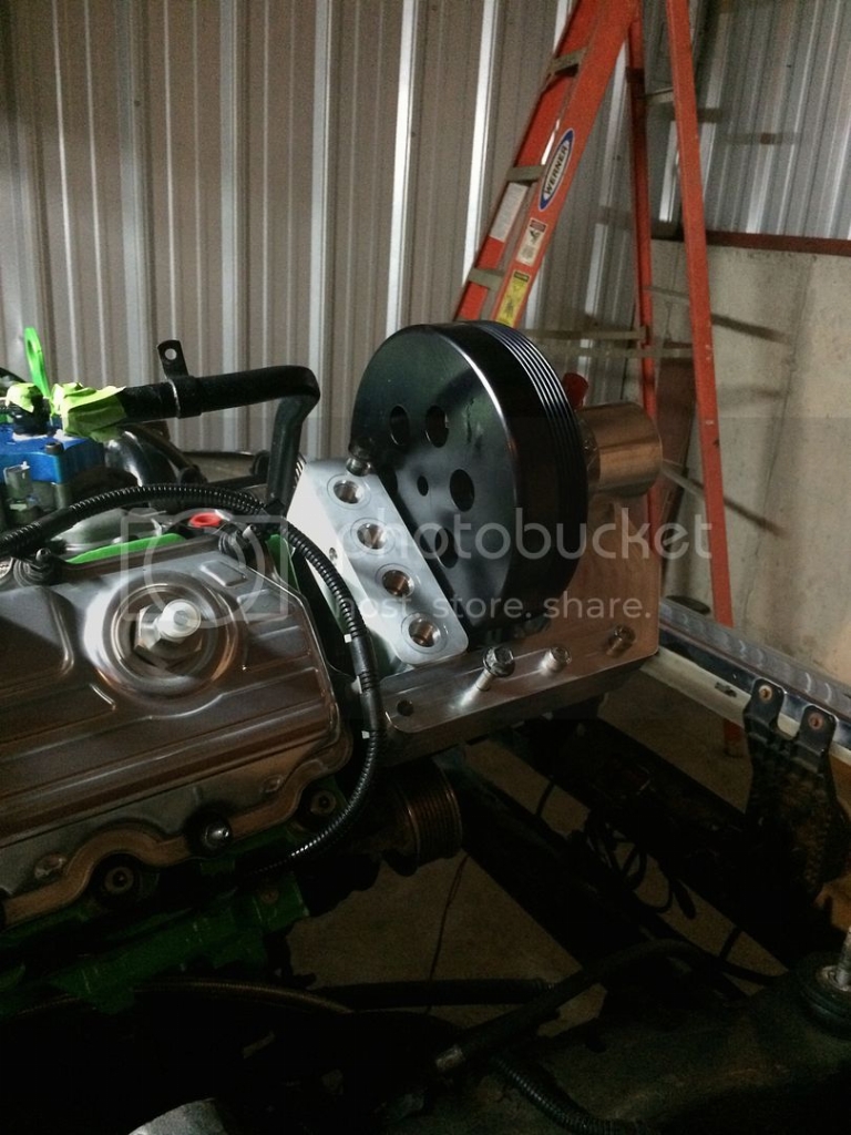

also started to play with this set up lol

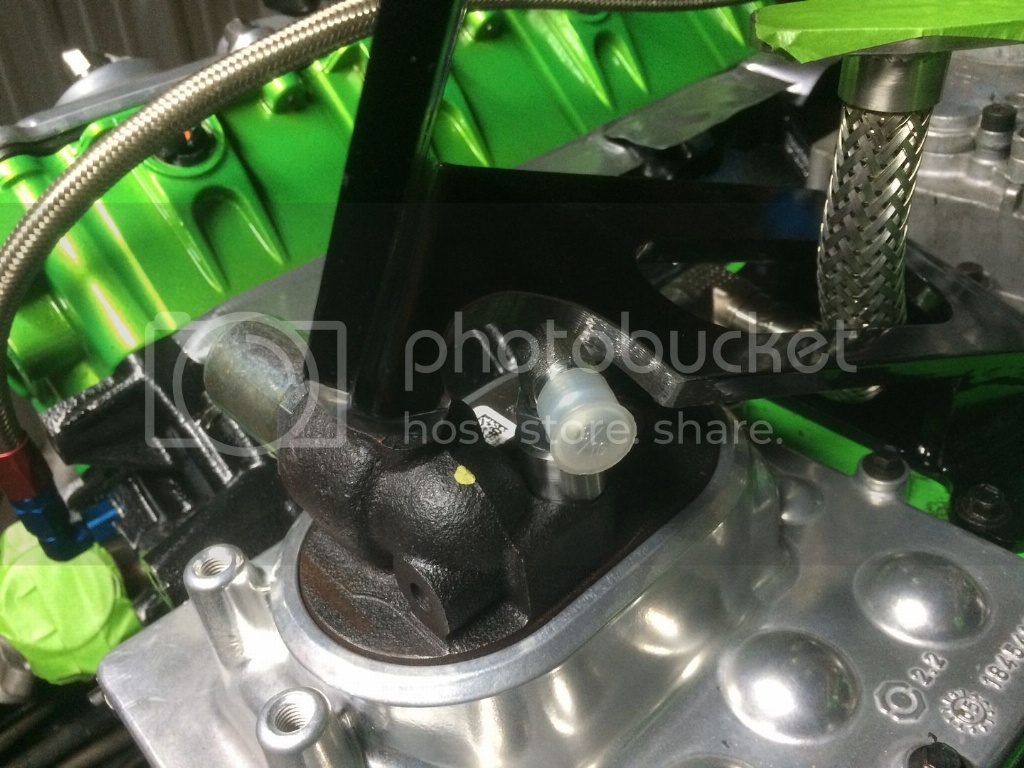

did a little machine work to gain access to the test port under the turbo pedestal
