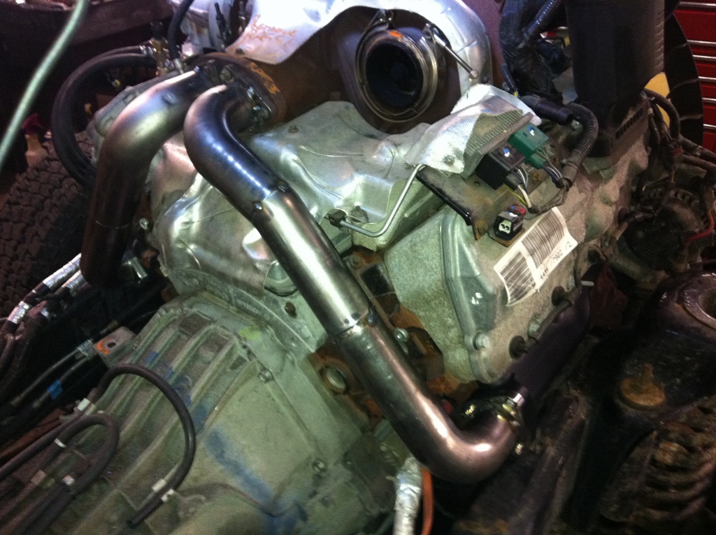

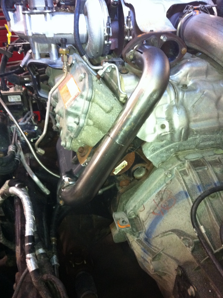

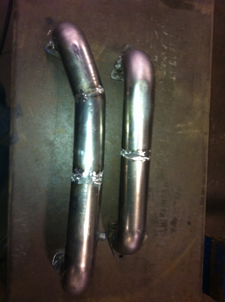

Up Pipes Fabbed
Just finished the Up Pipes. They are 2.5 in and go to 2.25 at the turbo.
Did some porting to the turbo from a little less than 2" to 2.25"
I'll get finish install pictures tomorrow before we lower the cab

Yes, This truck didn't need one so we didn't put it in. The production runs will include the same configuration on the right up pipe as stock so people can use whatever they have now.
Kind
1,498
Nothing says they can't cut a section out and weld them in.
Jul 27, 2011
32
For our first run and to get numbers we elected no bellows. As you, we have experienced the flex of others also. And as I'm sure you've seen the 6.0 flexes break and leak so its kind of a shot in the dark as to which will be better. The production run manifolds will be slightly different so we'll need to remake pipes anyway. Good question though.

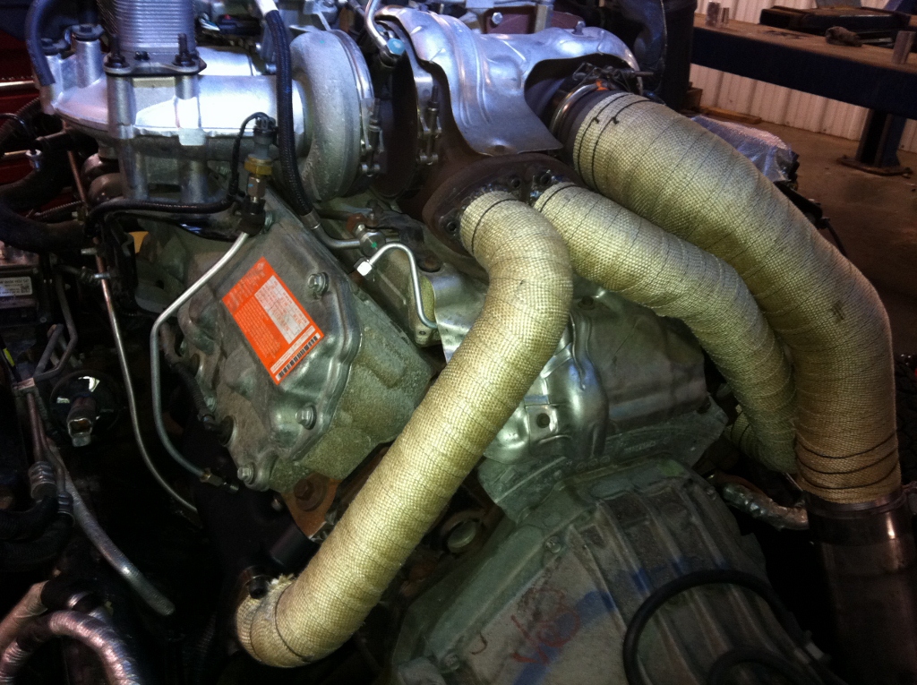

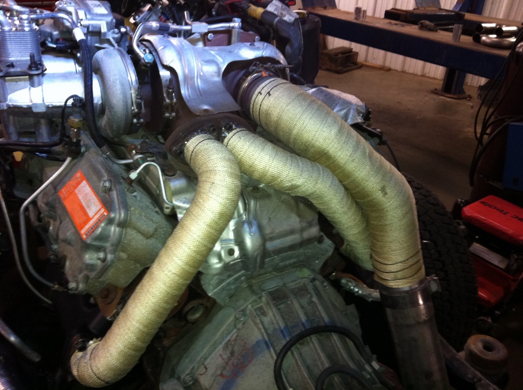

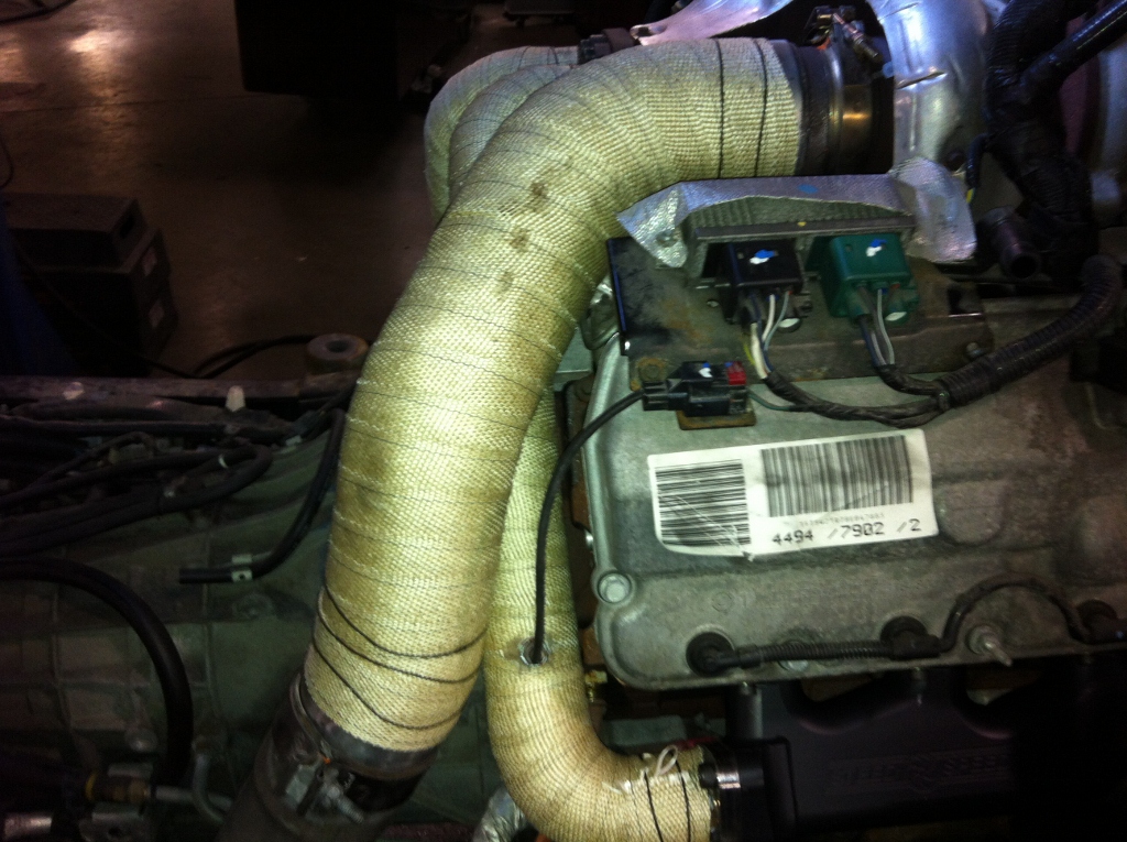

Finished install pictures

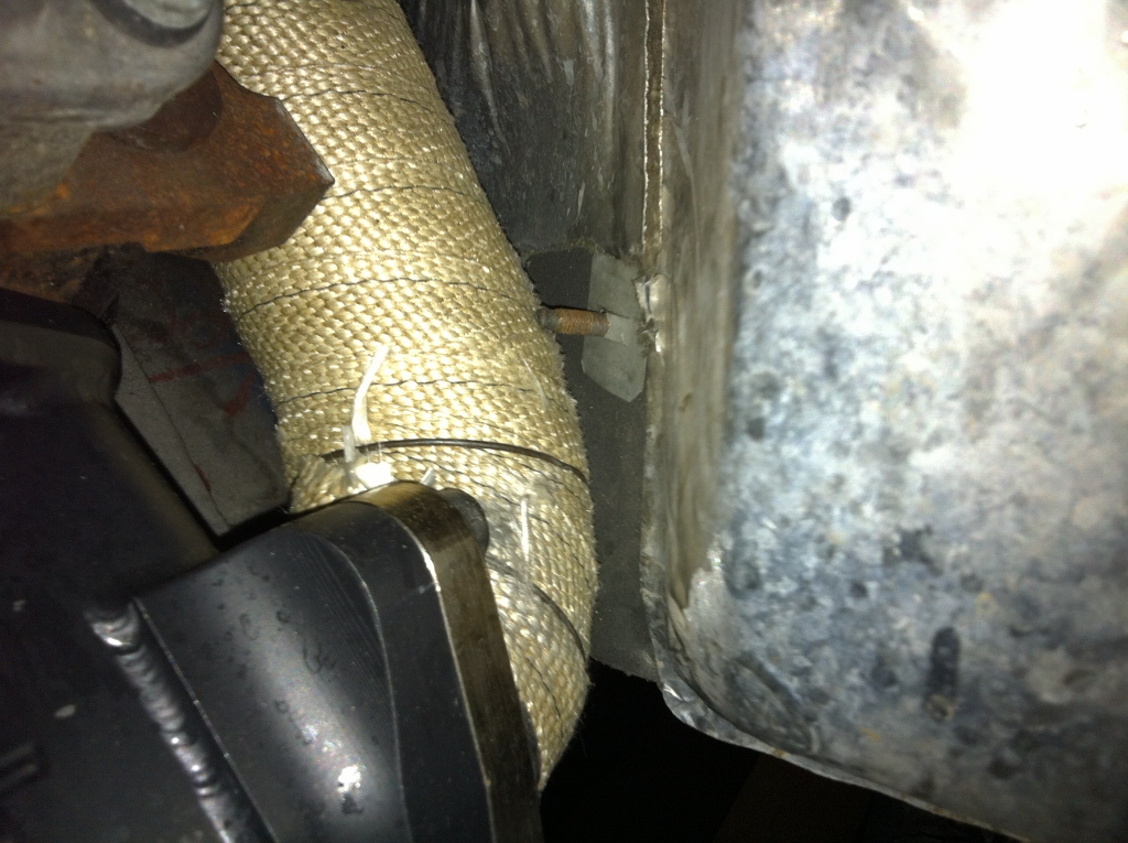

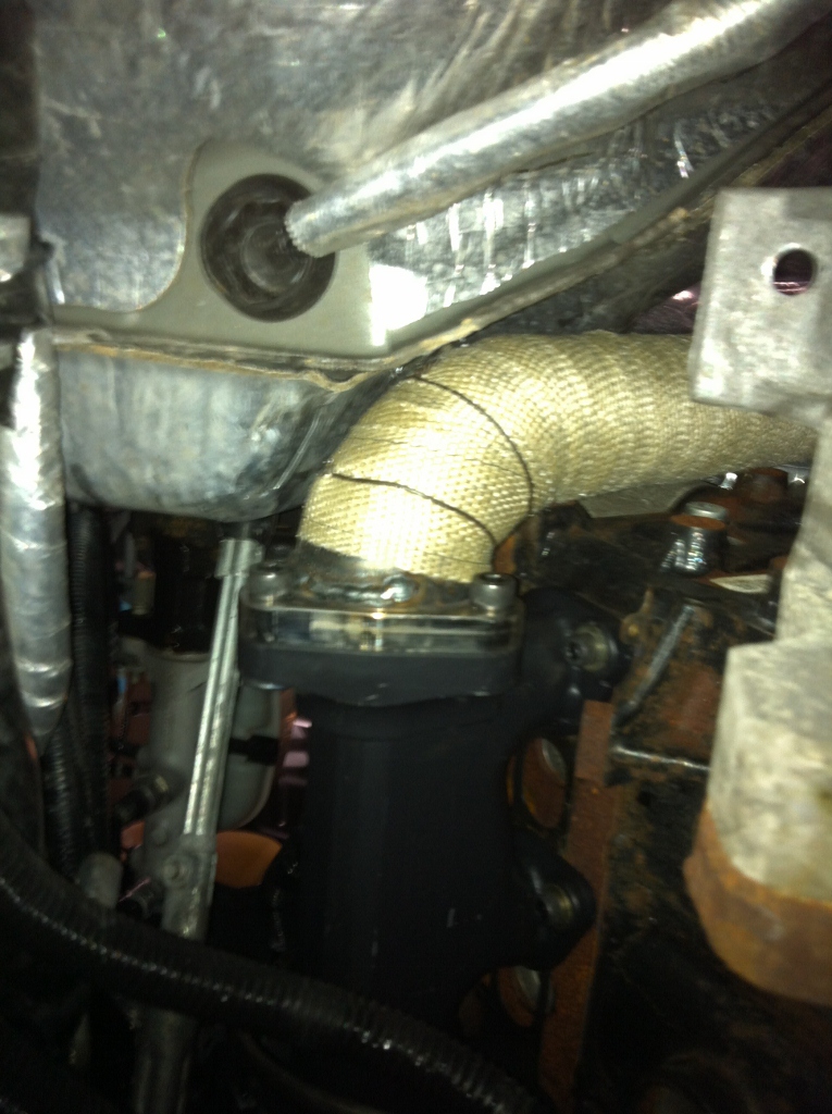

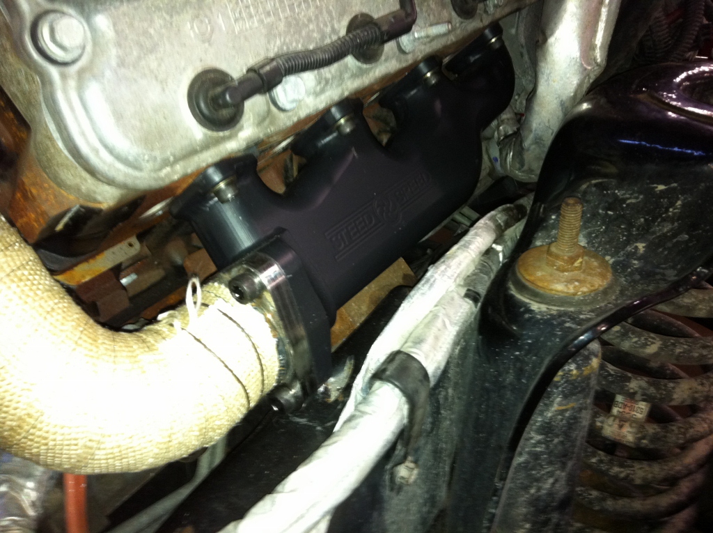

For those of you wondering about clearance
AND YES, I see the stud hitting the pipe!!!! Already taken care of!!!! Thanks for asking.
We will be submitting our final changes to get these into production right away. I'll let everyone know when we can expect delivery of them and once we get the final versions we'll knock out the final versions of the up pipes so they can be purchased with the manifolds. We don't know where price is going to land on pipes yet.
One thing is sure, based on our experience with these products they will be well worth it.
STAY TUNED later next week for the numbers!!!
