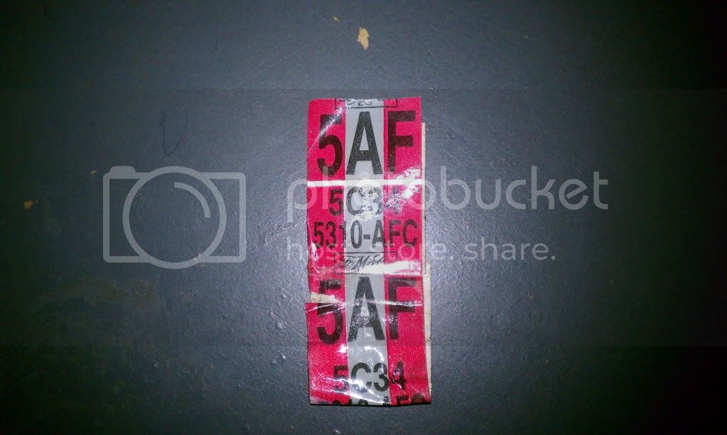

Sure, this number is straight from the parts tag off the spring.
5C34-5310-AFC

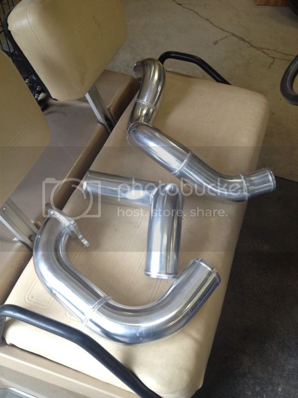

Right now the truck has tuner, AFE intake, and 4" straight pipe exhaust. I have an Absolute intake manifold with nitrous bars in it on the way (should be here next week), No Limit hot and cold pipes with intake elbow on the way, and also have a Dieselsite High output hpop.
