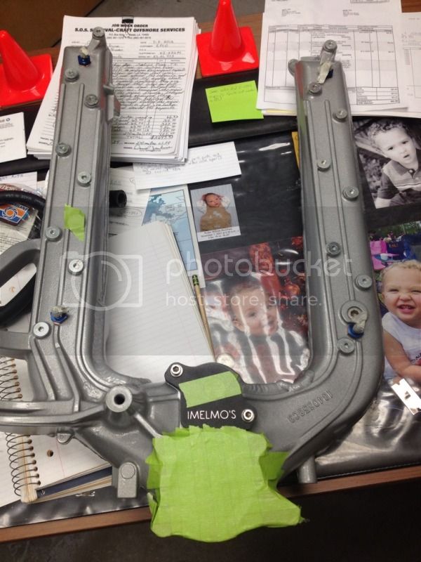

Got a new something from the brown truck today. :pimp: Thanx, Absolute! Looks awesome! Can't wait to get it on the truck! :D

Just thinking out loud here on how the Nitrous is hooked up, right now and I have a little concern with it.
As air flows from front of the manifold to the back you will fill the first 3 cylinders with Nitrous from the front spray bar. All the Nitrous from the back spray bar will be going directly into the rear or last cylinder causing a very lean condition possible damaging the motor.
Just my 2 cents.
