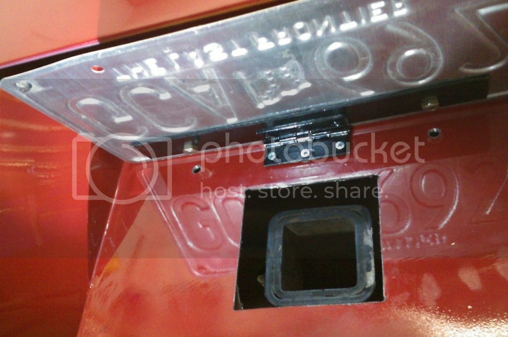

I had a bit of spare time after work, so I finished up my plate mount. I used a single hinge and some neodymium magnets to hold the plate in the open and closed position.
You can see the magnet glued to the bottom of the plate in this pic:
Then to hold it in the open position I glued two more to the plate bolt heads:
It actually works really well, and those little ***ers are strong!
