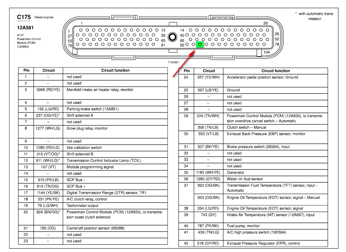

Rather than digging it out at first you could confirm you are getting power from the PCM. The connector to the PCM is engine side firewall drivers side. Its pin 94. Its a light blue wire with an orange tracer. Stick it with a probe with the key on ( 30 sec) and it should become a ground (you can test it off the battery neg post.) It believe it will be the passenger side of the connector when its plugged in 2 below the center bolt. That should get you in the area to find the right color. If that proves to much a PITA plugged in remove the PCM from inside the cab and plug it back in to the connector in the engine bay. Then you can easily find the pin/wire location.
Here is a diagram of the connector with it unplugged facing you:
One possible way if you want to test the entire ground circuit but the fuse keeps blowing and its a switched ground so not a completed circuit without the pcm flipping the relay on. Again I am tired as crap right now so I may not have this right on testing the ground circuit but here:
Unplug the connectors from the pump. Put in a new fuse and turn the key on. (You will only have 30 seconds before the PCM opens the relay connection again.) Have the multimeter resistance/ohm, one lead to the ground terminal in the connector and the other lead to the battery negative post. Should read infinity or 0 or under 1 ohm depending how you are testing it. I THINK that would work.
