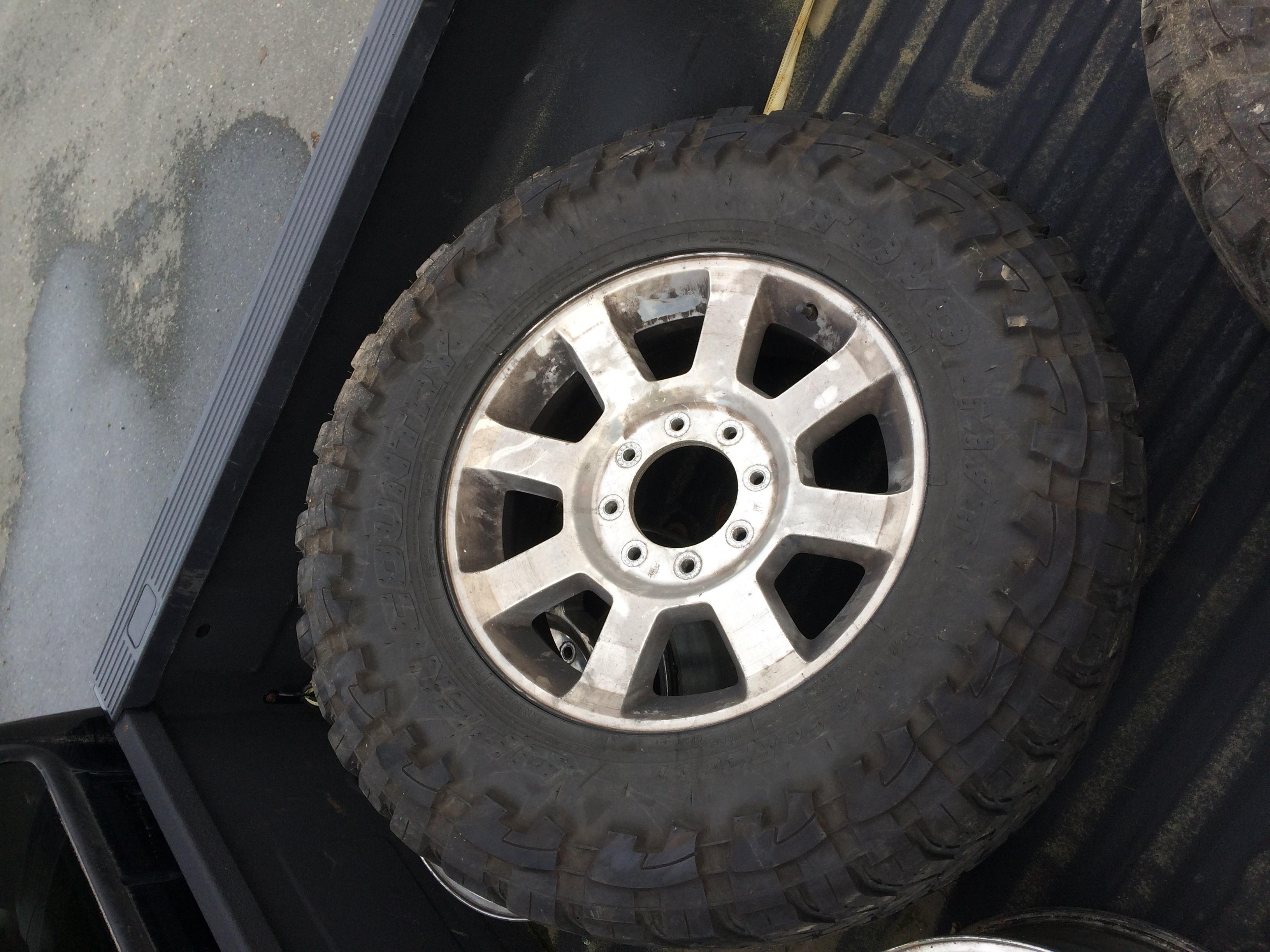

got this 08 for $500cdn
its pretty tempting to put the '01 2wdr work truck on this roller as it is the same eclb
the wheels cost me $400
the pricing for bling parts is weird to me when hard parts are so cheap

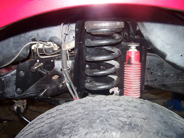

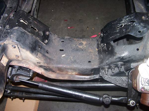

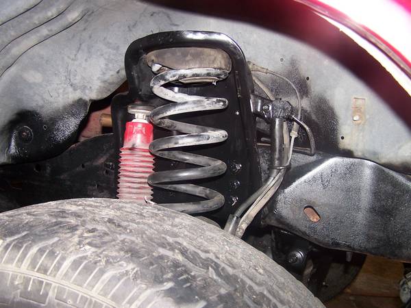

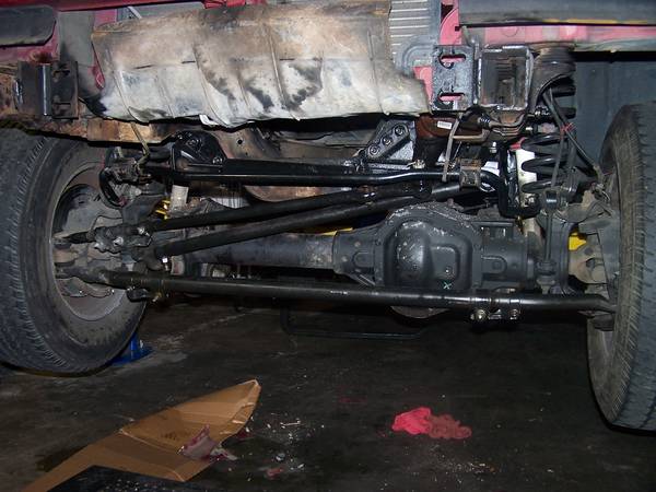

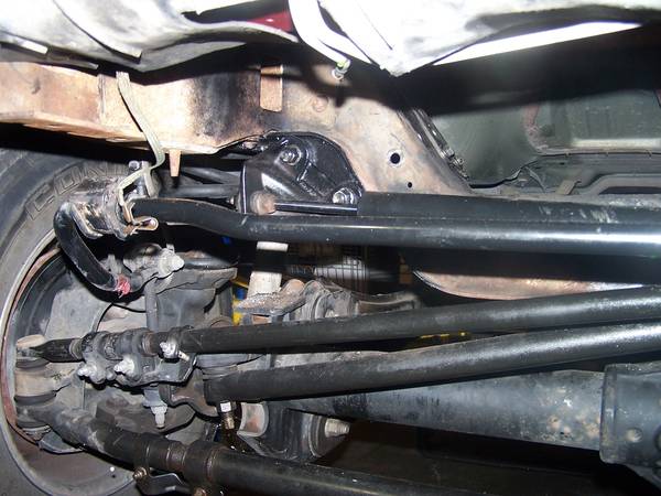

Here are the pics of mine using all factory 05 suspension as well as steering components including the 05 steering gear box and stabilizer, figure it is easier if they are all in one thread.

why the love for the 05 steering box? link to info please
Simplicity, anything I need suspension/steering replacement wise I simply buy for an 05, no special parts or work needed.
Also IF someone wanted to do a suspension lift later just buy for 05 truck and ALL parts bolt on.

I'm starting this swap myself. All parts collected and everything sold and torn out of my truck. I've got a pretty good handle on where to mount the radius arm brackets, track bracket etc. The missing info is on the coil buckets. Everyone seems to gloss over this in their threads. Anyone have any better pics or process for mounting? I've seen some people slightly notch for the cross-member rivet and just place it there. Anyone have any measurements that worked out nicely. I want to do it once, do it right and not re-invent what someone has already figured out.
Maybe when I get the coil buckets torched off the 2005 and set them up against my frame it will be obvious...
Once you have the radius arm brackets attached it's a piece of cake to mount up the coil buckets. Just attach the radius arms and as you lower the frame down on the coils align the buckets against the frame. Passenger side will but up right against a rivet in front of it. Driver side will require a small notch to be cut out of the front. I can get some pics of a truck I'm doing in a few
Awesome. If you've got some pics it would be helpful. But that all makes sense. Simple and easy. Every seems to gloss over this in their swaps. I figured it would probably be straight forward once everything was in place. I planned on placing the radius arm brackets first anyway.
