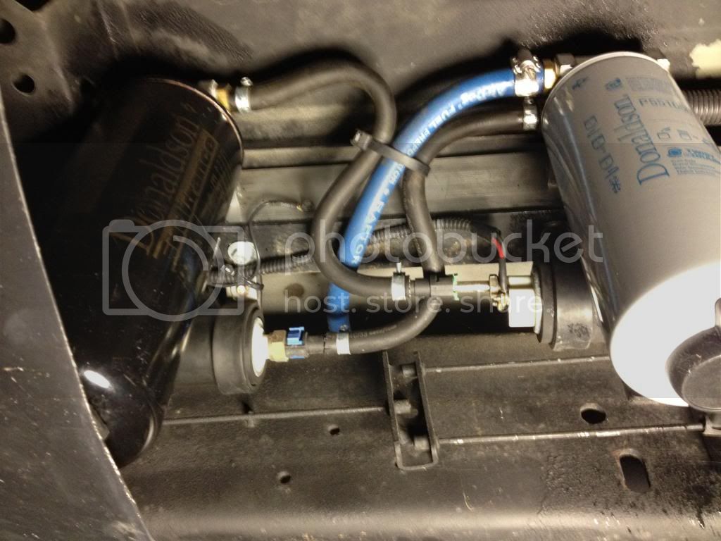

Heres how I did mine.
Bad pic and lines have been re done.
And no Im not running a raptor lol.
Left over line from old s***
KBMKVIII
Apr 9, 2012
1,483
31
Texas
The filter bases have two input two output each.
Some of the lines are hidden.
Blue line from sump.
Two out from the water separator/pre filter.
Then each pump has its own feed from there.
Two inputs from the pumps to the final filter.
One line to the motor.
Like I said bad pic haha.
Pre filter has one input plugged.
Post has one output plugged.
