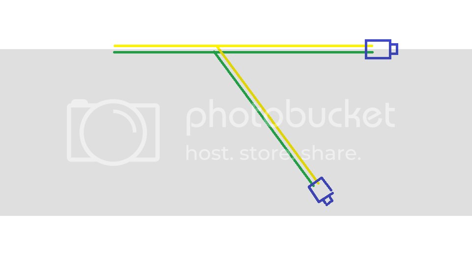

As far as IPR harness. I wish I would have took a picture after i did it..
Lat me see if I can "make" a picture for you... Not sure what youmean by series?? do you mean same wire to same wire???

Basically you spliced the second IPR connector in line with the other, so it makes one big loop?
No That is not what I did... From what you just said.. I did it wrong!!! That could be some of the trouble..
Here is how I did it..
Factory is horizontal. The added one is at a angle..
Same side of the conector to same side..
Pardon the painting... I am not a artist.. LOL

I changed my IPR wire harness to like it shows on the photo I linked to.. Still does the same thing. Shows 2800 plus when cranking allong with 14.4% IPR...
I will start and run, BUT after you shut it off it will not start back up.. I does just like it did in the video I made...
